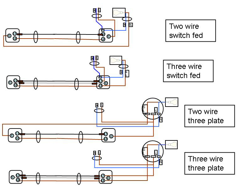

I drew these for two way lighting don't know of that helps.

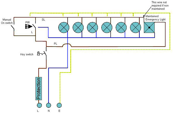

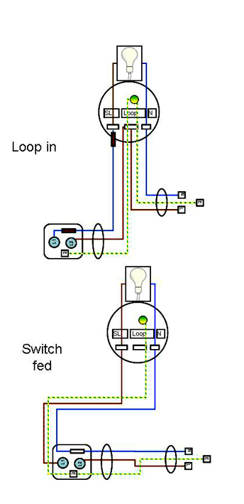

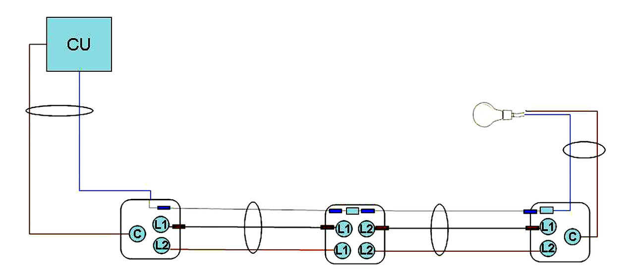

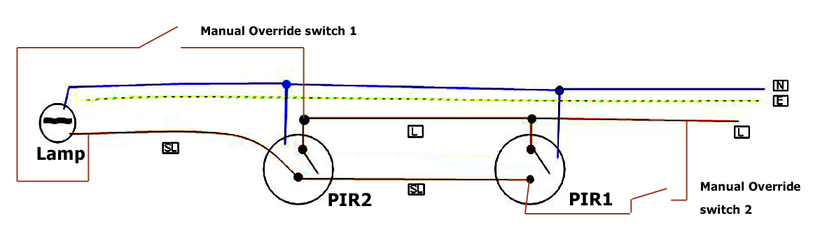

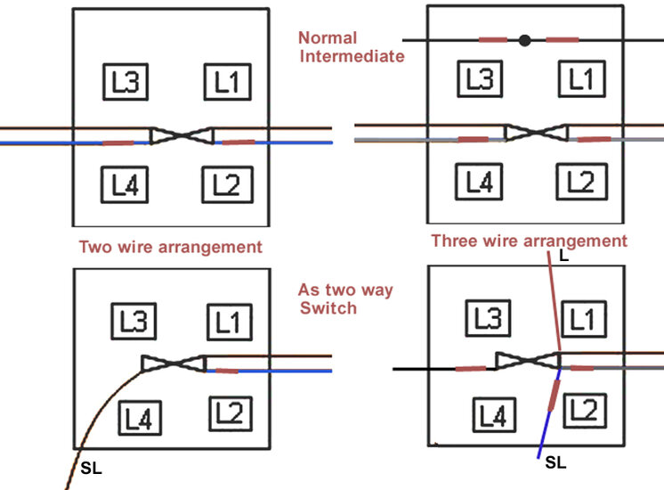

Just looking at some other diagrams I have drawn and thought I would add these if useful
