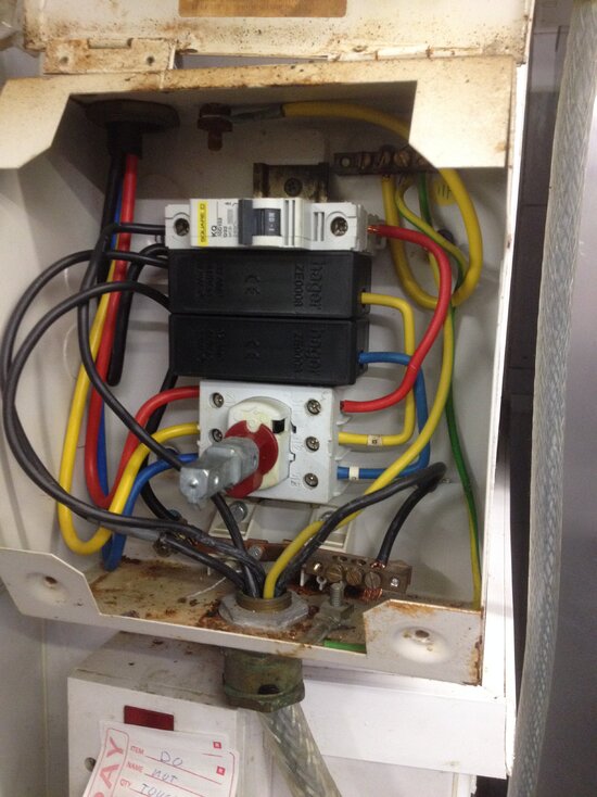

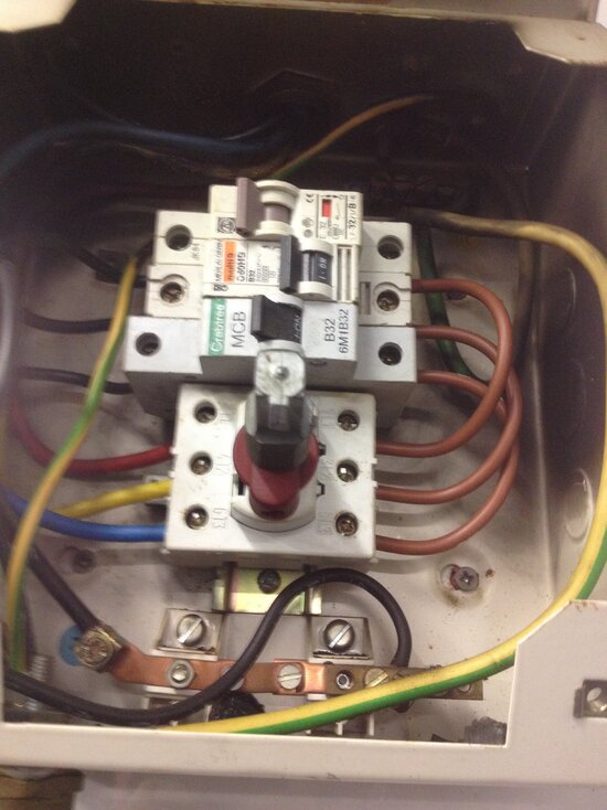

image.jpeg image.jpeg They feed 3 phase ovens
c3 for the mismatch of protective device brands
c3 for no ferrules on fine stranded SY in bars
c3 for excess copper showing in that mcb
c3 for the use of SY where greases and heat are present if not deteriorated (also whats been done with the braid)
just my opinion anyway

No code for the mixture of manufacturers’ equipment, as that requirement doesn’t come into force until January the 1st.
No code for lack of ferrules on fine stranded cables, as there is no requirement for ferrules in BS7671.
No code for using SY cable, as there is no prohibition against using SY cable in BS7671.
I am concerned that a ‘C’ type MCB has been installed.

There is a requirement to suitably treat fine stranded conductors in screw down terminals.
SY cable isn't heat or grease retardant so may not be suitable in a kitchen environment.
& we can work to the 18th now.
Shouldn't there be a code for the fact that the circuit breakers aren't linked?

526.9.1 Connection of multiwire, finewire and very finewire conductors
In order to avoid inappropriate separation or spreading of individual wires of multiwire, fine wire or very fine wire conductors, suitable terminals shall be used or the conductor ends shall be suitably treated.
It does not state “ferrules’.
A long standing practice for protecting such wires is to twist the exposed strands together and then fold them over.
Don’t know how you link a circuit breaker to old fuses

long standing practice it may be but in my book those methods do not prevent damage to the cores, either way it is clear in that picture no methods have been employed at all.
In that case the code would be for not treating the fine stranded wires in accordance with Regulation 526.9.1.

I hadn't noticed the hinges look nackard in the photo too, and also there's a window for the breakers? how well does that fit? that thing is basically f****'d in so many ways:D :p
What are the odds on that SY braiding not being Earthed?
Pretty good I reckon :rolleyes:
Does it require earthing?
It’s not an exposed-conductive part as it’s under the clear sheath.
It’s no use as a CPC.
I doubt it would function as an earthed metallic sheath if the cable were penetrated by a metallic object.

Hmmm, isn't a ferrule a terminal?
And, in BGB: BS7671:2008:Amd 1:
526.9.1 In order to avoid inappropriate separation or spreading of individual wires of multiwire, fine wire or
No a ferrule is used to treat the end of a conductor.
The terminal is the part with the screw.
In the case of MCBs, the terminals are designed so the screw part of the terminal does not make physical contact with the conductor.
The neutral bar however in the top picture has nothing to protect the conductor from the screw.
The reason the hinges are nackard is because there is a water pipe obstructing the opening of the lid and it has been forcibly opened in the passed.
