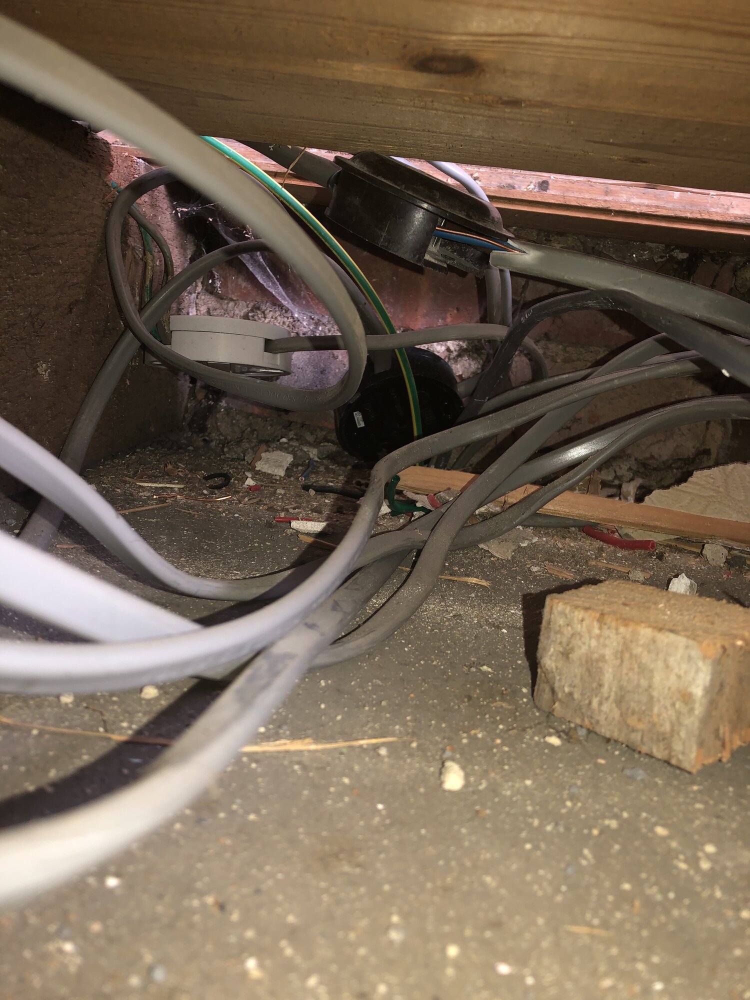

Just to add to your question, it may help it may not. I am one of the end terrace of a terrace of 7. We are all on a looped supply, 1 loop comes up my side wall splits to mine then feeds 2 other properties so 3 of the 7 from the incoming loop on my wall, then the remaining 4 in the terrace are looped together on a separate incoming loop on the end of the wall of the other end terrace the other side.
Its a rubber incoming cable with 2 cores. The earthing arrangement has always been like this.
I have also attached a photo of the setup before he came in and installed the new CU
On another note regards the loop, have a look at these pictures and see how dangerous this looks to you
View attachment 98922View attachment 98923View attachment 98924View attachment 98925
DANGER DANGER DANGER
Phone 105 NOW and state you have bare damaged supply cables.
Update.
I did ring the DNO, Northern Powergrid, I explained on the phone about the cables being bare, they asked me to email pictures (the exact ones I posted on here) within 45 minutes someone came out to look at them, within 2 hours of that, they (DNO) were digging up the garden and replacing it, So it has been replaced.
