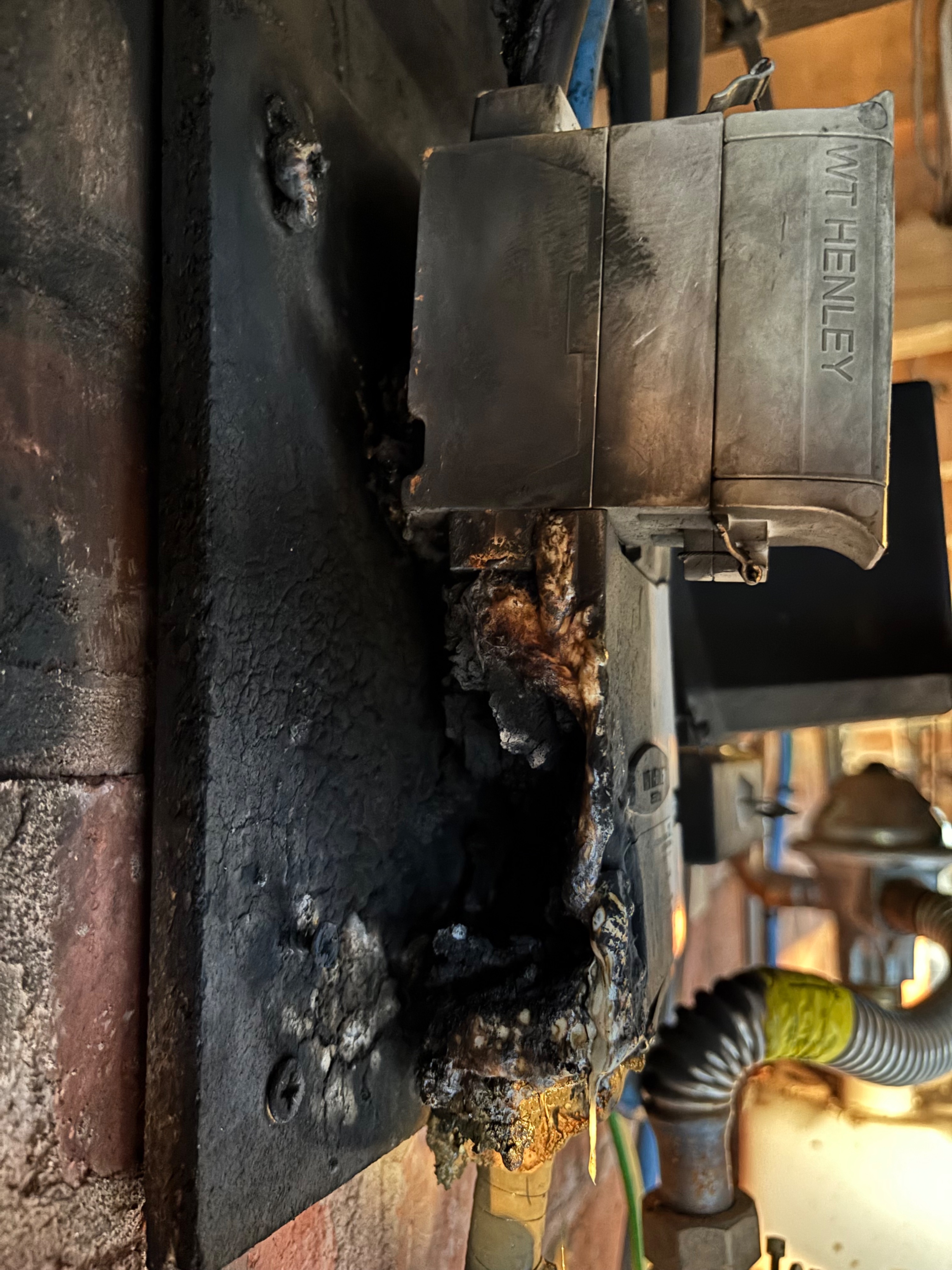

OK, so we’ve recently had solar with battery installed so all house electrics have recently been checked and certified. At the end-of our solar install we also had National Grid replace the cut so that everything was fully up to date and compliant with current regulations. 3 weeks later the new cut-out has caught fire and damaged our property.
Interestingly with having solar/battery we have app monitoring of our electrical system, so can demonstrate that there was and had been zero load on the system at the time of ignition.
We are currently progressing this with our insurance company - does any have advise if we should take further action…..and if so who with and how. Any advice helpful.

It would be odd to get much heating on a loose connection if there was little to no current flowing through the loose connection. That graph does seem to show 0 though. I wouldn't expect a brand new cutout to track over L to N either. Do you have a photo of the cutout?
There’s not a lot to show - there’s not a great deal left of it.!
Luckily I was able to put the fire out myself fairly quickly so damage to property isn’t extensive - still not happy that it happened in the first place tho and is costing a lot to repair.

It appears that the seat if the fire is within the cable chamber below the cutout and not actually in the cutout, in which case it is very much within the DNOs equipment.
Presumably you called the fire brigade and they have given their own report on this?

Old PILS cable insulation breakdown?
