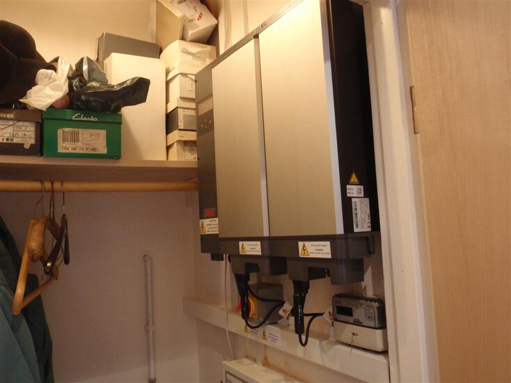

Do You have the 2010+ Master & Slave?
If so effectively you have 2 inverters, each with 2 Mppt.
When I used this setup on a 16 panles system before i had 8 panels on each string, and 1 string per inverter(1 on master, 1 on slave)
If i remember right you have to link both + inputs together if only using 1 string per inverter.
Make sure the AC is connected properly, its a right bugger on them inverters.
Heres a pic, ( Don't diss the connectors that can get knocked off, was a sub contractor job and they insisted on it!)
The +ve are linked together on both master and slave inverters
Thanks for the replys VMan. As you said it is a master and slave, it seems a bit of a faff on, which is not very clear in the tech manual. So i just put one string on each and put a link between the the positives only.

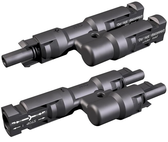

Just has a quick look at the datasheet, you have max 450V per inverter ( so 410 on the master and 410 on the slave) you will need 2 strings. (8 panels on each) once string on the master and one string on the slave with +ve(if i remember correctly) linked on both master and slave.
use the above to link +ve ( think its called a MC4 T splitter)
Think about the inverters as 2 separate inverters, each for 8 panels but sharing the same display & AC input (on the master) so the figures on the data sheet are for each inverter, i.e 450V Mppt for master and 450V mppt for slave also, same with current ect. This make sense??

Now it makes sense use the two tees to link the positives up. Brilliant mate, that helps me loads i need to get some splitters tomorrow i guess, since i have one to do then. Just as well i asked or i would be in the 5hite when it wont work.

But you don't need the splitters unless you are (a) putting more than 8A into each inverter (which you are not) or (b) need to use the two separate MPP trackers provided in each inverter. No harm done though, by sharing the current between the inputs you are reducing the stress a bit => maybe slightly cooler running, longer life.

When i was installing my first steca grid, i got onto there technical help and they said if you are not using both trackers on the inverter you must use a splitter, this is what i did and has worked since.
I hesitate to differ but their own manual says on p. 38 the following:
"On each StecaGrid there are 2 positive and 2 negative sockets in total for connection
of the modules. Each input has its own MPP tracker.
When only one input on the inverter is used the module string must be connected to the right-hand sockets (input 1).
Mixing up the positive inputs (e.g. + from string 1 to + input 2) within the same inverter will not affect the operationability of the inverter. This is will however also cause the inverter input numbers shown on the display to be the wrongway round. To prevent possible confusion when looking for a problem the correct connection to both inputs should therefore be made.
When PV modules with a current of more than 8 A are used, both inputs can be connected in parallel using a special T-splitter, also called Y-plug (not included in the standard package). This way, modules with a maximum (MPP) current of 16 A can be connected. A T-splitter is not necessary for a negative connection because both inputs are already internally connected in parallel. Just connecting either of the two inputs with the module string will suffice.​
