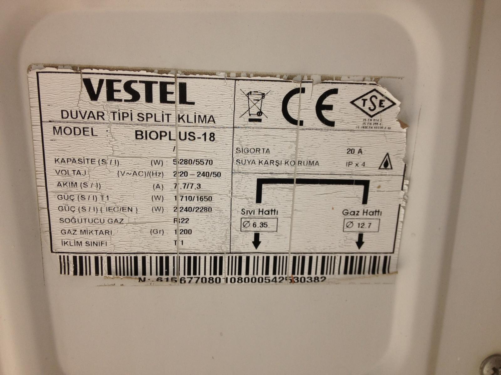

I want to first off state that I have zero experience when it comes to all things electrical. All I'm looking for here is just some advice. I'm not going to attempt to do anything myself.
I live in Turkey and we have just had a second air conditioning unit installed in our upstairs living room. The unit is a typical wall mounted AC unit and the motor is placed outside on our balcony. The guys who fit the unit were not able to wire it in (they wired all the pipes etc in though). We're looking for an electrician to wire the unit in properly. Living in Turkey for several years has taught me that there are no rules to pretty much anything here and most electricans/plumbers/builders etc. have little clue about what they're doing and create more problems than they solve. When we do eventually find a competent electrician I just want to make sure he's doing it correctly and not doing the typical short-cut job.
The AC unit we have is a Vestel Bioplus-18 model. I can't see to find the instruction manual online so I've taken a picture of the details printed on the side. The wording on the label reads as follows:

I'll start off by saying I have no idea about the Turkish wiring regulations or even if they use regulations? But I would have a good look online I'm sure there will be some British qualified sparks around somewhere who would be your best bet.
I googled it and all that came up was a Turkish site so it will be a Turkish made AC unit.
The unit consumes about 7.5 amps so you will need say a 15 amp rated supply and because the unit has motors you may need a circuit breaker that suits the start currents .

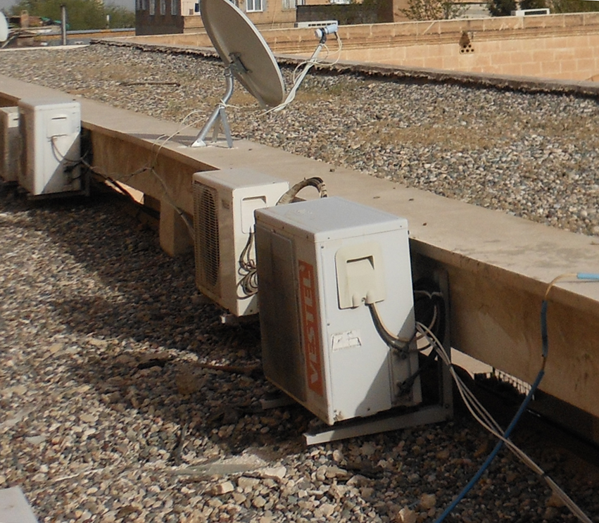

Well this is how I saw the air con wired when I was in Turkey, please do not do it like this!
Your A/C unit is what is known as a ''Split'' air conditioner. The main power normally goes to the controlling indoor FCU (fan coil unit) and then out to the external condensing unit. The usual solution for domestics in the Middle East, is to just plug them into the nearest 16A socket!! Even in Cyprus, most of the houses and flat's, 10 or more years old, just had them either connected via a 20A DP switch off the ring circuit or plugged into a ring socket. Now day's they run a separate circuit (16/20A) to all A/C units in new builds.
