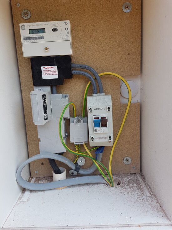

It's TNS, that's a split concentric cable coming in with the earth strands being brought out of the bottom of the cutout into a separate single pole Henley block (a genuine Henley series 7 one)
That Henley block MET will have been supplied by the DNO.
I've had a couple done exactly like this by SSE on service alterations where they have maintained the TNS service.
Reactions: sparkie141
You sure that's TNS ?????
Yes, that's a split concentric cable (much bigger than CNE cable) with the earth strands brought out of the bottom of the cutout.
On,y difference to way I've seen it done before is that they've added some g/y tape, I usually see it with bare copper strands.
