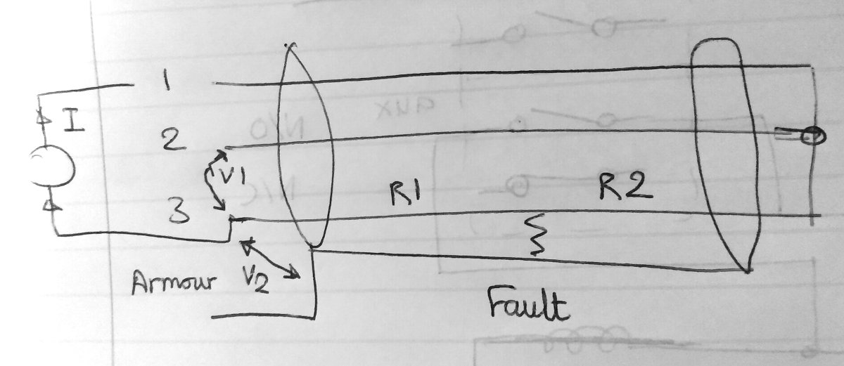

If I'm interpreting it correctly the voltage drop (across R1+R2) is measured between the two ends of the faulty cable and then between one end of the faulty cable and the armour (just R1), one of the healthy cables is just being utilized as a 25 meter M.meter lead for the first reading. Not quite sure about the right calcs but assuming that the fault is say only 5 meters from the joined ends then the volt drop across RI might be V1x20/25. Would love to see actual test readings from this method.

Most of the methods are doing this - establishing the resistance either side of the fault to armour. The different methods really come down to available test equipment, etc, and some minor variations in accuracy for a given assumption of test equipment, simil;arity of available 2nd conductors, etc.
One method mentioned that is not doing that is time-domain reflectometry (TDR) where a pulse is sent down the cable and where it encounters a change of characteristic some of it is reflected back. By measuring the time taken for this first reflection (you get another large one when the pulse reaches the far end) you can estimate the distance to the fault either directly (using the known velocity factor for the insulation) or by ration (from known length and far-end delay).
This is commonly used in RF systems but often indirectly (not a pulse, but maths performed on a swept-frequency reflection measurement), and in fibre optics using a laser pulse. Whereas in power systems they originally used the closing and then fault-triggered reopening of the supply breaker to generate the surge, though probably these days it is a safer low energy plust that is used!

I'd probably cheat and use AC, having checked what error the cable inductance is likely to cause (top of head it's very small.) Wrap a couple of turns of 16mm through any hollow-centre toroidal transformer to make a secondary and wind it up on a variac, or ballast the primary with a suitable lamp. Any decent pot to make a bridge, use multimeter to find the null then read off the pot resistance ratio out of circuit.
Of course it would be better to fetch the bridge test set but that's far away in deep storage.

Yeah, that one does the Varley test. Don't know if yours still has this plate on it (from an ebay picture):
From what I gather, when in Bridge mode it measures resistance between EARTH and LINE, you crank the handle and adjust the ratio and the 4 digit values - I think the needle at infinity position shows you have it right. (I'm not sure how it indicates higher or lower, other models use a galvanometer and the needle moves both ways to show.) Then repeat with Varley position which measures between Earth and Varley terminals and do the maths shown.

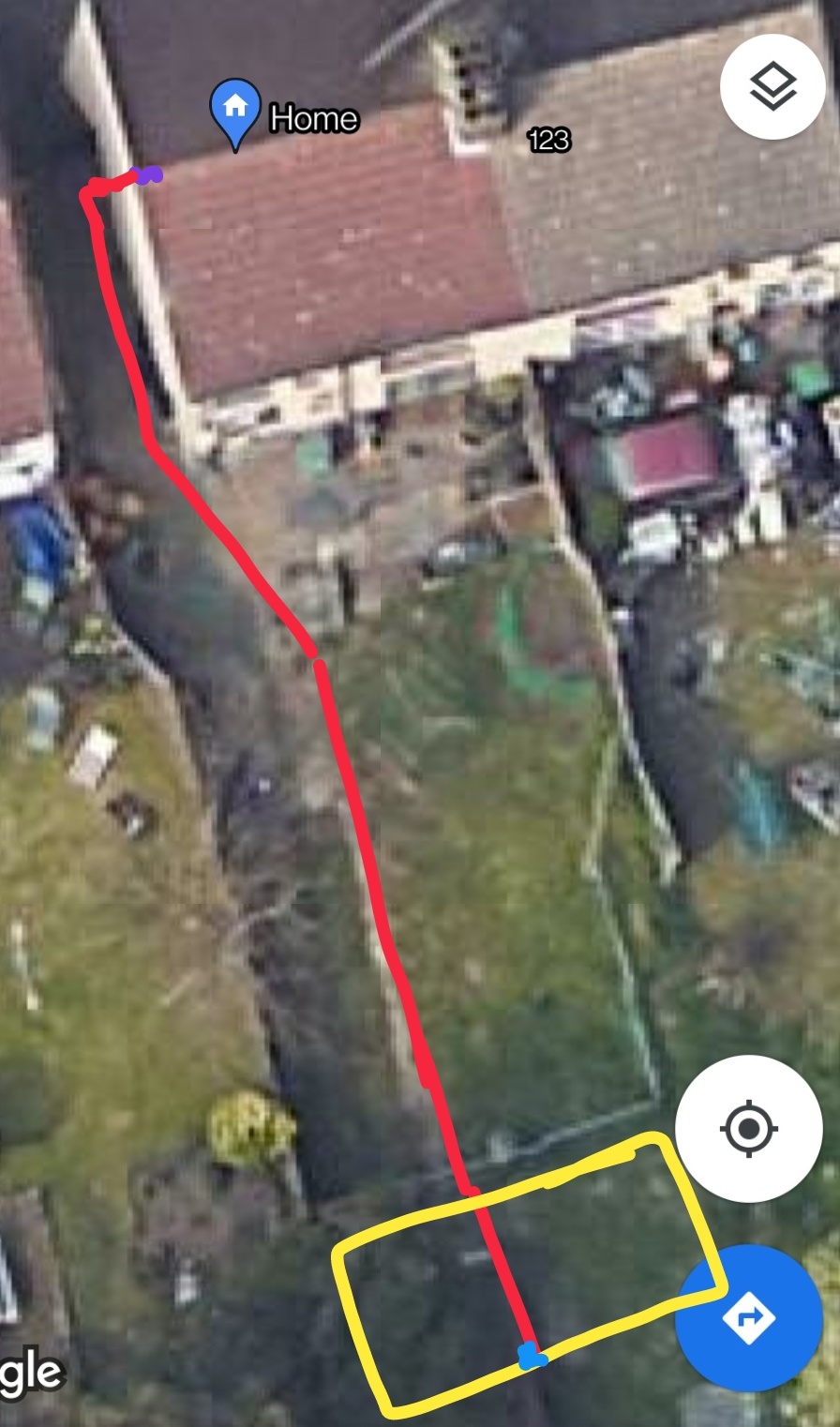

Hi all,
My first post here, thought I'd see if it was possible to get some advice or tips...
Basically, I had a large amount of block paving and large concrete base laid at the far end (25m) of my garden a few months ago. Under this I had 3 core 16mm SWA laid.
(I most definitely can't vouch for the quality of the work done by any of these guys)
More recently me and my brother built a large garage on the concrete base and had an electrician add a new CU in the garage and connect the other end of the SWA to an MCB in the CU in the house.
Today, after about 2 weeks of not having any problems, the RCD in the house tripped out and wouldn't switch back on unless I turned off the MCB to the garage. It's worth noting, it rained fairly heavily last night.
After trying a few different things, I've eventually disconnected the SWA from the CUs at both ends.
I've tested for continuity across all cable/ armour combinations and noticed there's continuity (beeping) when I touch the live and armour.
Is my assumption that someone has damaged the cable, breaking the live wire insulation and water has entered this and created a circuit between the live and the armour a reasonable one? Are there any other ways this continuity could occur given both ends are now fully disconnected?
Assuming this assumption is correct, I'm curious if there's a simple way for me to locate this fault without digging up 30m of block paving?
For example, I was wondering if, by using a multimeter and testing the resistance across the live and armour at both ends I might be able to work out how far down the wire the break is?
So maybe if I got a resistance 10 times higher at one end than the other I can assume the damage to the 25m long cable is 10% (2.5m) from the end of the cable with lower reading?
I guess I don't need to be super accurate and that there are industrial tools that could accurately locate the fault, all I really want to know is roughly were to start digging in the hope of keeping the damage to the paving to a minimum.
Thanks in advance for any help or suggestions.
Dan
