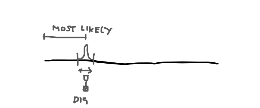

If I'm interpreting it correctly the voltage drop (across R1+R2) is measured between the two ends of the faulty cable and then between one end of the faulty cable and the armour (just R1), one of the healthy cables is just being utilized as a 25 meter M.meter lead for the first reading. Not quite sure about the right calcs but assuming that the fault is say only 5 meters from the joined ends then the volt drop across RI might be V1x20/25. Would love to see actual test readings from this method.

Most of the methods are doing this - establishing the resistance either side of the fault to armour. The different methods really come down to available test equipment, etc, and some minor variations in accuracy for a given assumption of test equipment, simil;arity of available 2nd conductors, etc.
One method mentioned that is not doing that is time-domain reflectometry (TDR) where a pulse is sent down the cable and where it encounters a change of characteristic some of it is reflected back. By measuring the time taken for this first reflection (you get another large one when the pulse reaches the far end) you can estimate the distance to the fault either directly (using the known velocity factor for the insulation) or by ration (from known length and far-end delay).
This is commonly used in RF systems but often indirectly (not a pulse, but maths performed on a swept-frequency reflection measurement), and in fibre optics using a laser pulse. Whereas in power systems they originally used the closing and then fault-triggered reopening of the supply breaker to generate the surge, though probably these days it is a safer low energy plust that is used!

I do not have a long length of swa with which to do a realistic demo using a high current. How about me sending you my test rig - the parts for which are on order and due today - and then you use it on your defective length of swa cable and see how it performs in practice? You can keep it afterwards.
What is the csa and length of your cable?
Yes I would be interested in playing with your bits! The CSA is 25mm2 length ~40M. Someone with some modern test gear was going to take a look last week but couldnt make it. I ended up retesting the 2 undamaged cores at 2500V today to prove they were still ok, got greater than 2500Mohm in all directions once I had cleaned the exposed insulation in the cabinet outside, as needed to get a reduced supply back on feeding half of the lighting. The fault is between yellow and red phases and armour today it measures around 100ohms on a continuity test. The 2 damaged cores are now extra cpcs. As most of the cable route is now built on it is likely a new route will have to be dug soon. A ground working company are looking in next week.
I will start to assemble the test rig tomorrow afternoon. I assume you have some jump leads to connect a 12 V battery to my board and a digital voltmeter able to read 12V dc. As the cable is 25mm2 I will arrange to produce some pulses of current of the order 70 to 80 Amps so that a volt drop of a few volts is produced along the red or yellow conductor. I am using twenty or so 12V 50W halogen lamps as my power resistors so you will need to wear some sunglasses when it pulses the current!
Good. One last question - what is the settling time of your dvm? Ie, if you measure the terminal voltage of one of the 12V batteries how many seconds from making contact before the digital readout remains constant?

This test rig is a demonstrator not some finished item of test equipment so its construction is economic using many items just gathering dust in my man shed.
The interesting aspect of this project for me is not so much the method which is long established it is actually doing it practically. The hardest part of it is finding a cheap way to load up a 12V battery to cause a current of the order of 75 Amps to flow without everything bursting into flames or becoming a molten mess. In other words the power resistors. Hence my use of 12V 50W g6 halogens. The nice thing about these is that once lit their current is quickly constant during the test unlike using other resistors - and cheap.
Nevertheless, there will be 18 x 50W halogens lit producing mostly heat and some light - nearly a kW. You can see from the image I posted that I used cheap connector blocks - I could not find online a way of buying a score of g6 lampholder with leads without spending a small fortune. So I improvised. But by only having them on for a few seconds and then ensuring an interval of at least a minute before they next light I intend to ensure this does not happen.
I have some electronic components to mix together to produce a circuit which will pulse a current through the cable, alternate the dvm between the near and far end of the cable and have a limitation on the minimum interval between pulses of current - I have in mind 60 seconds and 5 seconds for freddo to take the two readings. He will press a button and then one pulse of current will occur to take the voltage measurements; then a wait of 60 seconds before another pulse can happen.
In an experiment it is normal practice to repeat measurements in order to deal with the inevitable errors and noise present. If it was me I would repeat the testing ten times to see if the results were consistent.
