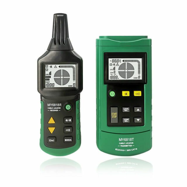

In terms of finding the cable route - I've had very good success with this relatively inexpensive tool:
I had a silly situation once where I had to prove to the DNO that a bungalow wasn't fed from a substation on the private estate. Using one of those I traced the supply cable underground, under a boundary wall and to the middle of a road using one of those. I could even pick up the signal at the nearest neighbours cut-out, proving they were on the same phase.
You'd need one core connected to live, and the tool connected to that core and the earth stake it comes with.
