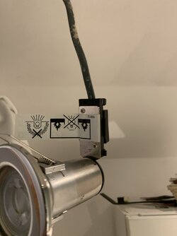

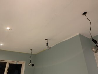

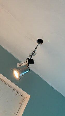

I took it upon myself to install 6 LED spotlights in my mums kitchen before the arrival of the new units and whilst I had great success at the beginning, I’m afraid that was short lived as the other row of three did not work like the other three did once the electric came back on.
The first row of three against the back wall worked fine and I feel like I understand the workings of them pretty well.
However the other wall did not work at all. I installed the one nearest to the window first and I assumed it might be running in series and that I might have got the final one in the chain as it had two sets of wires coming through the cut out so I proceeded with the other two and hoped this would complete the circuit.. it did not.

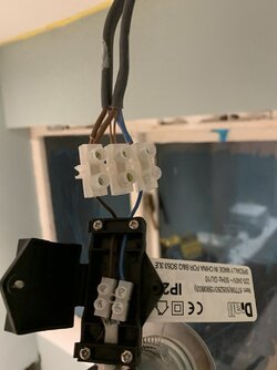

example of the the double roof wire cores wired like I did the opposite row.
I also used a signal tracer to make sure the light switch was linked to the non working row and indeed it was, just the same as the working ones.
Please note I did not do the initial cut out’s or wiring, this what was left of the previous owner.
any help would be greatly appreciated!
The method for which those lights are connected is dangerous and non compliant. Whilst you may feel you are helping your mother what you are actually doing is placing her at risk from an electrical fire. Seek the services of an electrician to rectify what you have done for your mother's safety.
Hi there,
thank you for your input and I really do appreciate your concern, I’ve took your advice and disconnected what was there But could you possibly explain why just so I have a better understanding for future reference.
thank you advance!
All connections must be suitably enclosed, that is the biggest issue. Poor connections which is what you are likely to have along with being unenclosed is a serious issue and a fire hazard. You have done the right thing by stopping what you are doing.
