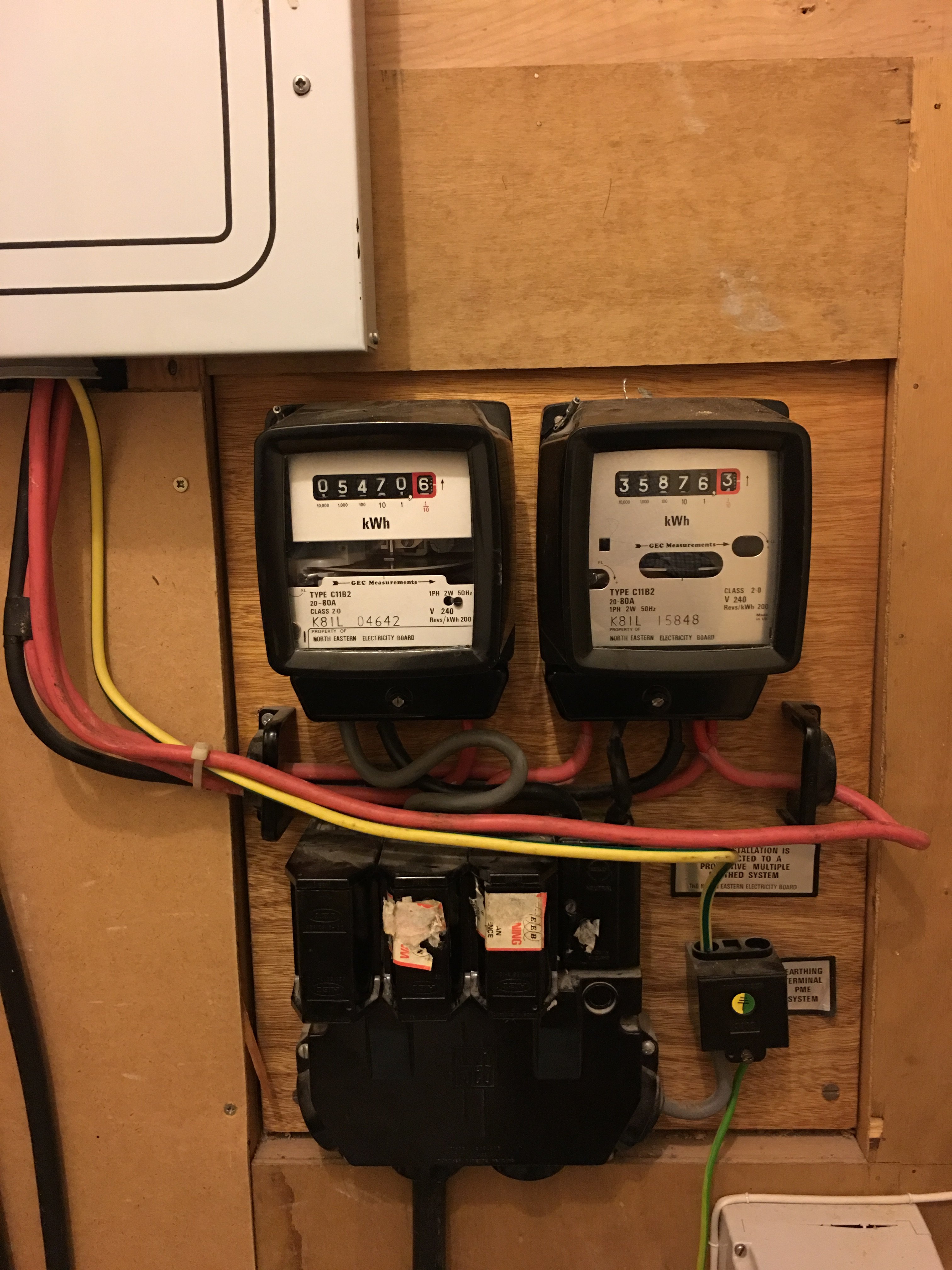

Hello, I've got a question that I thought I throw out to the crowd and see what comes back... I am a little stuck with a recent EICR that followed a change of occupier.
The home is 30 ish years old and has been extended several times. It is a fairly large home with swimming pool, multiple outbuildings and annexes.
The main DB is where I am struggling a little.
The supply is single phase fed from two meters. It enters the DB via 25mm2 tails two from one meter. One from the other meter. At a glance it looks like a 3 phase supply... there is a 125A main switch to the DB and there is a single neutral. It is a three phase DC with colours marking out where you would normally expect to find L1, L2 and L3.
The issue I am having is that the single neutral is carrying the entire current from both supplies and so too is the meter it is connected to. One meter has no neutral connection to the DB.
The meter (I think) is rated to 80 amps... but the full load is passing through it.
The tails (meter to DB) are short so I am less concerned about the neutral being overloaded.
The main switch on the DB is rated 125A so should be fine but I imagine the rating is for a reasonably well balanced 3 load across all 3 phases. It isn't. No current is flowing between phases so everything must be going down neutral.
For clarity the main DB is the only source of distribution to the whole building. There are a further 5 sub DB's fed off this one board. The board is near full to capacity at 0.4 diversity.
So my question is this.... any harm in the neutral from one meter handling this load? What about the main switch? Are there any regs transgressions in this? I've never encountered this particular set-up before.
Here is the full horror:
I think you'll find that the neutral connections on the meter are simply a big terminal block with a small connection for use by the voltage coil. The current coil which is connected in series with the two line terminals are what the rating applies to.
Are you sure there isn't 2 phases there? Cause that's what it looks like.
Also the main switch is rated at 125A per pole, it doesn't care if it's balanced load.
Yep - just a big terminal block for the neutral... but I assume the rating is still relevant. The insulation and terminal block are more than capable we can assume but it won't have been tested for this... therefore is it compliant?
@Rob - definitely not 2 phases. 240V across phase to neutral. 0V across "phases".
The 125A switch isn't a question of balance.... it is a question of how much is going through that neutral contact. If there is 65 Amps per "phase" then there is 130 Amps going via that single neutral pole.
In most 3 phase installations (for which this switch is intended) some current would be phase to phase and not 100% of the current via the neutral pole.
This installation is littered with C1's regardless of this little problem! Any other thoughts are most welcome... I really don't like the look of it. Most of the install is OK but I am not sure the use of the three phase CU was the best move. It would have been better if two CUs were installed each taking a supply from the meter. I'm sure that single neutral conductor taking the load of the three single phase conductors is less than optimal and I'm sure that neutral pole of the switch is over loaded.

3 phase DC?? Those meters are rated at 240 Volts
@Pete999 typo.... not sure if I was supposed to type 3 phase DB or CU... it just came out DC instead!
Here is what I meant...
It is a CU marked up for 3 phases with 4 pole isolation and feed arranged inside in the usual pattern of 3.
Someone has wired it up with 3 25mm2 tails all from the same phase.
That results in the neutral potentially being overloaded as it is carrying all the current and the phase conductors / main switch carry just a third each.
Since in an application where there is only a single phase all current flow phase to neutral. There is no phase to phase path (obviously).
From what I can see both meters are single phase, the right one appears to have two outgoing line conductors into one terminal. One neutral goes to the right meter which from where the board neutral is connected. The neutral for the left side meter goes direct to the service head, correct?
If it's two phases then the neutral current will not add, it will cancel in the same way as if it was three phase.
If both line conductors are coming from the same fuse then you are limited to 100A max and so it would be fine.

Bad picture but they appear to come from the middle and right side fuses.
Thanks all...
The supply is not multi-phase. It is single phase. Proven via meter measuring 0 volts across line conductors. and 240V to neutral / earth.
One meter has two line conductor tails from it and a single neutral
The other meter has a single line conductor and no neutral
The sum of all breakers in the DB is 543A
At 0.4 diversity we have 217.2A
So there is possibly 217.2A on that neutral conductor which is broken by a 125A main switch.
The BS1361 DNO fuse will offer some protection since there are two meters and thus just two fuses in play... so we could say that we are limited to 200A in theory... but the reality is that a BS 1361 100A fuse is going to take an eternity to disconnect a 110A load.
Sorry for the poor photo!
What do you think? The whole DB is a C1 due to it failing to meet IP2X I might as well C1 it for having an undersized switch.
C1 one for what!
You do realise a C1 is immediate danger present?
And why have you added all the mcbs up?
It's the potential loading you need to apply diversity to not adding all the breakers
C1 for having a penetration that a whole hand can fit in. DB is in a cupboard used by the family including children for school bags, coats and shoes.
If you look closely at the photo the tails are not nicely dressed and bare copper is visible in the line conductors on the DB side of the meters. The cover that should be over that is broken and again that wouldn't meet IP2X... although I'm not sure it has to but in this instance is absolutely must given it is a very real possibility that a metal zipper, bag buckle or wet coat could quite likely come into contact with it.
The install is not very nice in general. There are 4 circuits that are a mess. It fails to meet Zs to a DB. There is evidence of rodent damage to some cables, the swimming pool lights are full of water, there is thermal damage to a FCU, there is cable trucking missing for swimming pool plant room... I have something like 4 C1 and 12 C2/C3 out of 27 circuits.
Get your hole hand in where. What type of devices are in that Square D board.
@Ian1981 swimming pool pumps, sauna, spa air pump are high demand (for a residential install) and they are normally in use simultaneously. Then add in an electric hob, and oven and we are starting to pull close to 80amps.

What do you mean it fails to meet Zs at a DB.
@westward10 whole of hand can fit inside the Square D board. It is clearly a C1.
Board has 125A 4 pole switch.

Why not put a clamp meter on the tails (each one at different times) and see what load it's pulling?
I'm lazy with my demand calculations... but I suspect that the demand is higher than 125Amps. I can see 40 Amps in the swimming pool plant room. There are 2 kitchens and 3 american fridges. Air conditioning and a 16Amp inverter for motor drive in a workshop.
I here what you are saying and you maybe right.
Is there evidence of thermal damage anywhere, particularly the protective fuses supplying the installation, are they hot to touch ,including the main switch at the dist board?
@Ian1981 I have...
If I sum L1,L2 and L3 (which is actually all L1 because it is not 3 phase) then I arrive at around 28 Amps and that is a "quiescent" current... there was no one home. That is all just fridges and pool filtration.
I obviously can then see that 28Amps (all of it) on the neutral. Because the current is all flowing through that conductor.
So I can see the building demand being in excess of 125A and that is fine when you consider the line conductors and the 125A x 3 switching of the line conductors.... but there is a 125A switch in the neutral and it all goes through that one pole.

Fair enough you are the inspector.
Looks like they will require 2 or 3 phase
@Ian1981 No evidence of thermal damage. Main switch makes and breaks. No heat anywhere in and around the DB.
It has been installed like this for 20+ years.... but I don't want to be the one to EICR it as OK and then the smoke comes....
I would honestly do a load check with a clamp meter.
You could always advise that the installation may need upgrading in terms of loading but if it's been functioning for years as it is then it maybe adequate.
No heat damage anywhere especially the main switch and cut out fuse plus terminals may indicate that it's not being overloaded. just a thought pal
That will only give an instantaneous snapshot, it won't help with the point in question.
Measuring the maximum and average demand can only be done with a data logging meter over a period of time.
