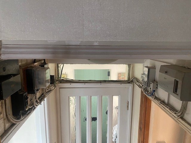

Your set up appears to be the same as tens of thousands of others across the country, so it shouldn’t come as a surprise to the meter installers
Would you mind posting a photo of all the equipment in your house? Meters, teleswitch and the fuse boards… just so we can check there’s nothing unusual about it.

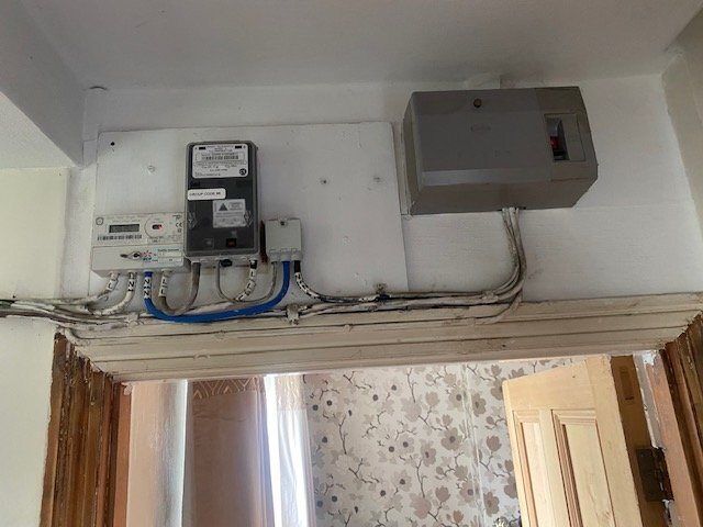

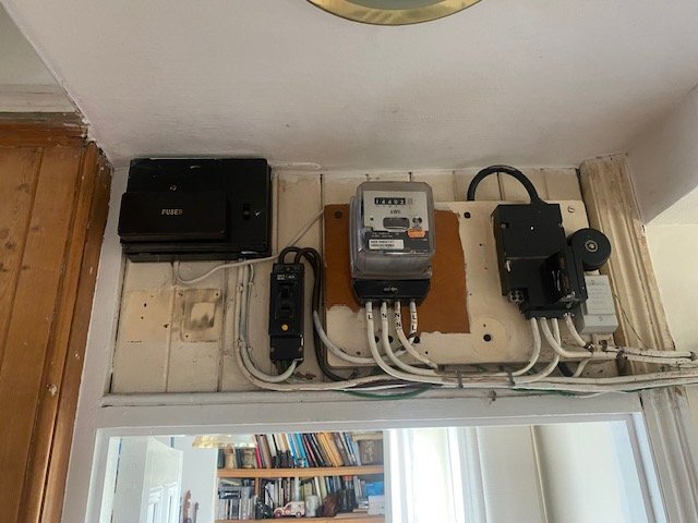

Hi. Thanks for the replies.
This is the set up.
Eventually I'd llike to get new consumer units installed.
EDF say they will fit an isolator at the same time.
I know that later Economy 7 installations only had one meter but this predates those. Both meters have been replaced within the last 20 years. I originally had a Horstman electromechanical time switch.

That installation needs some urgent work. Do I spy a voltage operated earth leakage detector? These were unreliable at the best of times and have been taken out of regulations for about the last 30 years.
That is in hand. Having the second meter and time switch removed will give me the opportunity to have the installation tidied up and brought up to spec.
Don
