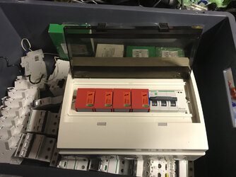

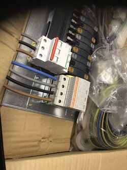

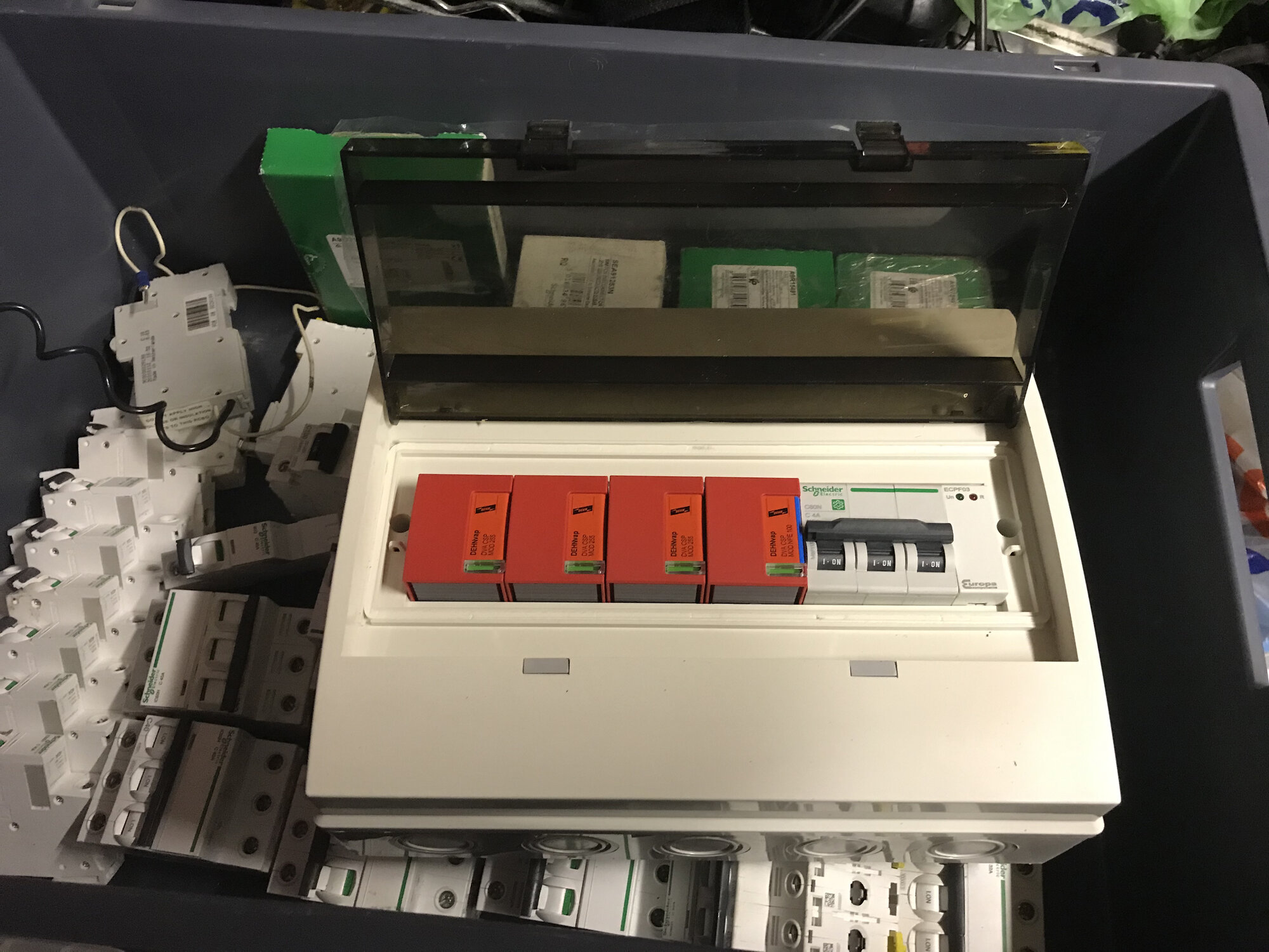

I fit these SPD’s in an enclosure along side the DB
if there is space under the cover of the DB I fit these.
