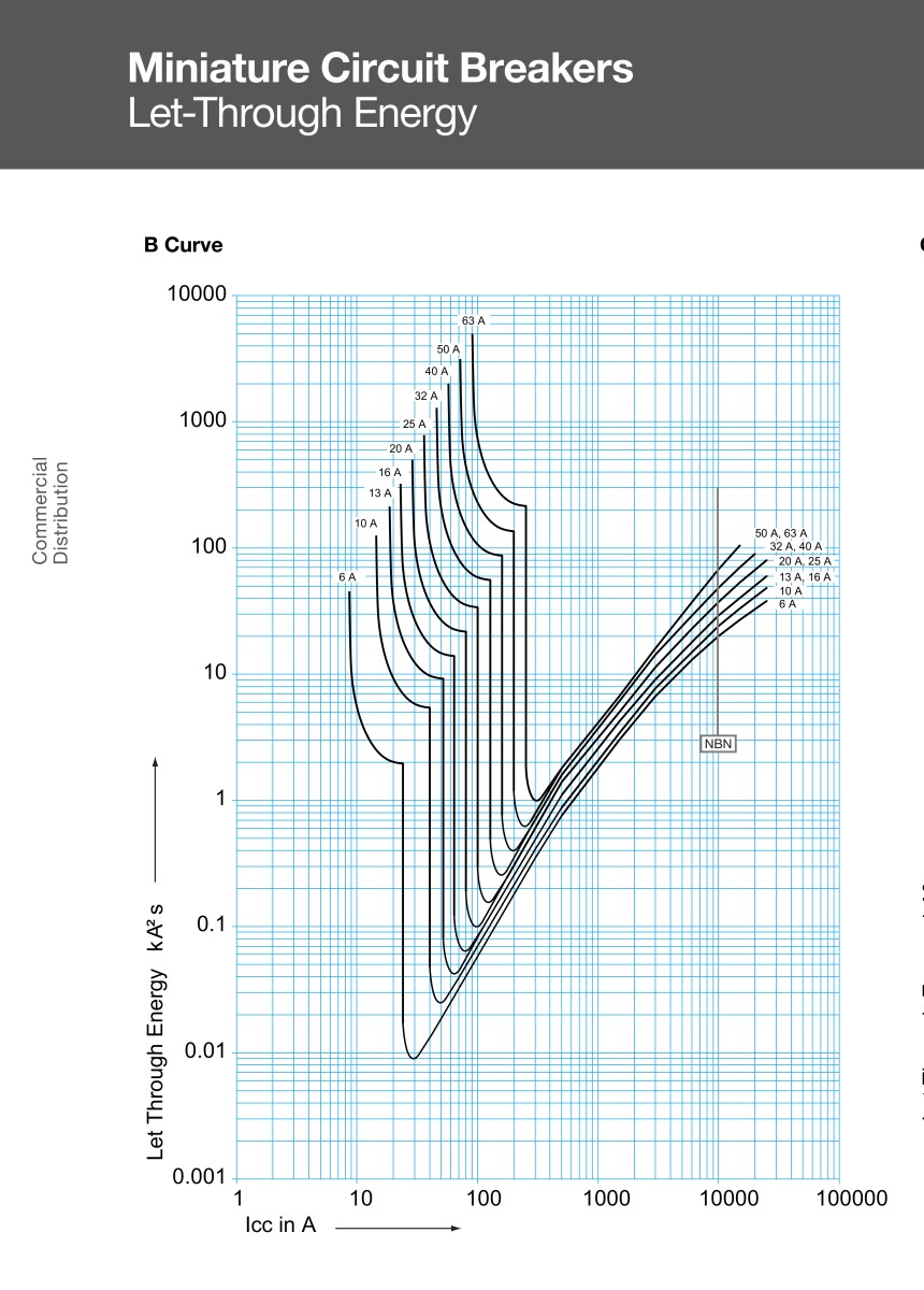

Need help check that my cable calculations are correct as still new to doing them.
6A Lighting Circuit 60898 MCB Type B wiring in 1MM²/1MM² T+E supplying a single 10W outdoor light
Length = 3.3M
Zs@db = 0.22
R1 + R2 mΩ/M = 36.20 mΩ/M - Table lt P218 OSG
Correction Factor - 1.2 - Table L3 P220 OSG
R1 + R2 = 3.3 x 36.20 x 1.2 / 1000 = 0.14Ω
Zs = 0.22 + 014 = 0.36Ω
Fault Current = 230 / 0.36 = 638A
Disconnection Time = 0.1s
K = 115
√ I²t / k = √ (638² x 0.1) / 115 = 1.75 Minimum CPC size.
Seems like I will have to make the circuit longer to increase the Zs value which seems ridiculous or change my cable for a larger CPC which also seem ridiculous for a single 10W light.
Can someone check I am doing my calcs right before I go down the rabbit hole of adapting!
Many thanks

Adiabatic's quite tricky to get the head around. You're on the right lines, but as you can see, you've come up with a larger CPC than expected. What is the circuit protective device?
Your calculations are correct and as accurate as you can achieve right now (see the note that @Pretty Mouth refers to in order to understand why)
A general comment, remember 543.1.1 - you can either calculate OR select.
In general for smaller size line conductors and shorter lengths it's better to select from table 54.7 which would give you a much more welcome answer!
In general for larger line conductors or longer cable lengths, it's better to calculate.
It's hard to get a realistic CSA using the data from BS7671. As you've seen the time only goes down to 0.1s, but real world a fault current like that would disconnect much quicker, giving much lower let through energy (I²t), therefore a smaller CSA.
We're concerned with the worst-case situation: for a B or C type breaker, that will be right at the start of the circuit, where the fault current is greatest. If the conductor can withstand a fault here, it can withstand it anywhere downstream.
Let's assume you went for a Wylex B6 .
Here's some data from Wylex:
You had 638A prospective fault current and a 6 amp breaker, so the multiple is x 106
That graph shows you that the disconnection time will be less than 0.01 seconds.
If you run you calculation again with 0.01 as the disconnection time you end up with a CPC of 0.55 sq mm!
You obviously need to round this up to something that actually exists, and then be mindful that it it's separate to the cable or buried there are minimum sizes that apply.
You are using T&E so that last bit isn't relevant.

@Pretty Mouth has it spot-on that you really need to get the manufacturer's data for breakers (MCB, RCBO or MCCB) as the usual current-time plots do not really give you a good idea of what happens once you enter the "instant" magnetic trip region. Some give you useful curves (like the Hager example) and others just give you a maximum value to base calculations on.
There are some generic limits that can be used as well, for example the On-Site Guide in Table B7 (page 146 of current 18th AM2 version), and usually any of the "standard circuits" in Table 7.1(ii) of the OSG are fine for domestic cases where you very rarely see above a couple of kA fault currents.
