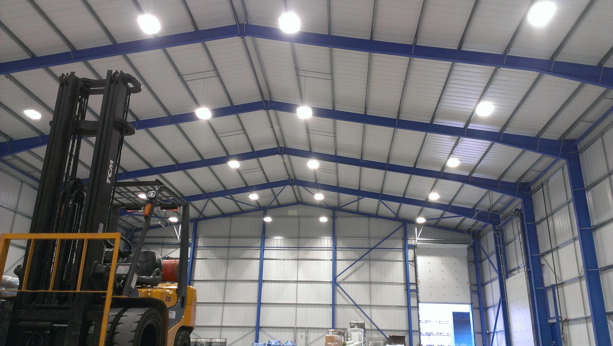

Hi anyone any recommendations for led lowbays also thinking what the inrush current would be ?
Not so long back I was involved in a warehouse lighting job installing led fittings from contrac lighting. They really ended up a good job. No appreciable inrush currents either.
We used Lando fittings, 21,000 lumen at about 12m and 16,000 lumen at mezzanine levels and in the main factory to replace 250W low bays. Good quality gear, the fittings we had were all Philips LED gear inside.
They came down and did a free design and specification in conjunction with the wholesaler. We used Yesss for the large job but have since found that a local independent can get them 20% cheaper, so it would be worth asking Contrac who they deal with in your area.
L.E.D at Contrac Lighting
A photo of the finished job

t thanks andy good info that
