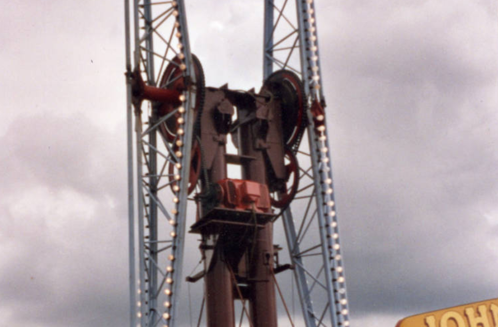

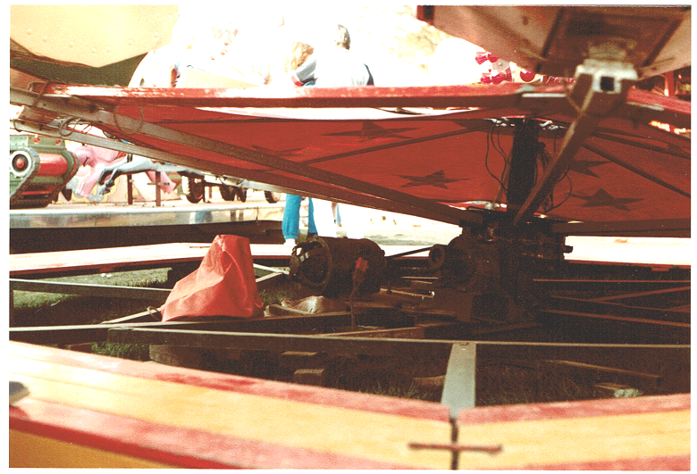

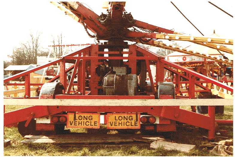

Before this post gets too wordy, let's have some pics of drive motors. Here you can see the main motors on an octopus, ferris wheel, dive bomber and speedway ark, and for comparison the small motor on a juvenile ride. In the next post we'll look at the speed controls themselves.

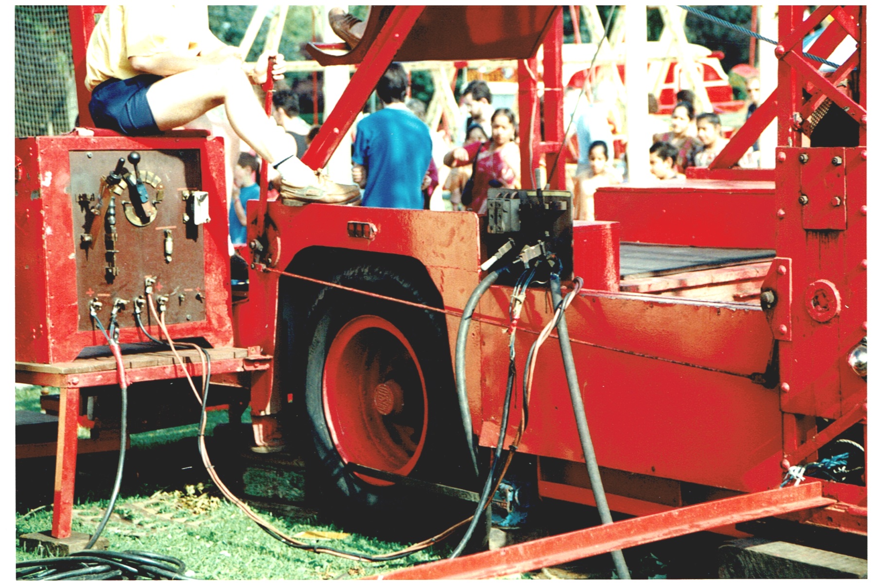

I mentioned putting resistance in series with the armature circuit and labelled it 'starting resistance' on the circuit in the previous post. In due course we will need to look in detail at how armature resistance works both as a soft-start and as a speed control. It will serve both functions quite well for most rides, e.g. a twist or chairoplanes can be perfectly well controlled with a resistance. But its shortcomings will start to show when we apply it to the huge, heavy speedway, and an exploration of those shortcomings will lead us to the origins of the Ward-Leonard system and the wonderful 'Scenic Showmans' locos.
At the very elementary level, we can consider that adding resistance to the armature circuit reduces the armature current and therefore the torque, making for a soft start. But how does it control speed? In the next post we will throw some equations at the problem but suffice to say for now, with many kinds of ride, the more resistance, the lower the speed, so we want a variable resistance that can be cut out in steps.
Take a look at these controllers and the circuit diagram. There is usually a cage with resistance elements not unlike spiral heating elements, on which is mounted a faceplate control with studs over which the wiper arm runs. Each stud to the right progressively cuts out the resistance section by section, with the final stud being all out. There is usually a knife switch to the left which serves as both the emergency stop and for inching the ride for loading, while the controller handle remains on whichever stud gives a suitable creeping acceleration for this.
BTW some of these pics are from memorable days out. Resistance Controller 1, for example, is Michael Miller's 12-car big wheel by Eli Bridge (NFCA index BW23) at Barnet with Smith's fair in 1983. When I took the pic of the controller, I was 11 years old and Ottawan's 'Hands Up' was spinning on the turntable. You can see the whole thing in these pics at the NFCA two years earlier and you will see the generator that was powering it, in a later post.
The next post will be heavy with theory!
