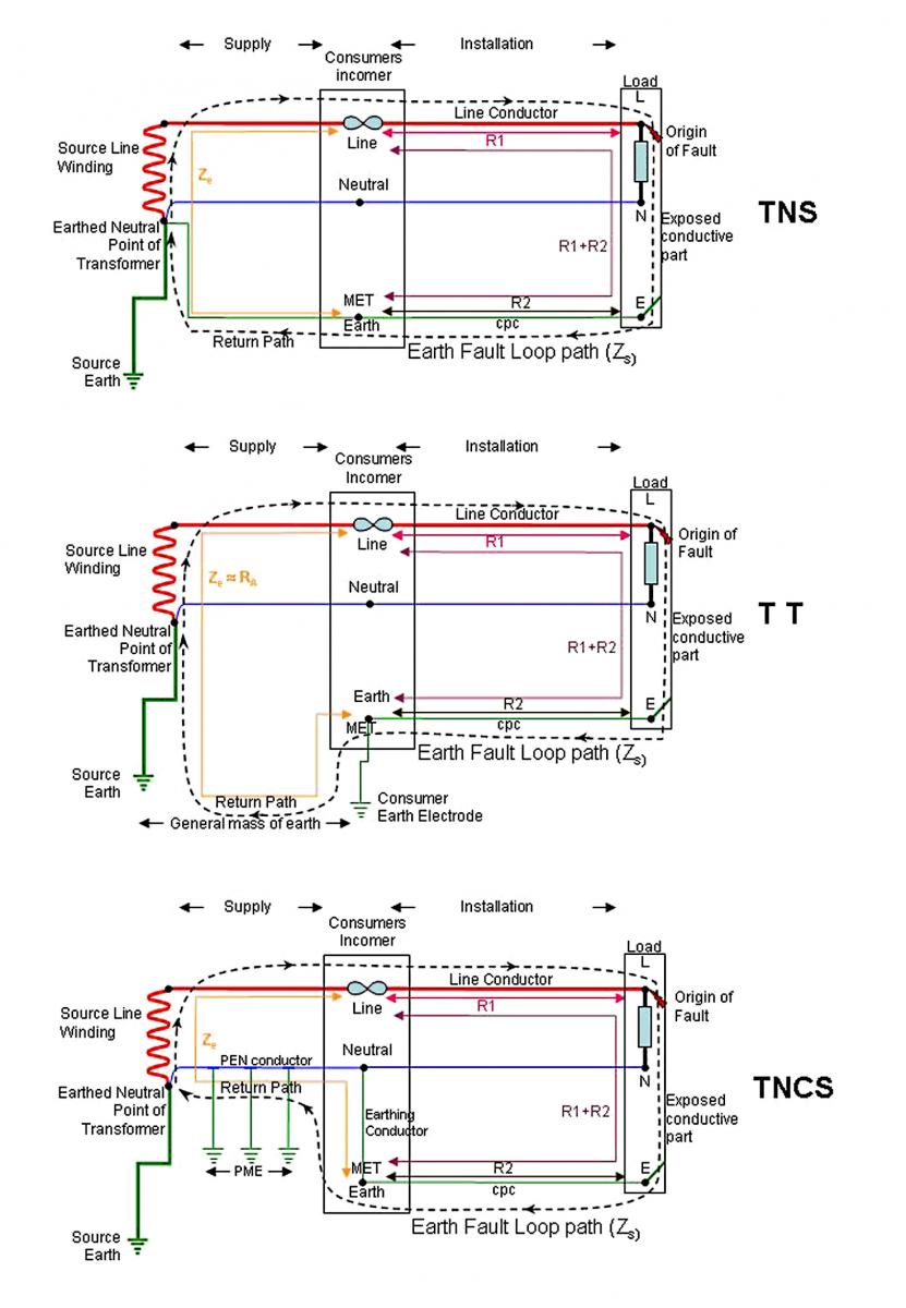

The final question on the paper required the candidate to describe an (earth fault loop path) for the system given in the scenario.
Many diagrams were incomplete.
Candidates failed to identify the component parts of the earth fault loop path and so lost considerable marks. A large number of marks are allocated to the labelling, or identifying in a written description, the component parts of the earth fault loop path as indicated in GN 3.
GN3 states the following elements of the earth fault current loop path:
The circuit protective conductor
The main earthing terminal and earthing conductor
For TN systems the metallic return path or for IT or TT systems the earth return path
The path through the earthed neutral point of the transformer
The source line winding
The line conductor from the source to the point of the fault
These are example diagrams with the parts of the EFLI identified as well, for understanding (Zs, Ze, R1, R2, R1+R2)
Thank you . You.r a Star Richard . Outstanding . my friend .
This is what it is all about . A better understanding . 100%

GN-3 . P/54 . Instrument , Use the prospective fault current range of a suitable earth fault loop impedance tester for this test . 4.5 final paragraph
Using a PFC tester ( or EFLI tester set to kA )
GN-3 . Earth Fault Loop Impedance testers ; BS-EN-61557-3 .. Younger members
2394 : Q to A , These instrument operate by circulating a current from the Line-conductor into the protective earth . This will raise the potential of the protective earth system .

4.5 Earth fault loop impedance
A) This means that the instrument should cut off the test current after 40mS .. refer to
