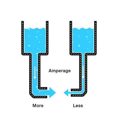

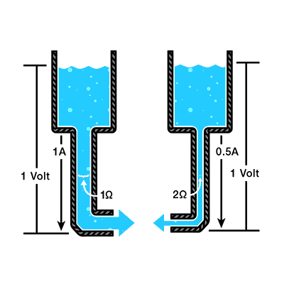

Impedance is much more complicated than résistance, taking into consideration that it relates to AC.
Every material has resistance. Copper has a low résistance
Résistance is something that “oppose or resist’s ” the flow of current.
First, the total length of the cables will affect the amount of résistance. The longer the wire, the more resistance that there will be.
Second, the cross-sectional area of the wires will affect the amount of résistance. Wider ( cables ) wires have a greater cross-sectional area
(( Water will flow through a wider pipe at a higher rate than it will flow through a narrow pipe ))
This can be attributed to the lower amount of resistance that is present in the wider pipe

Resistance ( R ) Suppose you've two water tanks, one with a narrow pipe and one with a wide pipe.
It stands to reason that we can’t fit as much volume through a narrow pipe than a wider one at the same pressure. This is resistance. The narrow pipe “resists” the flow of water through it even though the water is at the same pressure (voltage) as the tank with the wider pipe.
In electrical terms, this is represented by two circuits with equal voltages and different resistances. The circuit with the higher resistance will allow less charge to flow, meaning the circuit with higher resistance has less current flowing through it.
Ohm. Ohm defines the unit of resistance of “ 1 Ohm ” as the resistance between two-points in a conductor where the application of 1 volt will push 1 ampere, This value is usually represented in schematics with the Greek letter “Ω”, which is called omega, and pronounced “ohm”.
Ohm's Law
Combining the elements of voltage, current, and resistance, Ohm developed the formula: V = I . R
V) Voltage in volts
I) Current in amps
R) Resistance in ohms
This is called Ohm’s law. Let’s say, for example, that we have a circuit with the potential of 1 volt, a current of 1 amp, and resistance of 1 ohm. Using Ohm’s Law we can say: 1V = 1A . 1Ω
Let’s say this represents your tank with a wide pipe. The amount of water in the tank is defined as 1 volt and the “narrowness” (resistance to flow) of the hose is defined as 1 ohm. Using Ohms Law, this gives us a flow (current) of 1 amp.
Using this analogy, let’s now look at the tank with the narrow hose. Because the hose is narrower, its resistance to flow is higher. Let’s define this resistance as 2 ohms. The amount of water in the tank is the same as the other tank, so, using Ohm’s Law, our equation for the tank with the narrow hose is 1V = ? . 2Ω
But what is the current ?
Because the resistance is greater and the voltage is the same, this gives us a current value of 0.5 amps: 1V = 0.5A . 2Ω
Basic understanding (Ohms law)
So, the current is lower in the tank with higher resistance. Now we can see that if we know two of the values for Ohm’s law you can solve for the third
