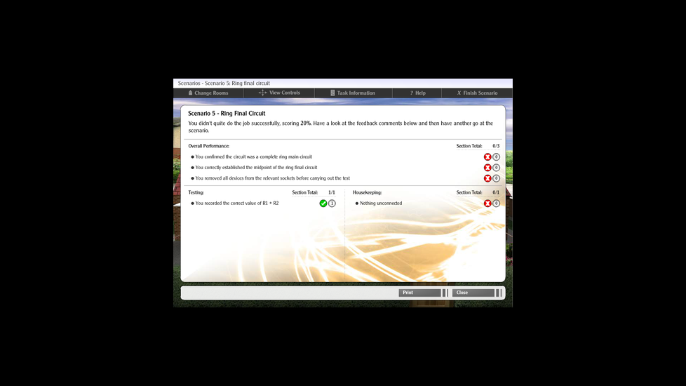

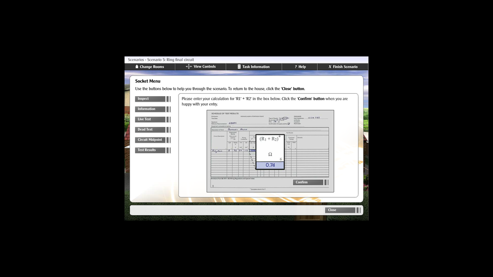

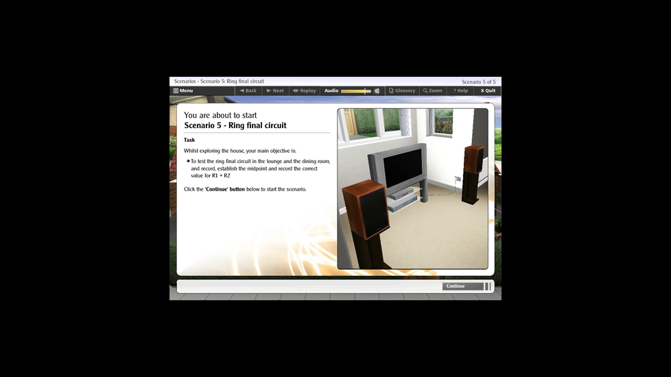

so the highest reading of the R1+Rn readings excluding the spur is the mid-point of the RFC, that bit came up right but i still got the other bit wrong its ATL practical training virtual programme quite cool if you know what your doing lol
yh its virtual learning you have to do it all right or it wont let you move on to the next senario, if this was someones house id be on rouge traders lol
So was I correct?

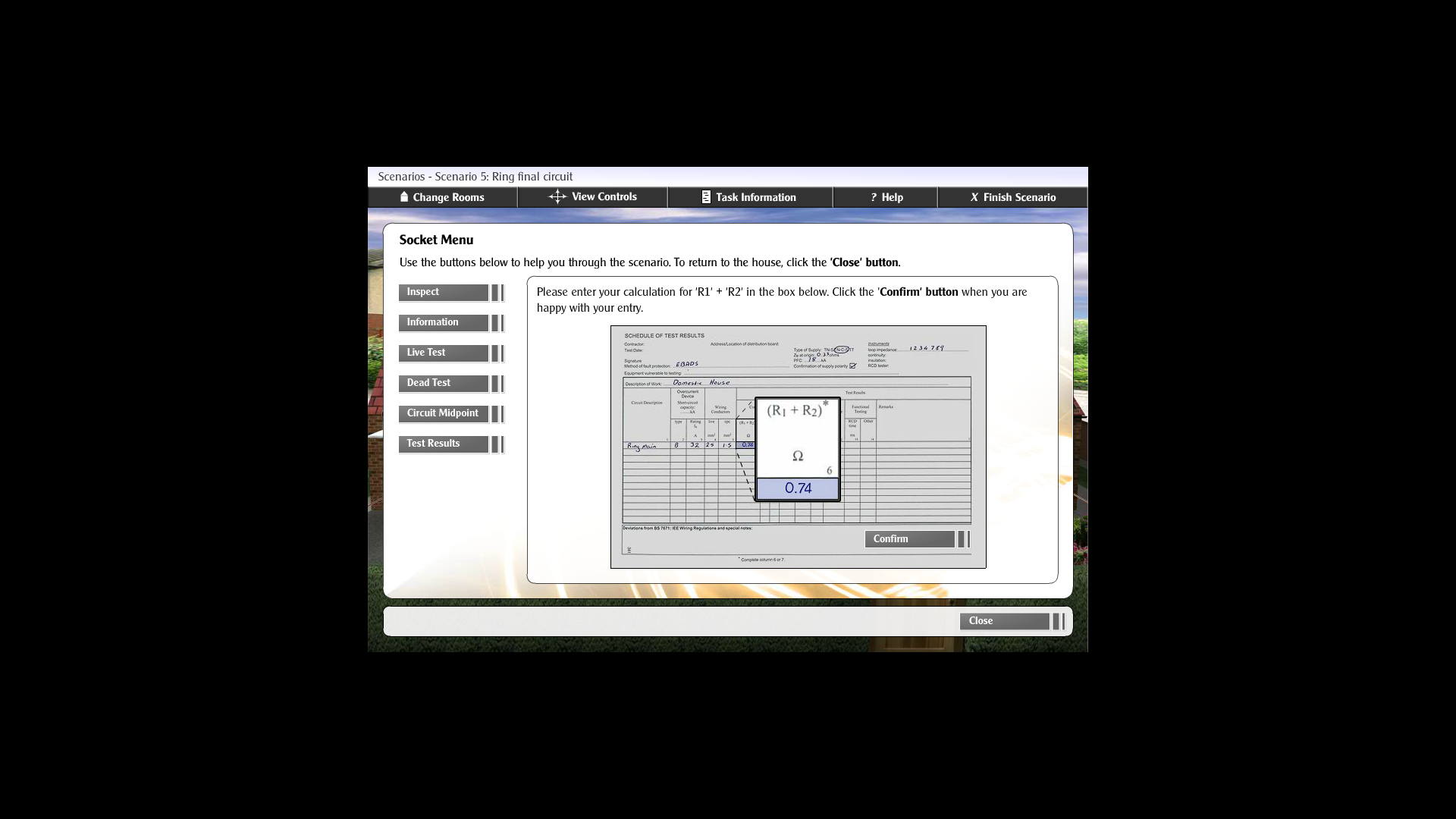

so now i have a virtual schedule of test results sheet and i have to input the (R1+R2)?
No no no...
Your dead test with Line & Earth cross connected is to show the ring is good.
You've of course done your end to end tests...r1, r2 & rn.
R1 + R2 = (r1 + r2)/4 Note upper & lower case letters.
If it is a good ring, all your measurements will be the same at every socket, ones at spurs will be slightly higher.
I am the worst teacher in the world by the way! :-)
yes its 0.74ohms thanks and im so sorry for the table i had to do that myself i wish you could come here and do the rest of this programme for me lol
William, get your hands off those Essex blondes, go and buy yourself a copy of GN3 and get reading.
Terminally boring I know, but you only have to do it once! :-)
Don't quite know were you're getting the 0.74 for R1+R2 from if r1 is 0.27 and r2 is 0.45 you don't just add them together. Archy has already said R1+R2 = r1+r2/4

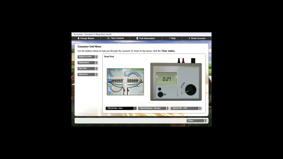

0.74 was a guess i did every test result i had even i did 0.27+0.45/4 and it comes up 0.3825 so i put this result in and i got a fail??
indeed it does lol drinking and maths and 1am dont go well together but the calculator won that argument, ill try it now.
Untitled.png LMAO when i clicked check line - line it clips both blue wires this programme is not good i thinks lol

Sorry to be disheartening but that virtual thingy looks like a load of nonsense.
If your L-L reading is 0.27 ohms (r1), N-N reading is also 0.27 ohms (rn) and your E-E reading is 0.45 ohms (r2) then there is no way on this planet that your R1+R2 reading is 0.74 ohms. Even though this simulator says 0.74 is correct, trust me it's not.
The CORRECT R1 + R2 is 0.18 ohms
If you believe to much in that programme you will fail big style.
Reactions: 1 person
my tutor has just confirmed that the senario is indeed wrong and that all you helpful sparkys were right so thanks alot to you all :)
