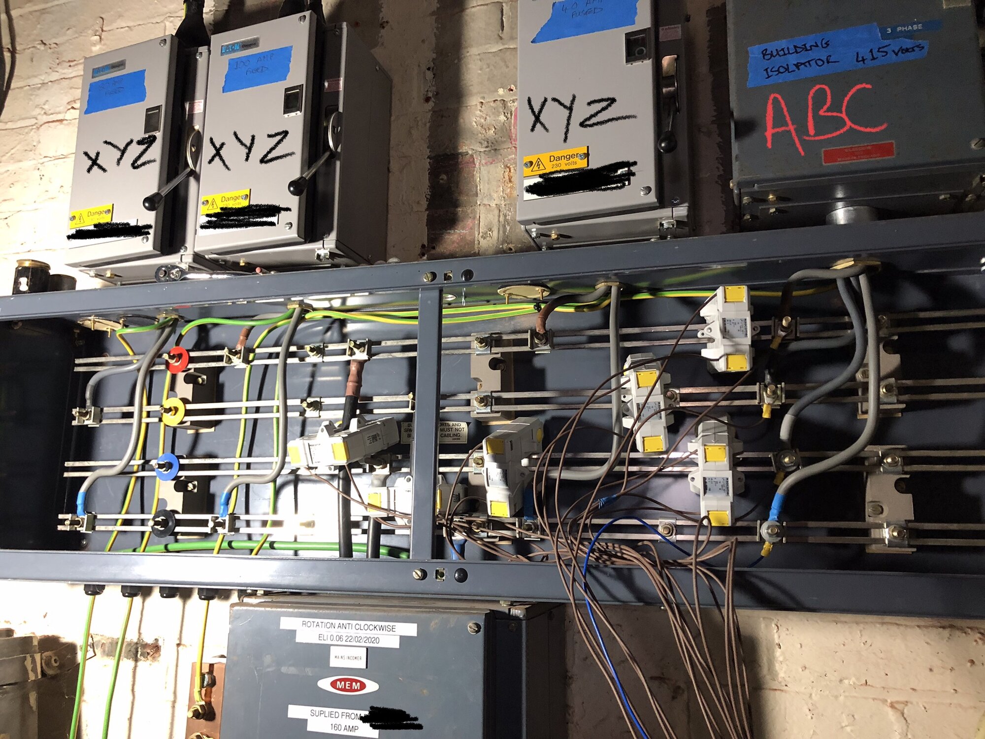

I was looking at an image in another post - copied below - and noticed the label 'Rotation anti-clockwise' on the lower MEM item of switchgear which is the main incomer. I wondered why it was mentionedat all on the cover since L1, L2, L3 or RYB and now Br, Bl, Gy is the positive phase sequence which by convention is anti-clockwise when drawn on a phasor/argand diagram. See this which shows positive theta as ACW:
