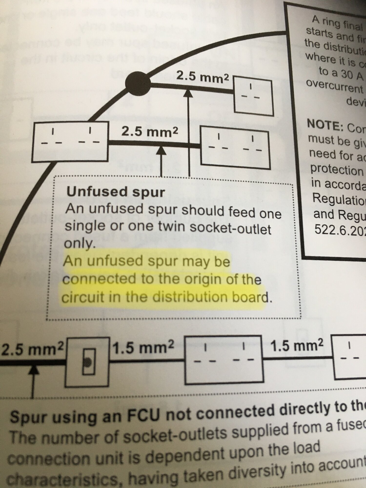

Whenever I swap out a board I look to put everything on its own OCPD and leave space for expansion, so there's often more breakers than the original board.
However if I come to a full board, needing a low power radial, I'll always put it to the customer that I can do a "Spur at source" (which some electricians frown on) or I can put in a new board and a dedicated OPCD.
Guess which option they choose.
You certainly can if you like, but it's not actually required as per other posts as it is legitimately one final circuit with a branch.
There isn't a right answer here - we'd all prefer not to add joints if not required, and we'd prefer not to stick two legs in an RCBO.
I'd probably gravitate to the latter option personally.
It would also give DP isolation to an integrated fridge.

Out of interest, would your comment mean that 314.4 can never actually be broken if combining radial circuits?
Splitting the ring and leaving both sections connected to the same MCB/RCBO doesn't break 314.4 in itself - it's just two radial circuits from the same source, but the breaker will have to be reduced from 32A to a maximum of 20A, and consideration made as to whether that is likely to be sufficient without experiencing overload. For those reasons, it's often preferable to split into two separate circuits.
Doesn't apply to fridges quite so much, because they have a light inside and are opened fairly frequently, but I always try to make sure a freezer is on the same circuit as something else important, such as the wi fi router or TV. That way, if the circuit has tripped out, it will be noticed fairly quickly.
Similarly, I always connect smoke alarms to the same circuit as the most frequently used lights.
When fitting decorative accessories in the kitchen & utility room, I decided to use isolator switches with neons for fridge & freezer. I know those neons will eventually fail, being permanently illuminated, but I like the reassurance of knowing that glow means all is good.
It clearly does:
314.4 Where an installation comprises more than one final circuit, each final circuit shall be connected to a separate way in a distribution board
