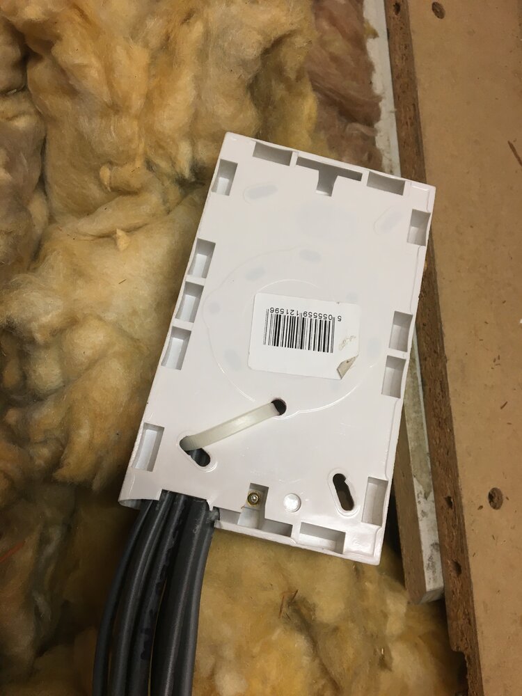

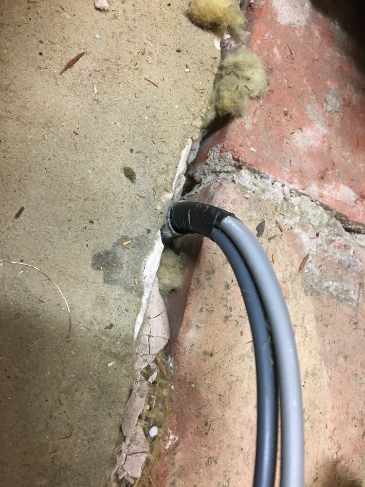

I realise it is somewhat late to be suggesting this, ... the problem as I understand it is the conduit is round is not going to take 2x 1.0mm2 flat T&E cables (assuming both switches just need 2 cores & earth).
So would using 4-core & earth round cable with solid cores have been acceptable, for example:
https://www.electricaldirect.co.uk/product/prysmian-4-core-and-earth-cable-15mmx100m-red-888110
Plus something to protect the sharp edge at the top of the conduit, e.g. I've used glue-lined heat shrink in the past, folded over and into the conduit (space permitting).
Obviously this cable would need splitting into the two circuits, e.g. at a Wago box somewhere.

Very poor workmanship striping all the mech protection off of the twin cable is very poor the inner cores of the twin, and earth are not designed to be used this way, not a very knowledgeable Electrician, nor is it compliant with the Regulations ( BS7671) PS Did you receive any certification from this so called Electrician? an EIC,

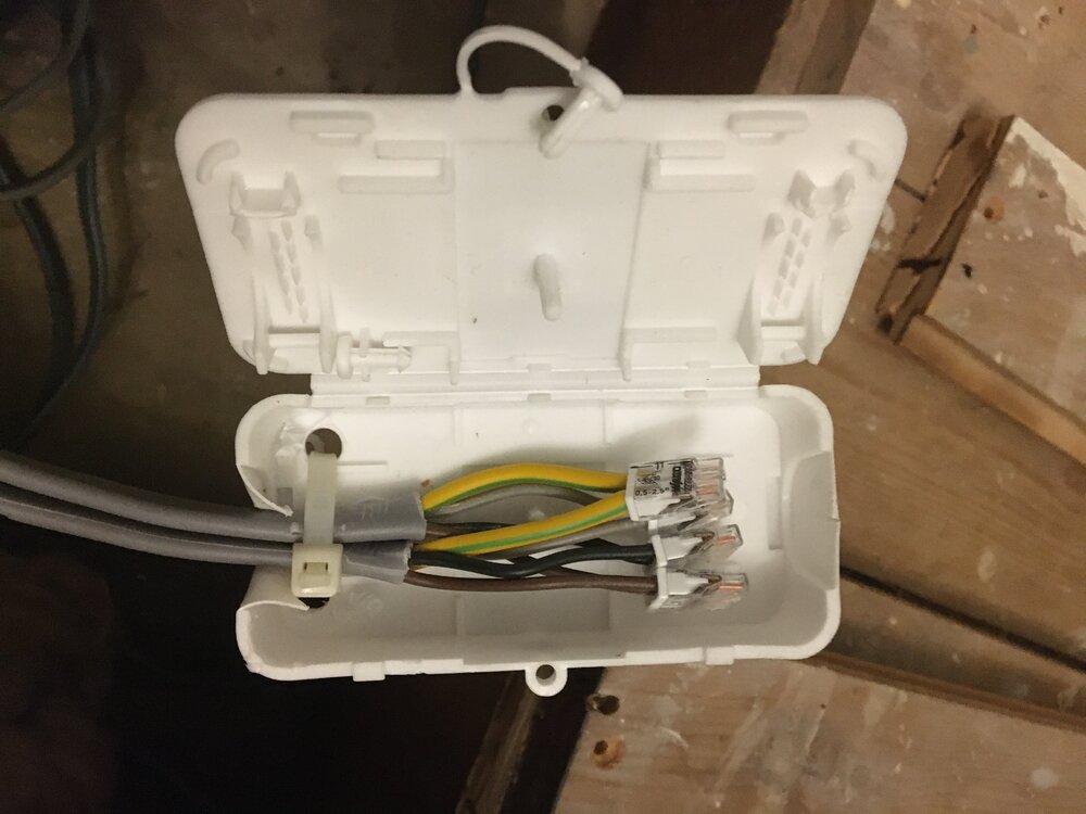

Seems that the junction boxes are not great but not dangerous either? A couple a Wago boxes relevant for the connector type used would solve that problem?

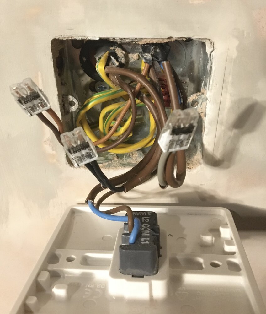

Here is a picture of behind one of the light switches that is fed by the cable drop that has the three core with a twin & earth cable fed down it.
You can see the three core cable going through the rear of the back box to the two gang light switch on the other side of the wall.

Seems a bit busy for a 1 gang 1 way switch. What does the other switch do? Sure he’s not earthed the back box, and so the split conduit (if the correct fittings have been used)?

The switch on the other side of the wall is a two gang switch controlling a pedant & some downlights hence it being two gang.
Because the wires running down the wall are unsheathed he has joined the wires inside the back box & then ran a sheathed piece of three core cable out the back of pictured back box to the other one on the other side of the wall.
The split conduit stops in the wall & does not attach to the back box.

Agree with @Midwest those back boxes do not appear to be earthed as the cpcs are connected into an isolated push fit connector. They definitely need to be earthed.

I guess because 6181Y is double insulated it can just be ran to the junction box in the loft?
I can see 6181Y cable listed on the CEF website but cannot find one with a CPC attached, is a different model of cable?
Would it be acceptable to run just another 6181Y 1.0mm cable for the CPC & sleeve it with earth sleeving or is this a no go?
Sorry the one with a cpc is 6241Y.

I don’t think replacing the unsheathed 6242y cables with 6181Y cables is a go’er, unless it’s for a single switch. The switch point you’ve posted is an example.
I think you need to raise your concerns with your electrician, to come up with an alternative plan, to the one you have initially agreed to. It might need a little bit of redecorating needs to happen. As to who will fund the alterations, is something you’ll have to discuss; but I think it might be primarily yourself.
