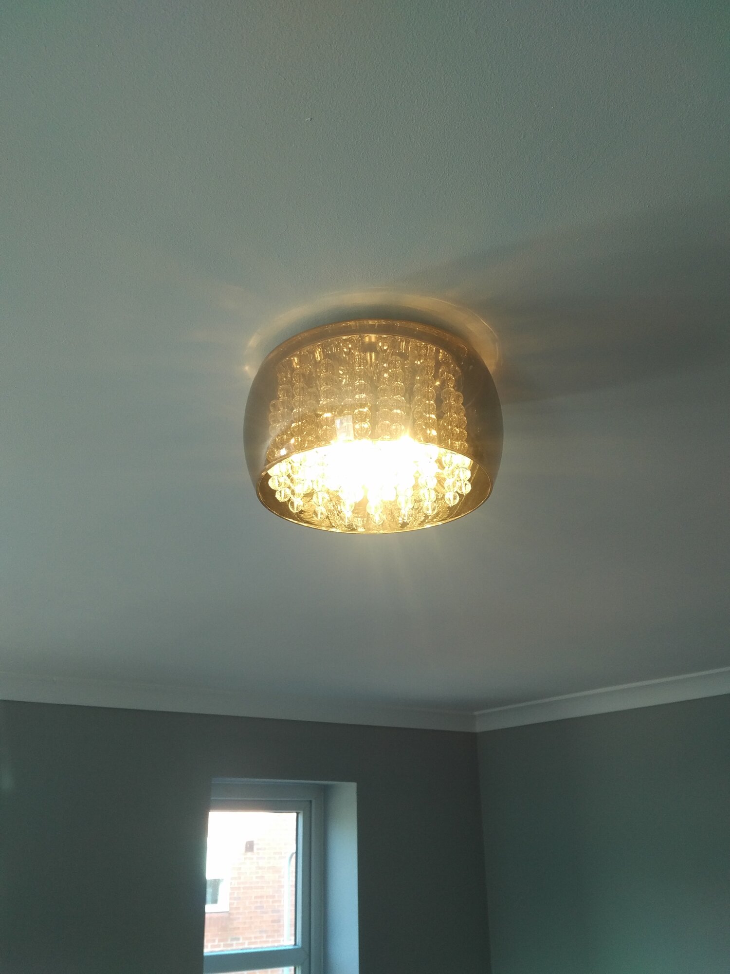

You have two reds and two blacks, one of the blacks has a red sleeve.
The one with the red sleeve on should be the switched live to the light (to brown). The black with no sleeve should be the neutral to the light (to blues) the remaining two reds to go into a two way wago. As the light fitting is double insulated/class2 the two earths (cpc's) can also go into a two way wago. Ensure all cables are pulled into the new fitting with no wires exposed in the ceiling void.
I do however suggest you employ an electrician to ensure correct polarity
You can't pull the PLs in to the fitting to wago as they'll not be double insulated, it is the black rubber boot and crappy plastic box that offers the class2ness of the fitting.
I hate these, you have to wago box all the cables and run a flex to the light, PITA.
The rubber boot and the rest of the useless connection in these lights is irrelevant for maintaining class 2 if there are manufactured single insulated wires coming out the other side of it. These useless fittings boil everyone's blood. Good luck with anything except a single 1mm cable. While I'm at it... why the hell are the terminations on most dimmer modules so miniscule? 3 plated the switch position or wired in 1.5? Good luck!

There is the clear sheathing over the insulation giving those conductors the double insulation required. It’s the issue of getting 2 cables into the black boot and maintaining double insulation that’s the issue.

I assume ????? the design idea behind the black boot is that a homeowner just cuts off the existing bayonet fitting from the pendant strips back the two core flex to a shorter length and somehow fits the whole fitting over the ceiling rose, therefore no need for two cables to enter. Very novel!!

So I visited this job today, really nice customer, not long moved there! I can see why it was difficult to install, the light itself was appalling, as usual 3 hands to fit. So I managed to get a wagobox lite in above the fitting with a flex out looking like this! IMG_20210215_1216394.jpg
And about 15mins later ta-da

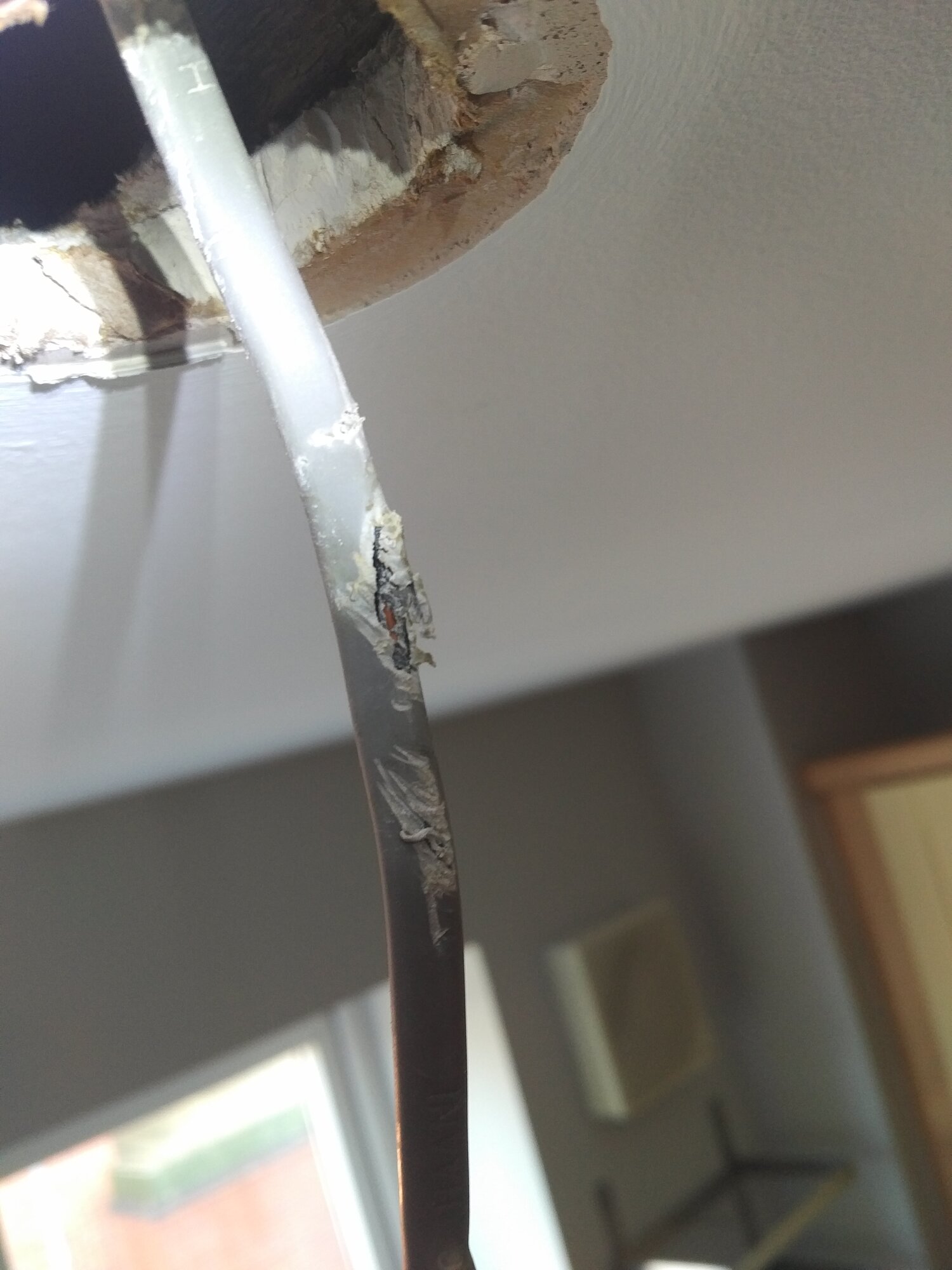

I also took a look at some downlights in the kitchen whilst there and oh dear. All the earth's were cut off and the original contractor had damaged the cables while installing them, and done nothing to make them safe. IMG_20210215_1254008.jpg
So the one I took down is now safe and awaiting replacement with some new safe ones!

I also took a look at some downlights in the kitchen whilst there and oh dear. All the earth's were cut off and the original contractor had damaged the cables while installing them, and done nothing to make them safe. View attachment 64752
I am the original poster and must say thanks to everyone on the forum and obviously a BIG THANK YOU to Sparkysy!! No huffing and puffing or complaining about how horrible the fixing was - he calmly assessed the job and just got on with it. Lesson learn from me though - no more buying nice looking lamps without thinking about the fixings!!
I also asked Sparkysy to look at the light in the kitchen and was shocked at what he discovered. He explained that the previous installer had bodged the job and without charging extra he made the fixing safe.
