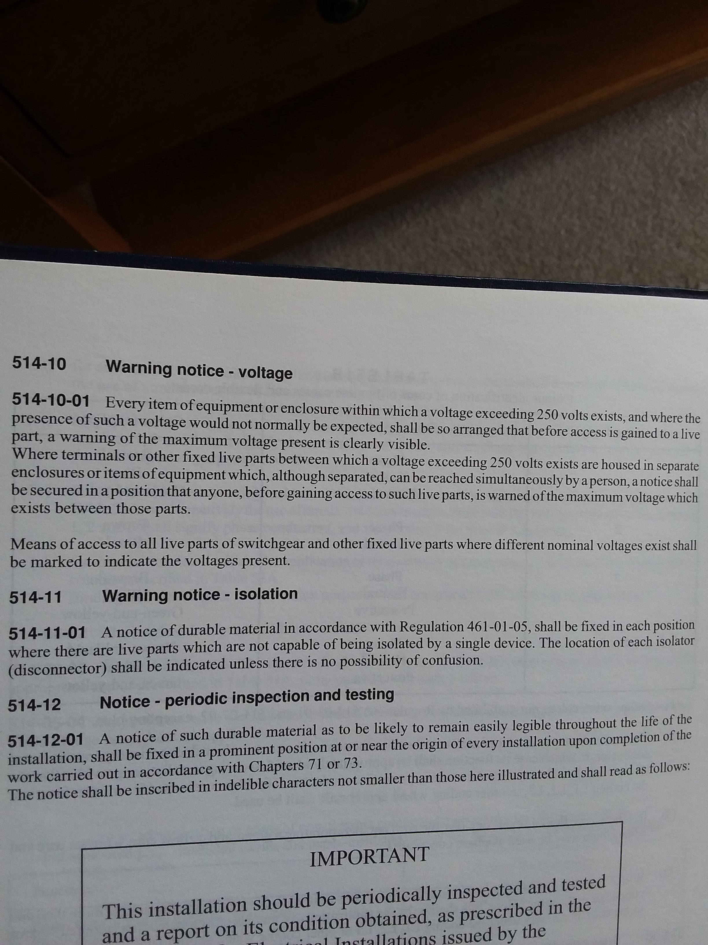

Would you worry about the rings are on different phases & close to each other.

Socket outlets simultaneously accessible when on different phases?

I also am interested in why you think this does not comply to regulations, there is no issue at all here and if I recall there was once a regulation which called for them to be marked with a caution label if within arms reach of each other but I don't believe that exists anymore.
So in your own opinion what are the dangers or concerns here?
Maybe this is the reg that remember !!! Perhaps not valid anymore with the 18th??
I think it dates back to the 16th and was lost when they redefined the regulation about marking switch points and outlets in excess of 230v, this was later altered to 230v to Earth which thus covered standard 3ph 400v and meant no labelling was required.
The original regulation is still in use but the goal posts where moved in its effect.
16th - Was it really? Some things stick in the back of your mind regardless of changes in the regs!
It was the 16th. However the intent was always voltage to Earth and not between phases so this was clarified.

And the 17th I believe
This is from the first 16th Ed (1991) and gives requirements for necessary notices. There is no Regulation prohibiting socket outlets in close proximity being on different phases.
used to be, back in the day, (16th ed. i think) it was advised not to have 2 separate phase outlets within 6 ft. of each other. this went down the drain along with the "Danger 415v".

There is nowt in the 16th Ed which prohihits this. The common rule I suspect came about that if all accessories and equipment in a local area are common to one phase then the need for notices was not required.
