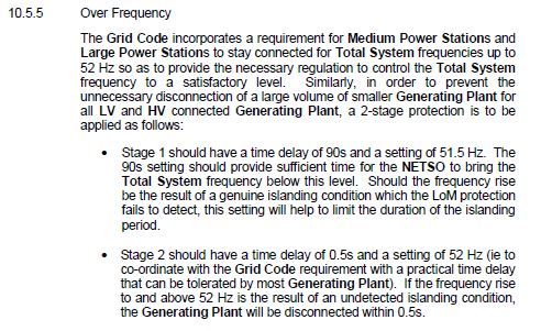

Just a thought,
G83 over freq setting maybe in the range of G59 setting but it is also a full 1Hz below the reccomended limit. So nuisance tripping on larger systems might cause problems with the dno, thats why G59 settings are more forgiving. It does'nt explain why only the frequency limit has to be altered and not the rest of the parameters.
I think you may be right there. Here is a G59 extract:
and also explains perhaps why sma went to the trouble of certifying their tripower range to the g59 standard in Feb this year
