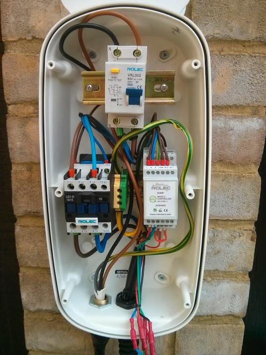

The image in this post is the wiring inside a rolec wall pod. nothing fancy at all.
@Gavin, do you normally install a B-curve MCB? I have read of inrush current on EV chargers, notably with the Zoe, where a C-curve is needed.
  • Informative
Reactions: 1 person
You gunna identify that black supply neutral and sleeve the cpc in a professional manner.
Blue is the only recognised colour for identifying the neutral!
Black is a phase identification colour ie L2
Sorry couldn’t help myself :)
Its not one i installed. Thats just an image i pulled of google purely to show the workings and how little is inside. They come ready assembled and its the whole thing about manufacturers instructions... If they have designed it in such a way can we then change it?? I also noticed the cpc is part of a 3 core. So either they have tt set up. Or confirmed with dno its tns and will not go to pme... Otherwise if its pme you have to risk assess it. If in doubt put it on a rod.
