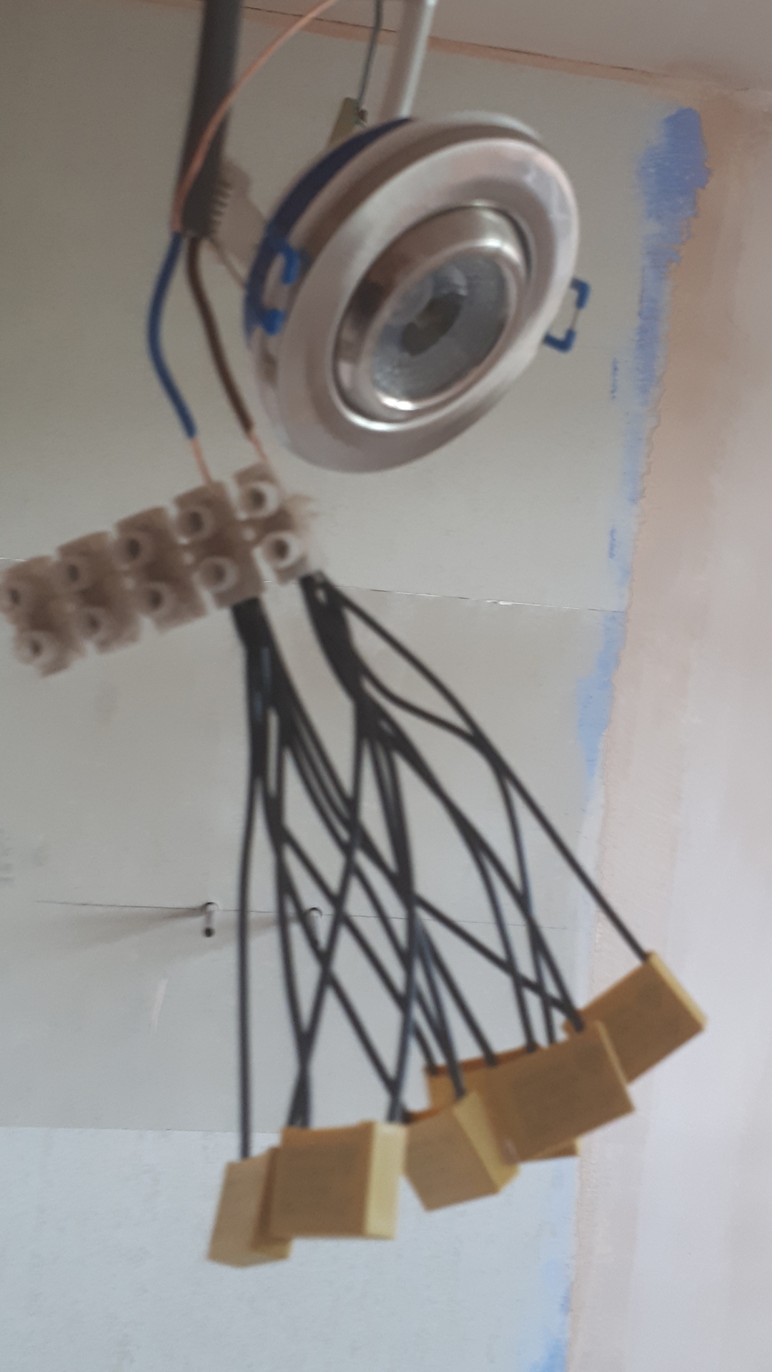

I have put 7 snubber s into the first light JB. Flickers and then peters out over 30 seconds.

The snubbers need to be on each individual light not all bunched together, see post No 39 that is just one light connected at the lower end of the junction box.
Its the bulb that is picking up the Ghost voltage not the circuit.
I had 8 spread across 4 lights at each Jb, but you said put them as close to the first light, hence all 7 on a short tail off yhebjb for the first light - I'll put them back on each light on then.
The snubbers should be across each bulb, not the junction box starting at the closest bulb to the main junction.
They were across each L/N at each blue 'click' connector at each light. Same as in you picture of the pmr209/connector box setup. Each light had one.

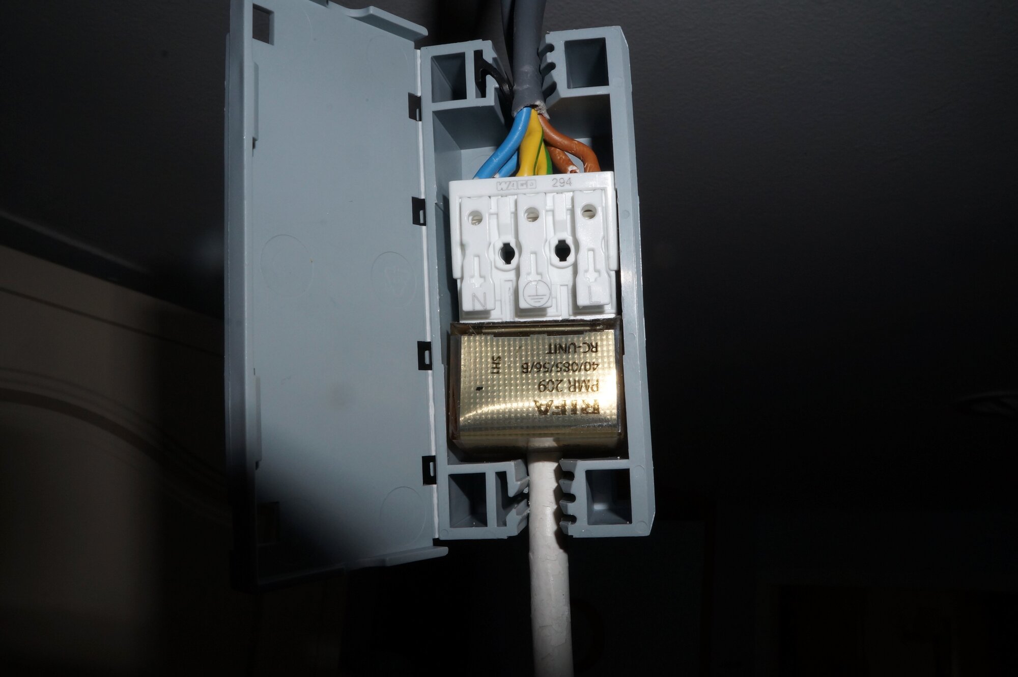

Are you using PMR209 snubbers? Your picture on the post above does not look like them.
They are not pmr 209, but are equivalent rating. I'll get some mr209s ordered and try them - trouble is there are 30 odd types in RS and they don't have any with sh1 on them, like the ones in your picture Mike - does this matter - will any pmr209 do the job. .47uf, 1uf .22uf what rating do you suggest please?
I can't see how that would matter in this case. As long as the values are the same. It's only 2 components bundled together in one package.

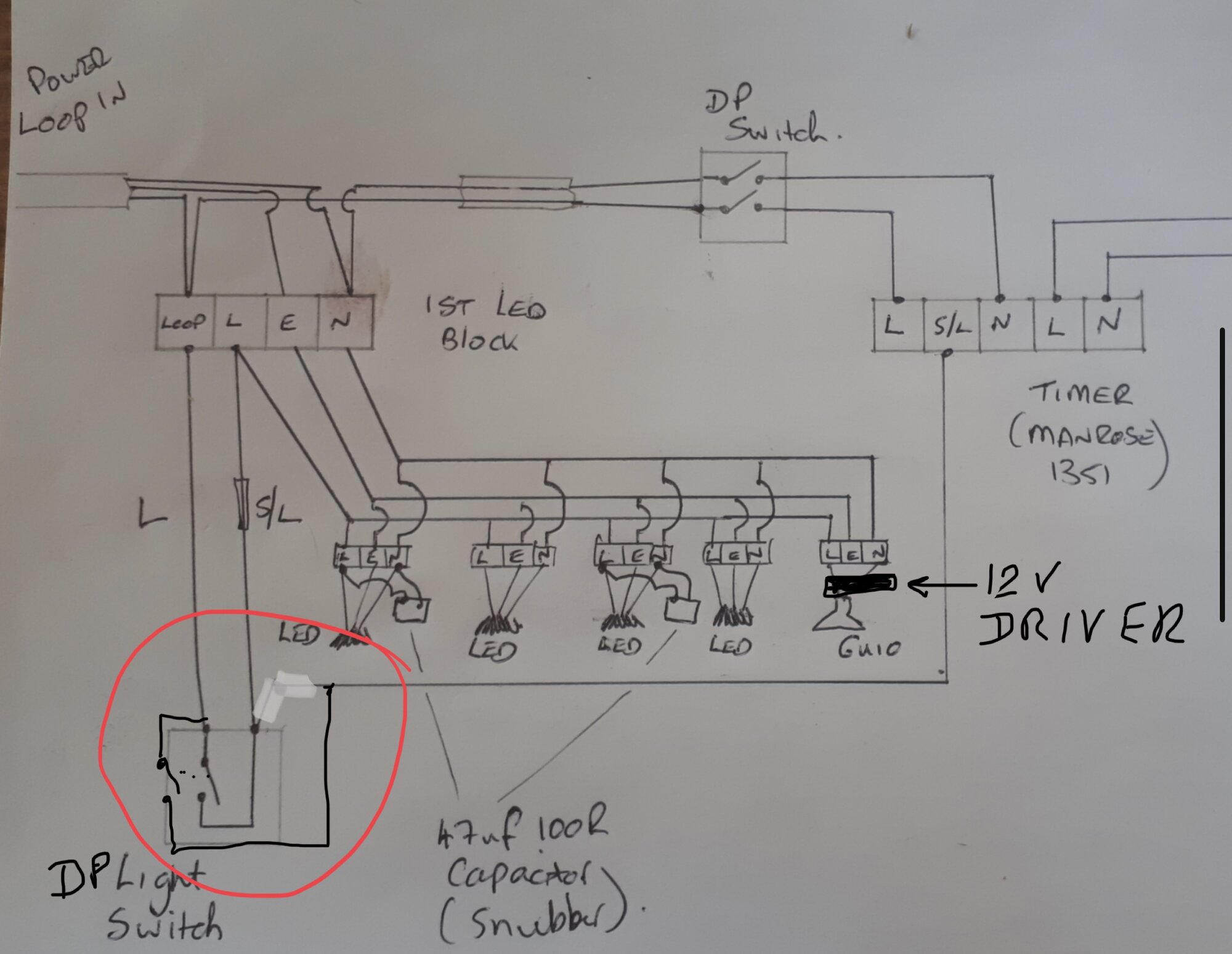

I don't remember a 12v driver/transformer in any of the other sketch's, is it supplying 12v to just that one bulb or all of them?
Reactions: Avo Mk8
See post #33. Supplying just that bulb is my understanding. It was rather hidden amongst all the dialogue and explains why the halogen is not itself an adequate 'snubber'.
So I took the liberty of adding it to the diagram!!

I suspect that the electronic circuit in the manrose 1351 timer is acting as a dc voltage source circa 14V at its SL output. Tomorrow I will draw you a sketch of what I think the innards of the 1351 looks like. This small voltage current source is sufficient to light the low wattage LEDs dimly. Being dc the snubbers are ineffective since they are a series capacitor -resistor combo.
What we need is a voltage dependent way of isolating the SL output on the 1351 from the conductor going back to the SL on the connector strip to which the LEDs are connected. A zener diode is a possible way. Please would you obtain a few - say 5 to 10 - of these 24V Zener diodes. Here is a link to Rapid Electronics website but using the Amazon and search for 'BZX85C24' you will probably find some of them:
Vishay BZX85C24 24V 1.3W Zener Diode - https://www.rapidonline.com/vishay-bzx85c24-24v-1-3w-zener-diode-47-3088
When you have them you will use another connector strip to mount either one or two of these Zener diodes in series with the SL just as it connects to the SL terminal on the Manrose 1351 timer. I will show you how in a picture once you have the Zener diodes. The diodes need to be connected the right way round. For voltages less than 24 V they do not conduct but over 24V they become conducting. Thus they act like voltage controlled switches. Using one puts a block on V < 24V whereas two in series would block when V < 48V. Thus for V of 14V at SL on the 1351 the circuit path back to the LEDs is effectively open circuit so no current flows to illuminate the LEDs dimly. Well this is my analysis but the proof is by testing the scheme out.
Note well: Just because they are 25 V Zeners their leads are at mains voltage so they will need insulating and an enclosure.
See my sketch attached.

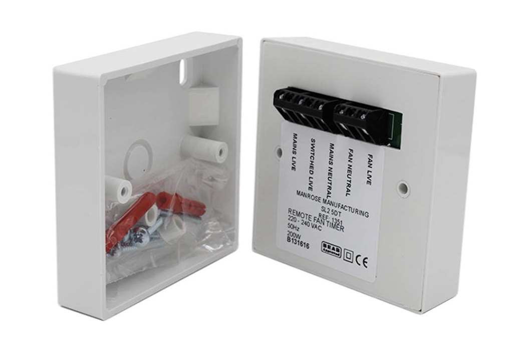

I turned up this ‘open up’ of a manrose timer fan. If you look at 4m50s you will see the chap has sketched the timer circuit and shows how the SL input is connected to the circuit. Just by looking at the adjacent circuitry of diodes and r3istors and capacitors you can see the possibility of dc current flowing out of the SL terminal. Also the measured 14.1V at SL wrt to N is in accord with the Zener diode voltage rating of 14.7V. The SL input responds to the light switch closure during the negative half cycle of the mains voltage sinusoid.
An external Zener may work then if connected in the way I showed earlier. May need to trial a few blocking voltage levels though.
I have the same unit to control my shower fan, it switches two independent LED GU10's in the shower cubicle without any flickering, but then I did wire it in accordance with the wiring diagram in post 7 between the SL and N into the Manrose unit after the switch.
Nice thinking. It will be interesting to see where this goes. Seems like it is definitely linked to the fan somehow.
I think that's the problem, the OP's fan has its own timer originally he had both the Manrose unit and the timer on the fan operating, did advise him to disconnect the fan timer, but it may need to be by passed.
Thank you so much Marconi for that.
Just a heads up that the OP has a separate run-on timer, which I think is the one below.
I believe he has connected the fan SL and L together at the fan, and then connected that combination to the Manrose 1351 unit. So I think what we are battling with is the SL of the Manrose 1351, which may or may not be a similar thing?
I haven't yet found a circuit diagram for the 1351, only the usual installation bumf that is everywhere.
