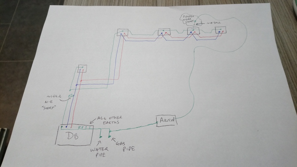

I had a fault like this in the past. Here is what I worked out was going on:
There was an old aerial cable buried in the paster near one of the sockets I was testing. When the socket was screwed into the back box, I measured 0.3MΩ (L+N) to E at the socket (and at all other sockets); when socket was disconnected >999MΩ; measured at the DB, 1.6kΩ (N to E) due to the actual fault. There was only one fault - the 0.3MΩ was just the resistance between the back box and the connection to E (probably via the aerial earth).
