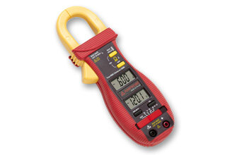

Gents starting a new job after Xmas and need to buy myself a multi meter.
I will be doing routine maintenance in production line type stuff.
Anyone recommend a good make a model of multimeter in the past u have used what companies had but think I need bring my own to new job.
Thanks

The one I carry in my toolcase and use for almost every job I do is a dual display clamp meter which is basically a multimeter with AC/DC volts, ohms etc plus obviously an RMS ammeter. It's compact and it's particularly useful to be able to see current and voltage simultaneously when checking general circuits and motors/pumps/compressors etc.
If you're looking for something budget try Uni-t or Di log or Metrel.
