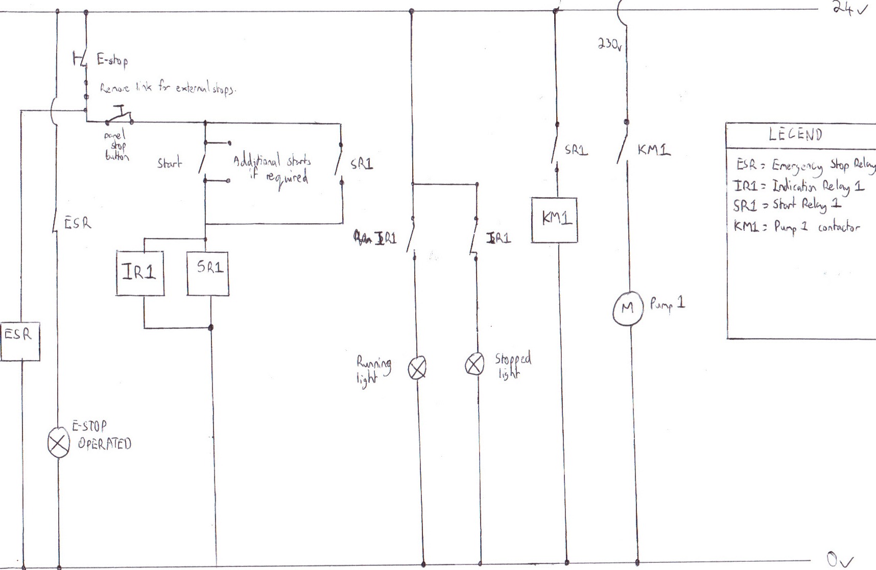

Hi lads, ive just drawn a simple starter for a 1ph pump.
Can you please view this, and criticise it, so that i may learn?
There is 1 glaring error, which i know about, and didnt have any tip-ex to erase. I also know that fuses are not shown, and thatbthe 24V transformer is not shown.

Looks ok but you got the pump neutral connected to the 24v neutral and you should also show at least one normal stop button. And the removeable 'stop' link shown is not ok for normal stops because it will operate the epo operated lamp.
Also, controls should always where possible monitor the actual status. You have drawn 'pump stopped' 'pump running' lamps controlled by a relay on the stop circuit, its not a true and factual indication. On a pump it is much better to have differential pressure switches, these are fitted across the pump and are a true indication of whether the pump is pumping correctly or not and can also be used to monitor blockages or a major leak, simlar thing can be done with flow switches.
Likewise with a fan the important thing to know is, 'is it delivering the correct amount of air' this can be montored by a proximity switch calibrated to count the number of times the fan blades pass per second, it it matches the commissioning speed theres nothing else you need to know.
Always monitor the effect of the piece of machinery.
cheers oxo. Tghe 24v neutral is the problem which i couldnt find tippex to erase! lol.
Im familair with pressure switches and trandscucers, with my current job, but didnt want to get into that level of complexity on this drawing yet. Ill draw another one when ive got time, and try and incorpororate suction and delivery pressure switches.
i thought i had added a normal stop button, labelled "panel stop".
can you elaborate about the removeable link please mate?
The idea, as far as im concerned, would be to take the stop circuit to a set of din rail terminals, and then link them manually, so that in the future, e-stops can be added without modifying the panel.
thanks for your advice mate. Im trying to learn more about process control.

First off what is the ESR doing other than turning a light on. You change the function of the light to E-Stop healthy.
IR1 and SR1 can be done away with by using auxiliary contacts on KM1.
Sorry I’ve thrown away ¾ of your drawing.
Will send you a drawing later
ESR could be used to control other things that may need stopping at the same time. Maybe not applicable with a pump, but maybe with other machinery.
agree with using auxillary contacts for running lights, i just didnt think, although ive use them like that before.

Sorry, never twigged 'panel stop' as the normal stop and thought where you said 'additional stops' they were normal stops, and in that postion they would 'incorrectly' operate the 'epo operated' relay.

Personally I would not bother with the e-stop relay unless it was a dedicated safety relay and the system required it.
In which case you would need a reset for the esr.
I'm not happy at the way the esr would re-close on releasing the e-stop, my own interpretation of the law and the standards, along with how I have been trained and mentored through my career, pushes me away from this type of operation.
If you look at the other thread on PUWER by Archy then look at the document from HSE you will see the references to the standards and guidance, and it may even be in there, that "releasing an e-stop must not re-energise anything".
The Notified Body I work with also do not like this and it is doubtful would 3rd party CE mark a machine with such a design.
I would never sign off a design with this feature.
I would repair a machine to this standard, depending on the cost to modify to an acceptable function.
Even though it is a simple single phase pump, what it is pumping should have a feedback into the design of the control system.
e.g. low pressure ambient temperature clean water, a "simple machine"; hot concentrated nitric acid, not a "simple machine"!
