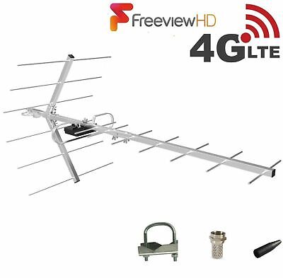

I am in UK and have just built a summerhouse and inside is a large LG flatscreen TV. I purchased an aluminium pole, ran the cable out and up (within the pole, I hope this does not matter) and attached it to the ariel. It's only picking up three channels. The cable has preformed F type connectors on both ends and I have ensured they are firm. The ariel is pointing the same way as other houses. The site is free from obstruction - on the edge of a field.
The cable is standard co-axial cable and the ariel is also standard (link below)
What am i doing wrong? Really puzzled!

If you are not lucky when adopting the 'just put it up and see what happens' approach then you will (ideally) need a uhf signal meter. As Brian correctly states above, it is not just strength that is required, the signal quality is paramount. Have you got the polarity correct (flat for main transmittersa, upright for relays)? In an area where reception is problematic you are a bit lost without a meter so your only other option is to keep trying different locations, 6" can make a difference.
Amplification is rarely the answer with digital signals, amplifiers can cause more problems than they solve.
The EIRP diagrams that you see are all for 15m above ground level so height is often a requirement
