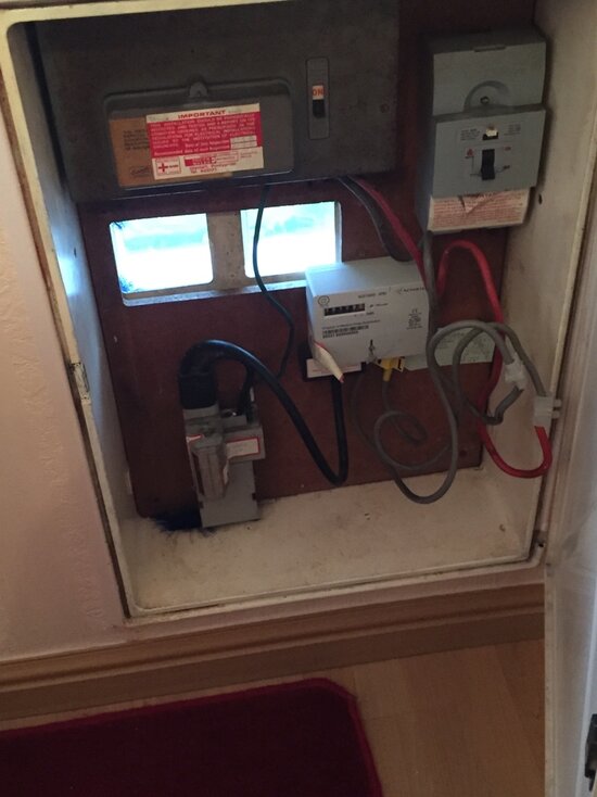

Hopefully my photos has attached. A job I was on earlier installing solar pv, where the old rcd unit was recently completely disconnected by an electrical 'engineer' and the tails were connector blocked together and left to dangle about in the meter cab in the hallway of an elederly couple. They were very concerned as said 'engineer' didn't accept payment and would be back to check the sockets in the week lol. Recommended full test and inspect to trace fault and a db change at the very least.

Why does it need a DB change when the job is to rectify a fault?

The rcd unit there had been smashed to bits inside so can't reconnect that. Obviously find fault/s then recommend adding rcd protection back to installation, wouldn't fit an upfront rcd , so therefore recommend a rcbo db as that's what I mostly fit now.
However there isn't a fault to rectify in the homeowners eyes as the guy has disconnected the switch and stopped the power going off !

Yeah iv seen these windows quite a bit, my mates got one where meter cab is inside and has the glass outside , the meter is on a hinged board so can be read from outside and then swung back to work on it. Only problem is that it's a metal cab with the tails goin through a razor sharp hole to the meter which went bang last Sunday night @ 12.30 lol

Don't see why I'm making a mountain out of a molehill ? I want called into fix the fault etc I was there to undertake other installation work, they had what they stated was a power cut due to what I assume is a fault which tripped the rcd and wouldn't reset. They called an electrician out who promptly disconnected the rcd, with a hammer by the look of it as the terminals were chewed to F***. They then connector blocked the tails live as the seals were stil in place. They then left without payment promising to return to test the 'plugs '.
So when I arrived I thought it was slightly rough and was a bit concerned that a life saving device had been disconnected.
