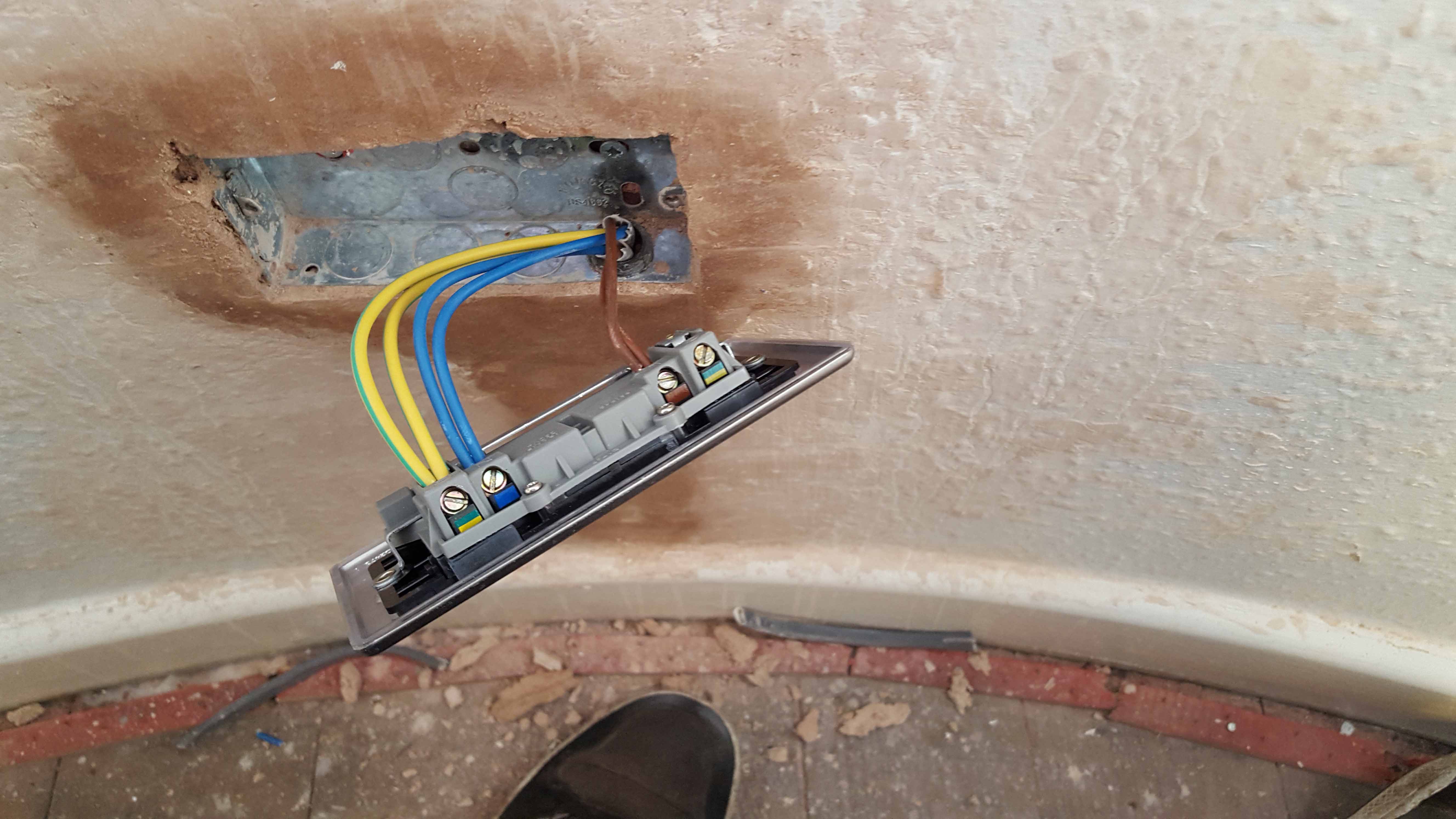

for what its worth, my opinion is that while it may be totally safe and technically acceptable, they have cut corners to save time, which will result in a poor finish.

The plasterer cut corners, the spark could have a legitimate excuse for routing the SWA in front of the skirting board. We can't see behind it.

Realistically the work could be fine and nothing in the pictures bar the loose cable suggests anything is actually wrong. Yes, maybe rough cutting out and I would have used conduit but there's nothing that indicates it is dangerous. I even see a grommet on the box so it can't be that bad...
Also your plasterer is rubbish

Yep I think you're right on that one. They came Monday and sorted the sockets that had issues and have provided the certificates to show all relevant checks were done. They claimed a miscommunication and that they thought I wanted it all done in one go. Like you say the final product doesn't look great, but at least I can feel confident it's safe as we moved in yesterday. All in all wouldn't recommend them or use them again. Thanks for everyone's input :)

I fill all my chases as standard. Feel stupid now with everyone saying its not a bad job. Why is that consumer unit practically sitting on the floor? To the OP how much did the job cost?

I hope this isn't one of yours ! Ring main Earths are one cable per terminal not two as in your picture
if you're referring to my last post/pic., then you're talking bolloX. separating the cpc's between terminals is only required with a hi-integrity earthing circuit. eg. with computers. check your eggs regs. and come back with a reason for your comment.

My reason is common sense most electronic devices use switchmode transformers which filter to earth .The regs state " which can be reasonably be expected to exceed 10ma " .Well it's your choice mate .But considering socket outlets come with two terminals !
It appears you have over reacted to a quite Justified statement .It wasn't meant as an insult to your work sorry if you took it that way . 543.7.2 ( 18 )

ssssimplees it's in case 1 falls out due to incompetent installation.

no offence taken, but you should research as to why the cpcs should be separated betweed 2 terminals.

Again no offence meant .But I have .This has become more of an issue in domestic Installations with the popularity in Led lighting and other newer electronic devices now using filtered PSU's . The main point is safety due to possible earth current transfer from device to device either resulting in capacitor induced shock or even fire . As someone else has stated this can result from a bad connection either by a high resistance connection, mechanical damage or possible capacitor failure within the device itself .

There is no need to seperate earth terminals on a Domestic install. You are right Stuey in what you say but lets not take things to the extreme.
This sounds like regurgitated carp from some college lecturer.
Switching PSUs are a slight problem we are all aware DC equipment has a higher earth leakage but how many does the average house have ?
Do you know how this installation is used by looking at a picture ? This install could be a elderly couple house, not a hackers house with multiple USB sockets and PSUs plugged in.
Led lighting is not usually applicable to either as this on the lighting circuit.

What a terrible installation. Massive holes made for sockets really bad looks like they used an angle grinder to cut those and damaged the skirting board to. Height of consumer unit far too low eye level please. Where is the covering protection over the wiring?telectrix so right mate. That loose wire has no screw markings on it I guess it was not secured?You have my sympathy I hope they come back and correct their faults and give you your certificate( do not hold your breath).

Sharing or not sharing earth terminals on a ring cpc is something of a red herring in this context. I think that the reason that high integrity earths are run separately is because computer and other similar equipment (including switched mode PSUs) use filters to meet RFI specifications (to control imported and exported RF noise). They employ filters that connect reactive components (capacitors and inductors) between line conductors and the cpc and this can induce RF currents in the cpc cable linking the equipment to the system ground point. If we really care about controlling RF noise, we should avoid the use of any ring circuits at all and have one system ground point to which all cpcs are connected directly to the ground point in a star network.
the purpose of separating the cpc's into separate terminals is in case 1 becomes loose or snapped, you'll still have earthing (protective and functional) to equipment .

Yes, I understand what you are saying and don't dispute the point. If you think about it, one or two terminals can suffer the same fate.
I was trying to explain why problems can occur with RCD protection on modern equipment (e.g. computers with switched mode PSUs drawing several amps at 230V) - by design, current will flow through the cpc and unbalance the RCD. Not everybody understands that.
agree with some leakage on IT eqwuipment, but each item should typically have a leakage current of 3 - 4 mA. this will only upset a RCD if too many items are on 1 RCD.

I think this is maybe what Stuey was getting at when he stated 543.7.2 but this is a separate issue. We generally work through the regs book and earth leakage is mentioned previously in 531.3.2 , we should select the correct type of RCD for the installation as per 531.3.4

But on the other hand this is different issue to putting two CPC of a Domestic RFC in the same terminal, especially where most of the switching PSUs will most likely be small types like phone chargers which are mostly double insulated phone chargers.

Would you consider a domestic installation as unlikely to need consideration for high integrity earthing unless there is a specific reason (e.g. medical equipment)?
Yes, I agree.
No not unless the copulative earth leakage current exceeded 10mA Regulation 543.7.1
