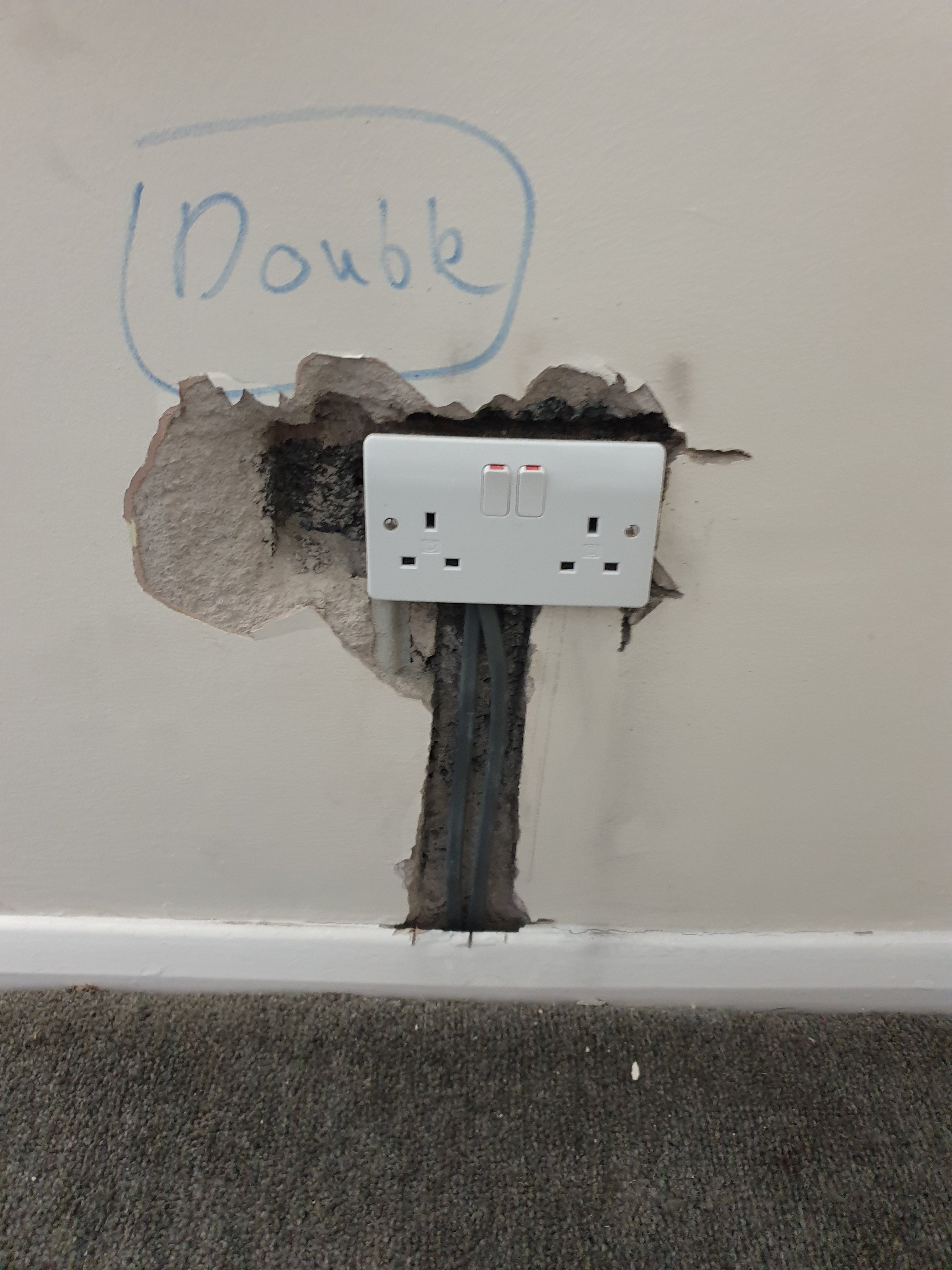

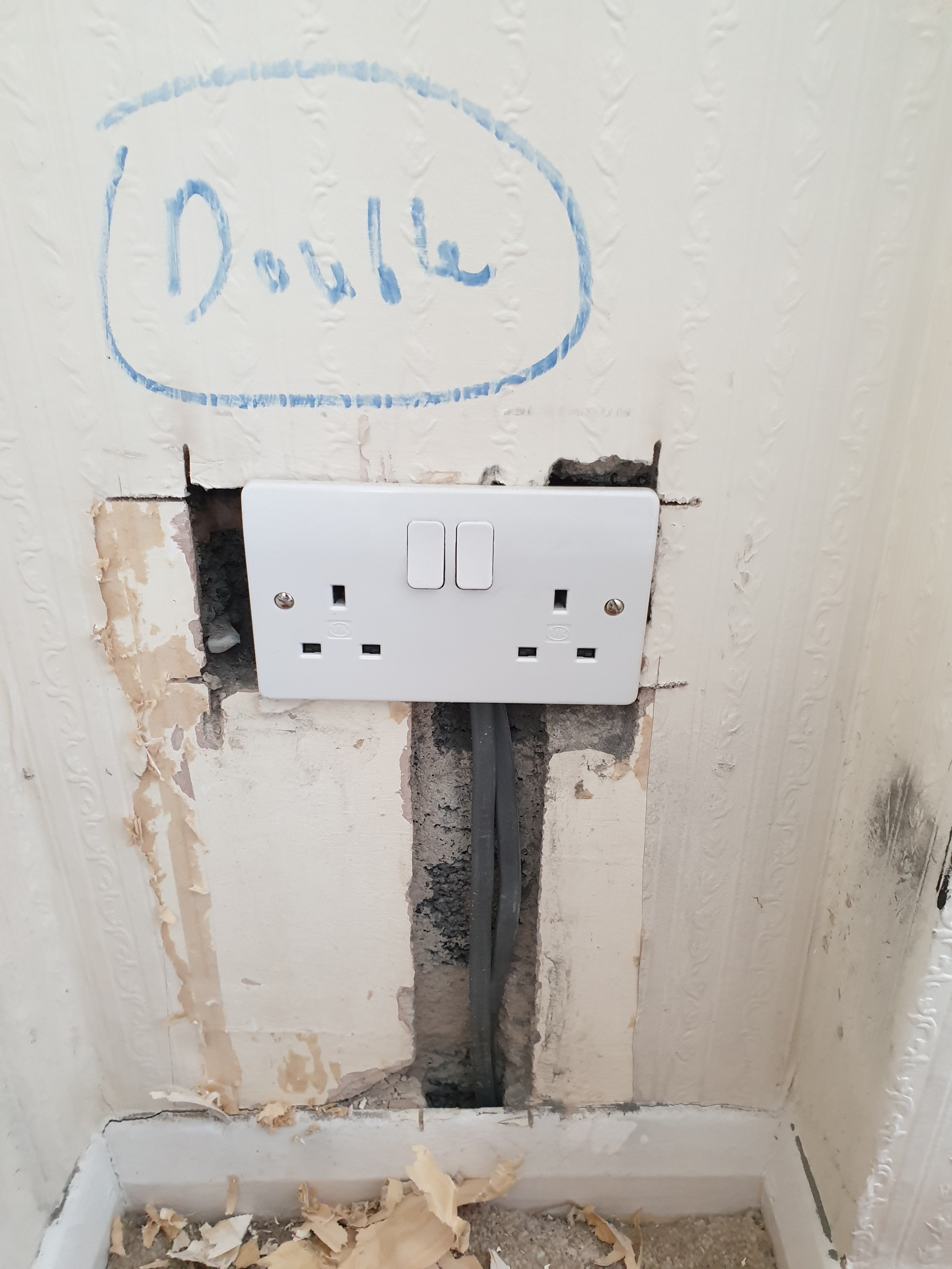

1. The holes made to put in the sockets are generally quite a bit larger than the face of the external socket casing.

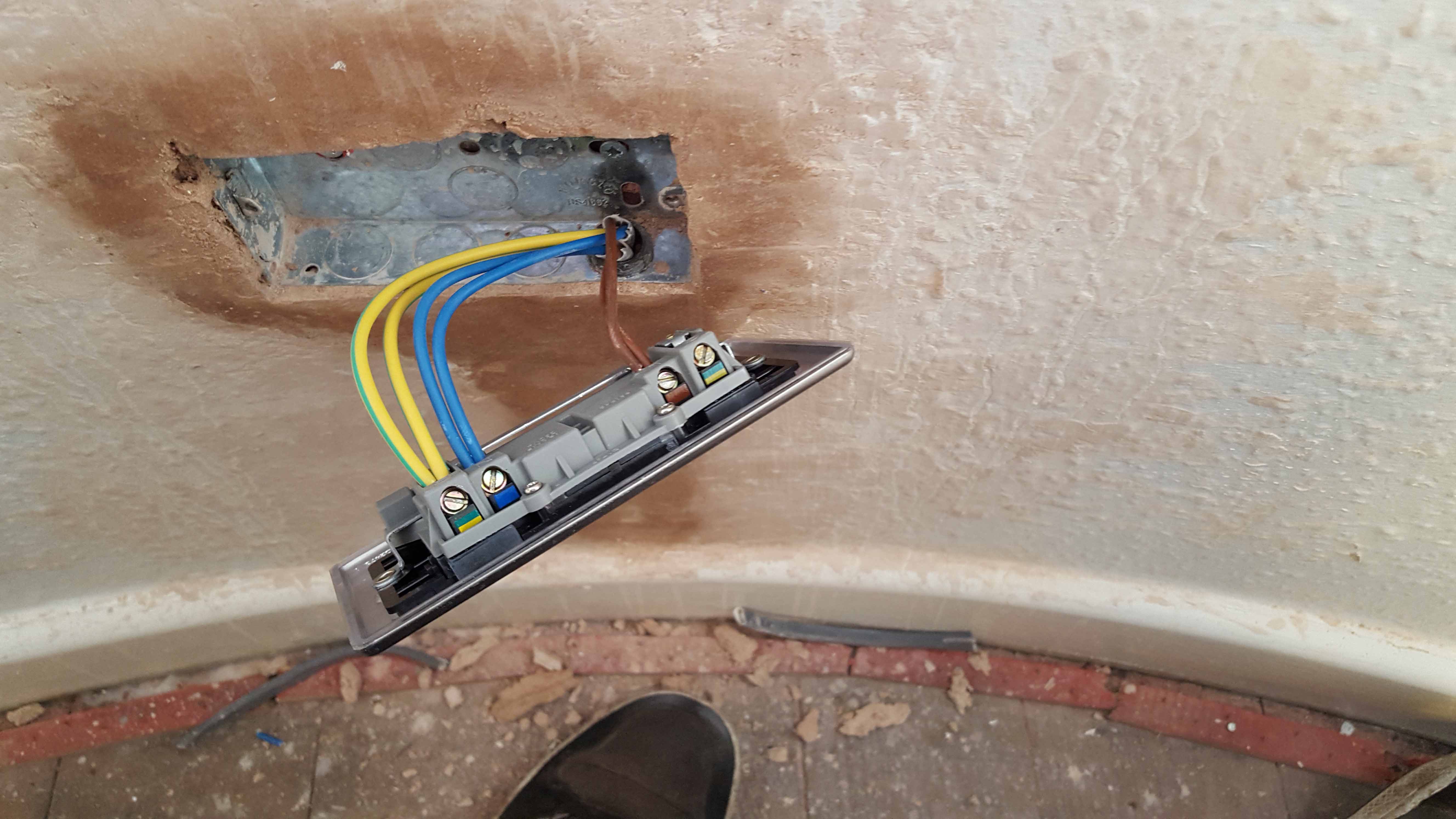

2. One of the sockets had a loose wire that was not connected when the plasterer was plastering around.

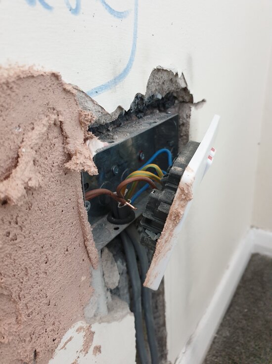

3. Another socket melted the builder's plug (smoke coming out as well), but didn't activate the trip switch.

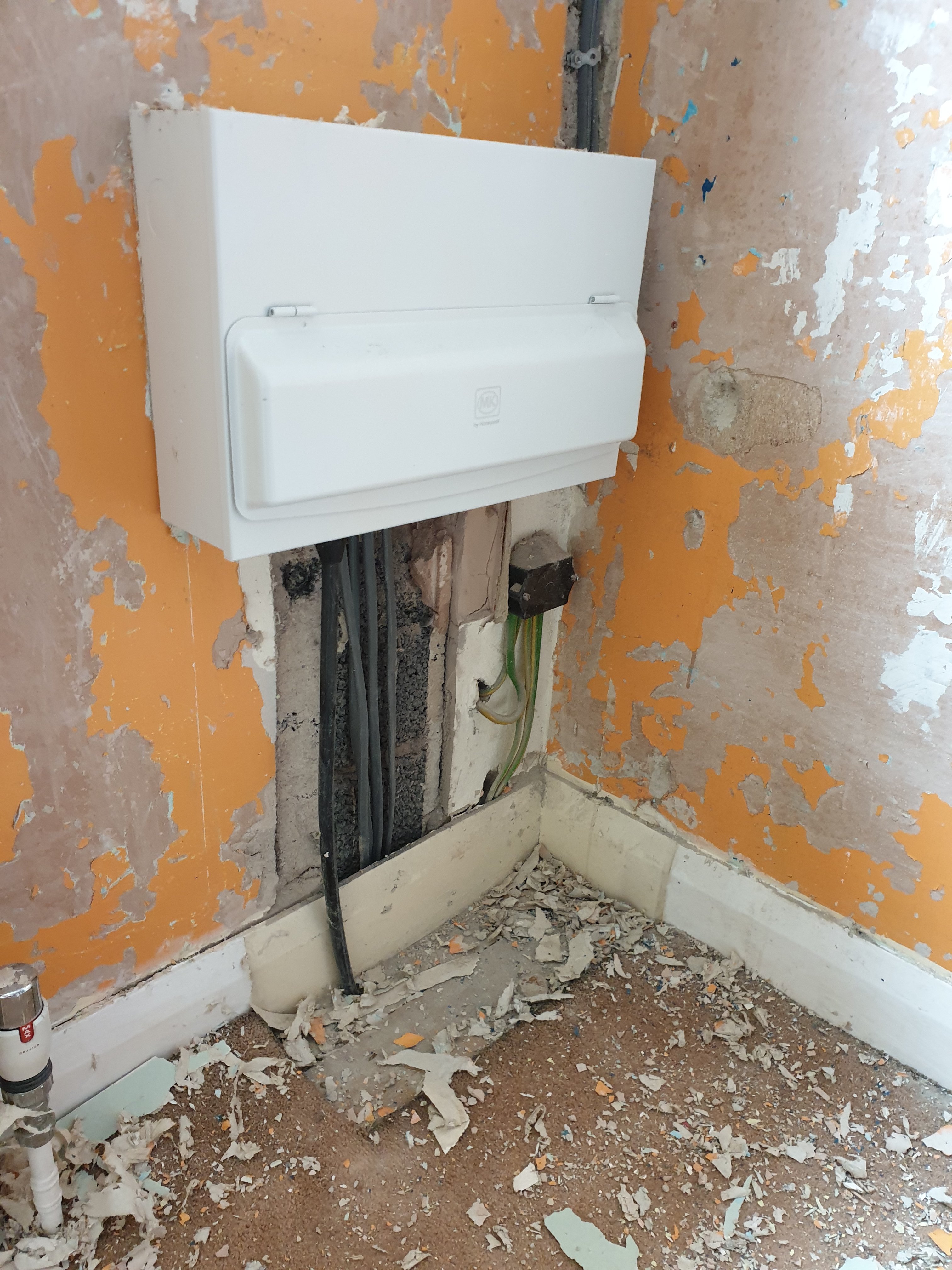

4. An armoured cable they put in to light the garage is coming out of the consumer unit and through the floorboards in the bedroom in front of (rather than behind) the skirting board.

armoured cable in front of skirting board
wire disconnected
A couple of examples of cutting around sockets.
Melted plug socket

As others have said not tidy but not as bad as it could be and in the sparks defence the loose wire could’ve been caused by anyone moving that socket front.....did you agree to him second fixing before the spreads had been in?

the holes might not be the tidiest but in fairness some walls when you chase them out crumble and lumps come out. the chasing doesn't look that bad to be fair from what I can see on the cable runs.
what was specified or agreed with how the armoured cable will be installed as from what i see the reason its in front the skirting board is because it comes out directly above from the consumer unit. even if behind it will still need to come out the wall a few inches below the bottom.
That wire that has come out could well be live !!
