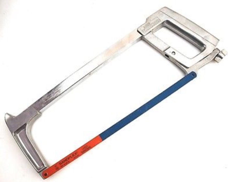

Had to fix a trailing swa,with 2g socket on the end of it.
Maintenance sparky checked it,peculiar voltage,40v.
I checked it with my volt meter ,sure enough 40v.
Plug my plug tester in,dead.
Checked the zs & v on my test kit,dead.
Checked with mains continuity tester dead.
Cut it with hacksaw,bang.
Radial serving a number of sockets,no Rcd,16 amp mcb,1.5mm 3 core.
Thinking,the sheath of the live not contacting terminal on socket.
Never take anything for granted.

I think the learning point is to first identify the circuit and its point of isolation and then isolate it before doing proving dead tests.
I would want to know why various tests did not prove live.
Edit: you had to fix it, what was the reported problem in the first place?

Was asked to fix swa & power point,the tests proved it was dead.
Given the information I had,I did all tests.
Lesson learned,ie:ID first,isolate,then proceed.

Some maintenance guy..... doesn't even think of isolation for starters.... that's before your embarrassment.
Yea,another for the book of life.
I hope you had a spare blade in the van for your hacksaw!
  • Funny
Reactions: DPG
Yep, would have been straight forward to find the breaker first as you will have to find it eventually anyway to turn it back on. Would have solved your 40V as well
