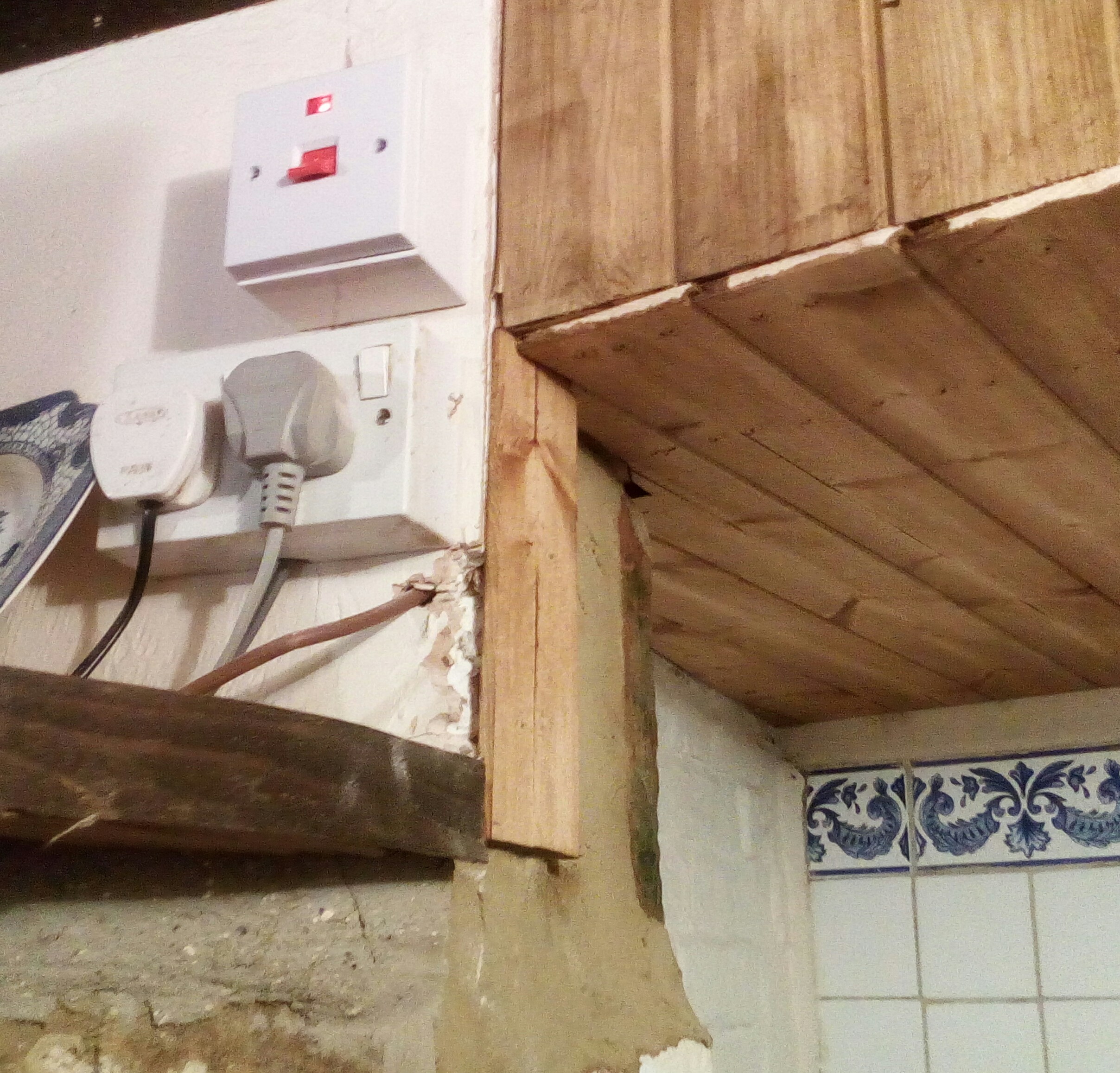

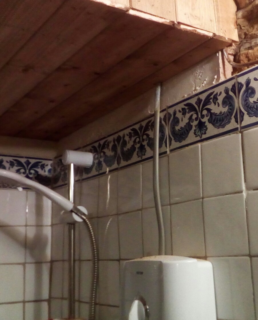

Hi everyone, I am not an electrician myself but I am after some advice regarding an installation that was recently carried out at my elderly mothers house.
She has recently had a shower installed where there was one many years ago, the pipe work was still usable but no one could find where the old (dead) wiring ran to.
The installer has run a new cable on the surface to the new shower unit and has manually cut the casing to allow entry into the top, the job is far from neat!
My other concerns are about the close proximity of the shower and some existing electrics that were installed in the time after this area was last used as a shower (it has been a cupboard for 12 years).
I would like to hear other peoples opinions on all of this while I decide what should be done about it all.

Did an electrician do this?
Was your mother given an 'electrical installation certificate' for the work?
What did the quote say?
Quite frankly cutting a hole in the top of what is a waterproof casing is beyond stupid!
As for the other electrical items, they are within arms reach from with the 'shower cubicle'. If my interpretation of the regulations is correct that's considered as Zone 2 and they shouldn't be there.
Whoever did this is a complete chancer and before it is used for it's intended purpose, it should be reworked by someone who actually knows what they are doing and who understands the basics of fluid dynamics.

I am lead to believe that the guy is a qualified electrician but I doubt there is any paperwork relating to the install!
The problem is, my mother is suffering from dementia (undiagnosed as yet) and instructs people to do work without any one else knowing, then gets very upset when the reason or quality of the work is questioned. She also has very little knowledge of legal or safety requirements.
At least I now have some professional opinions to back up my own opinion.

Hmmm...not pretty at all. Oddly, though, I recently fitted a replacement electric shower and although it's really just a newer version of the existing one, it did offer the possibility of top-entry for the cable, via a pre-formed slot-in plastic cutout, with a knockout bit shaped for the cable. I didn't use it, nor would I have as the existing cable is rear-entry, but it got me wondering about the safety aspects. The new unit is much flimsier and the separation between inner and outer casings is less pronounced...I like a nice channel, 2 steps and a good gasket (oo, err, missus...)
However, looking at the unit I removed, the top was quite dusty which says two things:
1. Not been cleaned properly!
2. Never got wet
Paying more attention I noticed that in use the shower spray and reflected spray from my body never threatened to swamp the unit itself, which remained dry except for the front control.
The instructions also stated you should not silicone the unit to the wall, which might be tempting to prevent water ingress, but the cable goes in horizontally to the casing then turns upwards to the connector block which is shielded so I guess that's good enough.
I won't bore you with my tale of phoning the manufacturer's "Helpline" which was tedious in the extreme, got me nowhere at all, and required me to take 2 extra pills that day...

Wants disconnecting before it kills someone imo
