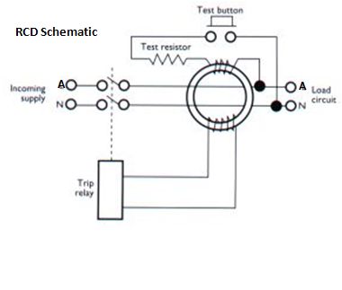

right I have been pondering this one and come up with the conclusion we are both right:stooge_curly: , if you look at RCD's they will be in series when in circuit runs through the rcd mcb through the load in series , correct , im happy with that , how ever close the contacts of the switch and mcb's the coils will then be in parallel ,and this is the reason i look at RCD's as being in parallel so the conclusion is rcd's are in the series parallel formation :stooge_curly:rcdschematic.jpg

It's in series. Numpty. From CU in house to socket in garden to a 13amp plug to shed then into shed CU and RCD and three MCBs. In my book Series. Can't be in parallel as the second circuit would start before first RCD ! Can't remove first RCD because it is protection for outside socket. But to be correct the shed should have had its own supply. But I knew this. So to be safe with the extenson feeding shed CU I wanted to check if there was a problem regarding Ze. So I received abuse from some NHs and some useful information from others. Also quite a bit of disagreement amongst your selves. ?.SELV ?
