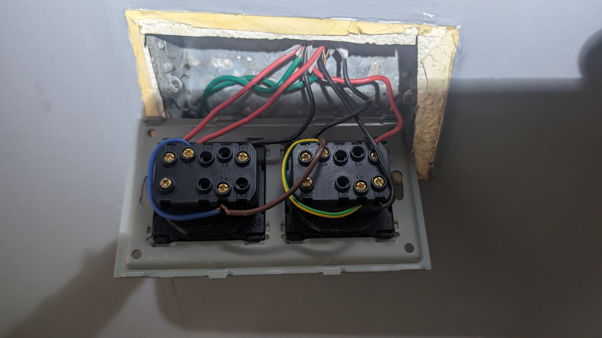

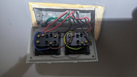

As you can see what I have is a right mess, IAM wanting to put a new switch on , but every thing I try either leaves one or two light not working.
Any help would be appreciated

It's good you took a photo at the beginning. Can you still identify the wires in relation to that though?
You will want to do this on the new switch:
The one wire that is live all the time connects to those. (It was originally in La )
The other wires go to lights and they should go to L1 on each switch.
The exception is the right most switch which is setup for 2 way switching and should have the two wires that were in Lc1 and LC2 connected to L1 and L2.
All the wires should be red or brown, or sleeved red or brown.
Blue and Yellow/Green should certainly not be used for link wires.
Label each cable carefully before removing the existing switch.
Get rid of the incorrectly coloured link wires, green/yellow must never be used for anything other than earth. Use 1.0mm or 1.5mm CSA brown cable to link the commons of the new switches.
Connect an earth from the earth terminal in the back box to the earth terminal on the new switch.
Mark all of the existing black wires with either red sleeving or a wrap of red insulation tape to identify them as live conductors.
