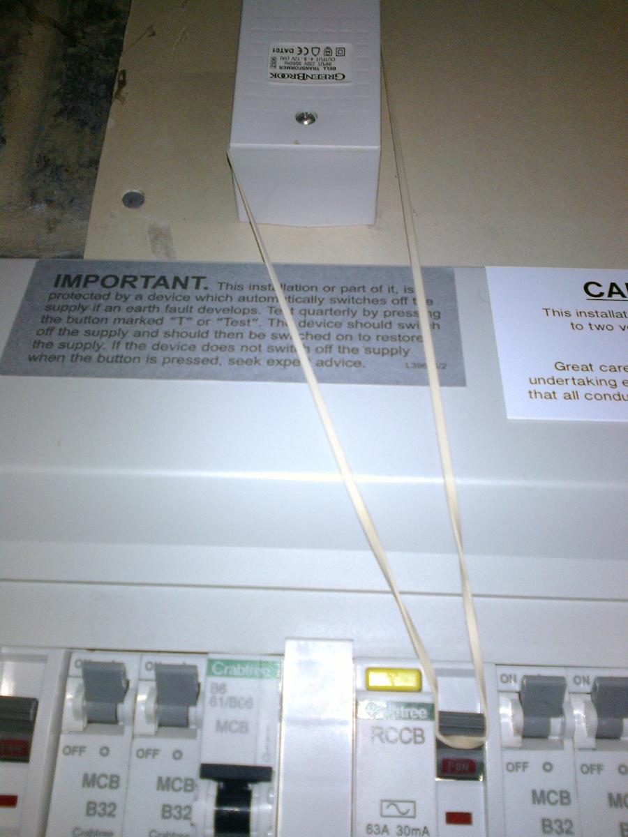

It has got me thinking and cannot work on it further until landlord gives permission. Thought it might give a few of you a puzzle to think about on your sunny Sunday afternoon. I am puzzled as to why the RCD has not tripped because outwardly it looks like a Neutral Earth fault, but I have not checked yet to find out more specifically where the the problem is. The lighting and smokes are not on the RCD. Also as someone, has mentioned here already, the occasional RCD trip could be unrelated to this high residual current. Hopefully I'll get the job and will be able to satisfy my curiosity.
The current in the earthing cable might be 'interesting', but to measure the leakage current you really need to be clamping around both the tails (and not the earthing conductor) as Marvo alludes to in post 6.
The 'occasional trip' and the 2.5A leakage current don't really go well together. 'Won't reset' would be better.
Measuring the leakage down the CPC or main earth doesn't show you what's being lost down parallel paths so it's not the most accurate way of testing..
Ah yes, the current in Earthing Conductor is just part of the story. In this case it is in a block of flats so the services main bonding paths in the flat could be nicely carrying a proportion of any earth leakage current. The RCD "occasional" trip could be something else and may not even happen again. The tenant's brand new very basic cooker IR is OK, the install of this was the reason for being there in the first place.
hot?...or just measured cold?
As others have already said, clamp the tails to see the true leakage of the install, you always have a good few 100 mA or so of circulating earth currents sloshing about the system on a TNC-S earthing conductor from the supply side. This is external to your installation.
I live in a flat (TN-C-S), just measured with an EL clamp meter, on the main earth it shows 247ma... and clamped on both tails shows 2.93ma. i imagine the leakage is coming from the computer. Interesting as this thread has just answered my question aswell.:)
Cold. Good point about it being hot because the customer stated it tripped after it had been used for a while.
well.....there you goes then..
always listen to the operator...as they are at point of use and are a mine of info..before you go in there...
get it warmed up...IR....see what you get....try all rings as well....the lot...
Valid point, what was I thinking eh! Obviously an earth fault as it's the rcd that's tripping.
- - - Updated - - -
Who knows, I'd rather not try! I'm sure someone has though.
on an MCB or an RCD the tripping mechanism `rides over` the button/lever...so that theres no possibility that the unskilled/uninstructed can `jam` it shut....
Oh God this is getting a little Embarrassing now, surely UK sparks knew that and was just pulling your leg, dear God surely.
Thats what you get for buying a cheap one. The ones withet better psu dont leak as much
