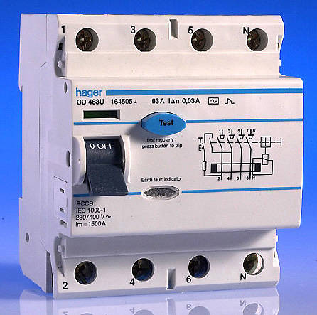

Hager make them as well (Image courtesy of TLC Direct)
That Hager unit your showing is a straight 4 pole RCD ''NOT'' a 4 pole RCBO!! lol!!
Reactions: 2 people
Oops, posted the wrong picture...thanks for the spot!! :grinningelf:
Strangely on the Hager site they state they are RCBO's but only seem to have images of RCD's?? Could this be a case of "Lost in Translation"
