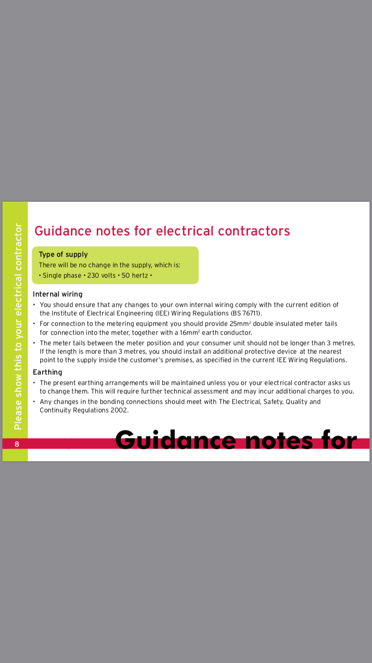

Installing a 25mm 3core swa to feed an exisitng consumer unit due to the SEB moving the supply.
Planning to use a 100A 100mA time delayed rcd to feed the split load rcd board.
Sound ok?

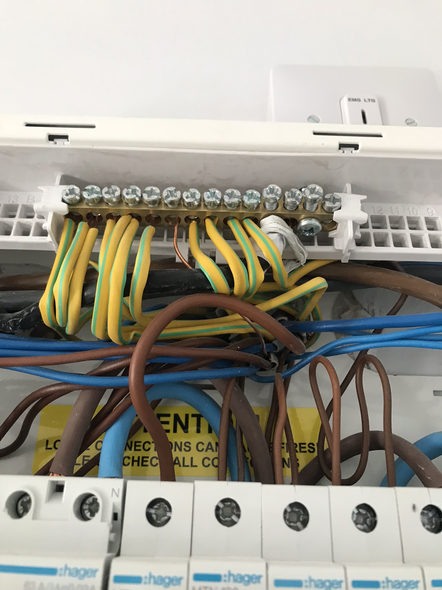

Will the dual rcd board accommodate a 25mm into the earth bar?
Will there be a switch fuse isolator fitted If the supply is over 3 meters from the cut out?
Why would it need that? Nothing in BS7671 about it, and the DNO may not specify it.
433.3.1 item (iii)
A device for Overload protection need not be provided at the origin of an installation where the distributor provided an overload device and agrees it affords overload protection to the part of the installation between the origin and main distribution point where further overload protection is provided.
The general consensus is that the DNO will allow 3 meters and no more for their cut out fuse to protect the tails.
Also 434.3
Reactions: DPG
433.3.1 item (iii)
So as I say its speculation if its needed, nothing to say in this instance that the DNO require it fitting.
My understanding is that the DNO will not generally allow their fuse to be used to protect any part of a consumer’s installation.
The 3m stipulation relates to the BS7671 requirement that overload protection must be provided within 3m of a reduction in the CCC of a conductor.
This is northern powers requirements anyway
PME
Yes dual board will take a 25mm
SWA will be made off into a metal enclosure with the 100a 100ma time delayed rcd. This will be mounted next to the main supply, so tails less than 3m
Tho that is a regulation in the context you describe that has Nothing to do with the DNO tails
Read 433.3.1 and 434.3 or not

Out of interest ive never had to terminate a 25mm cpc into a cu, do you just fork it into two earth bar holes?
Not many CUs have an earth terminal to enable termination of a 25mm conductor.
Where can I find this 3m rule in BS7671?
