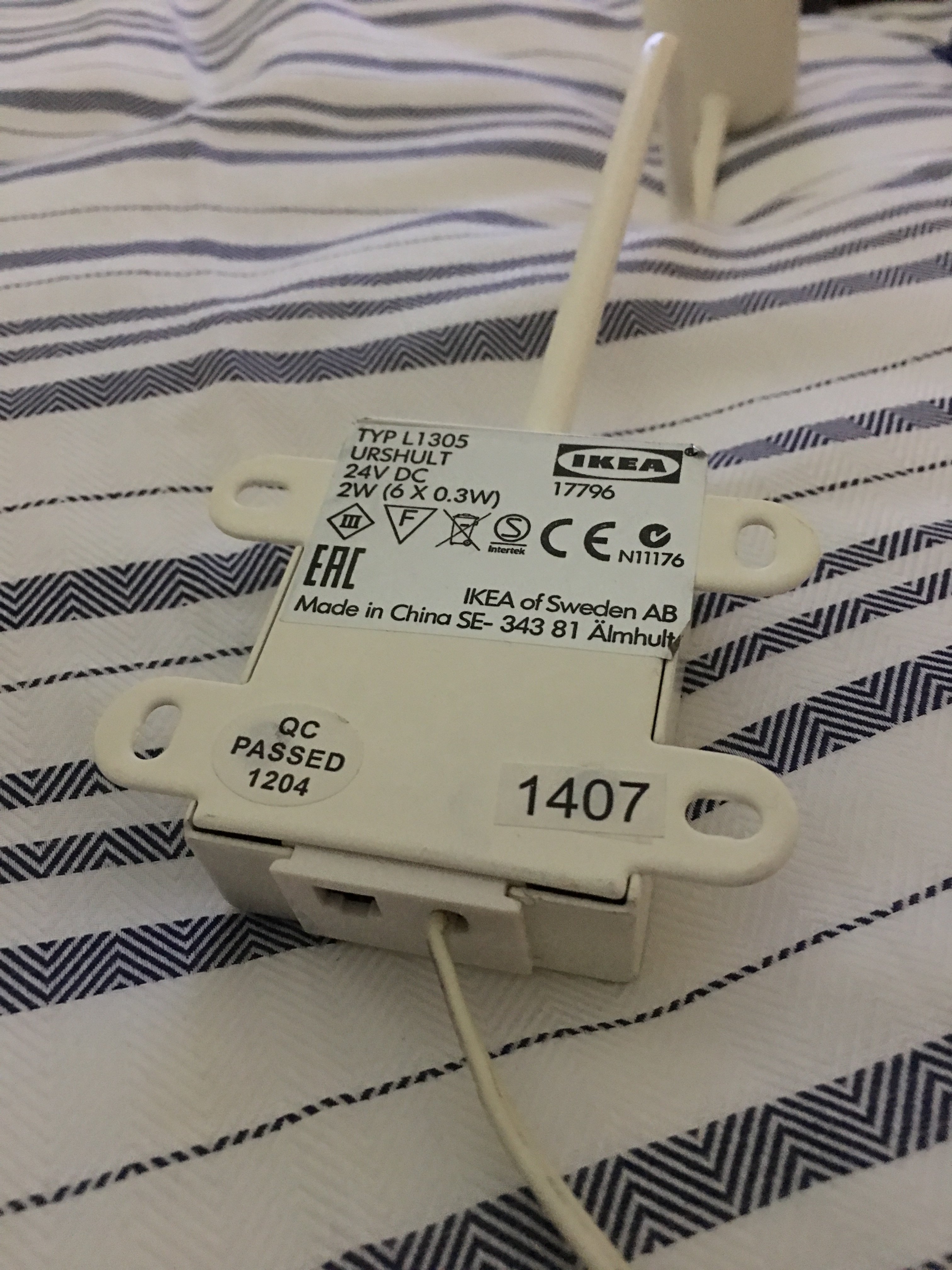

I managed to get the attached downlight cheap from IKEA. I didn't realise the led transformer and leads were so expensive as I only need one of these lights.
I've taken a picture of the label showing the specs. Is there a simple LED driver I can safely connect this to which then allows me to plug it directly into the mains?

Hi guys! I tried that one from Screwfix however it doesn't work. I'm guessing as it's a 12v and the label on the light says 24v. Should any 24v LED transformer work? Amazon have loads!

It looks like you need a constant voltage 24V LED driver that can operate at 2W.
Some drivers cannot operate at low wattage (most can) so look for the minimum wattage specification. This or this one appears to meet the specification but I have no knowledge of the supplier or quality of the parts.
