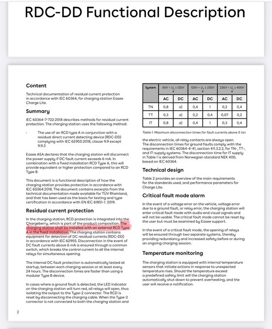

The OP has stated the charging point includes a B type RCD so any upstream RCD device must also be B type to function correctly and therefore comply.
Possibly my post #13 which quotes Easee's documentation on Residual Current protection, dated Dec 2024. The discussion subsequently turned to whether an RCD would be required at all at source.
If the charger already embodies an RDC-DD, why would a type B RCD also be required at the source of supply?

Having established that a (double pole) Type A RCD or RCBO seems to be needed, I just wondered why Type B was mentioned - that's all I meant!

The OP stated that the EVCP has a type B RCD in it, so we must assume that type B protection is required.
The OP thought it had a type B RCD in it.
It transpires it's an RDC-DD.
According to the manufacturer it requires Type A protection in the supply.

My understanding (and this might be wrong!) is that you could use a Fusebox single module width 'miniature' double pole Type A RCBO at the CU
That's assuming you are not faced with contradictory instructions accompanying the charger!

Many thanks to all those who took the time to reply. You always learn something. I have learnt that I need to look into the RCD BS conformities with regards the internal RCD's of EVCP's the next time I fit one.
