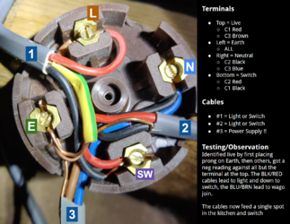

Excuse the rubbish edited version below, which is my best guess at what you have.
Using the modified labelling(!) below - I'm thinking cable 3 is the supply from the lighting circuit (eg CU or another room), and cable 4 continues the supply to the next room/ item on the circuit. (or vice versa)
You could (carefully!) check with your meter that between the SW terminal and N is 240V with the relevant light switch on, and 0V with it off (though with your high impedance meter it may show some random ghost voltage rather than 0V) and that there is 240V permanently between L and N, irrespective of any or all light switch positions.
If the above test holds true then to feed your new light with a permanent supply: L, N and E as marked up below.
If the L to N voltage goes to zero when a light switch is tuned off - see edit below

If we've got the assumption correct, the supply terminals you need for your new light scheme are those marked N, L, and E in your diagram đź‘Ť
The cable list at the bottom of the drawing would be:
#1 light switch
#2 incoming power
#3 to light (a)
#4 to light (b)
If you can confirm the above seems where the wires go, there is a good chance your illustration is correct.
Your multimeter (carefully) connected across your labelled L & N should still show about 240V when all light switches are off!

It seems cable 3 is the permanent supply you need. You mention cable 3 comes from a Wago joint - could you put a Wago box or junction box there to take a feed from, or alternatively take a T&E to feed your new circuit out of the box you show here.
Note the long stripped bare copper on the black hanging out of the SW terminal - looks like it's falling out. I would try re-making that terminal (power off of course!) The idea is not to have any bare copper on display, so insulation should run up close to the terminals, and the E wires should have sleeving. Similarly cable 3 has some single insulated cable outside the junction box, which is poor practice. Appreciate this is not your fault, and you may know all this, but I just thought it worth pointing out if not!
You could normally accommodate a Wago for N's in the back of a deepish box, but with your 4 gang switch it might be tight? Can you not distribute the neutral to the lights above the ceiling (as per your very first diagram) - why take it to the switch box?

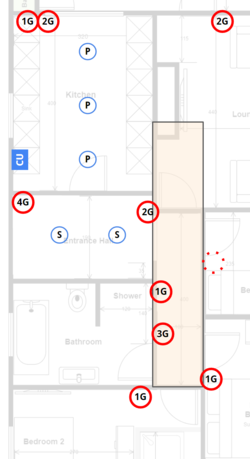

Here's the layout again of the bungalow.
As you can see the CU is very close to the 4G switch. It will be a more messy job, but once all the powers off in the CU I know I'm connecting to either 16 or 6, probably 6. I would double up in the top with the live wire, and then would I have to connect to the same neutral and earth bars 'number' as the existing cable in the RCB or just ensure I use the same for the new wires? I know that I would have to use the same bar that corresponds to the same section of RCBs.
Diagram below: The faded cream area in the middle represents the boradrd crawl way in the attic. It's spider man after that to get to the lights and down holes for the cables I've used so far. There are spots on that side of the house too, there's a pendant in the master bedroom but thats a long way from where I'm working. Closest are the spots, I guess if I were to go there looking for my L/N then there would have to be something feeding these spots. But thats all under boards... and difficult to get to. I'm liking the CU more now as an option. BUT it would be good to understand exactly what was going on with the JB.

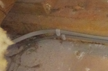

I've got what looks like 2.5 and 1.5mm cables running around the edge of the attic. Would it be safe to assume before I cut into the lower one is lighting loop and the top one is for a mains loop? Bungalow was built in the eighties...

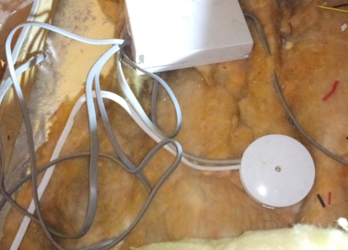

And then I have this set up, not my work, close by... the white round thing looks like a junction box. And the white cable goes off to what I think is the conservatory lights.
Don't cut into anything before understanding EXACTLY what it is. Preferably don't cut into anything full stop!
