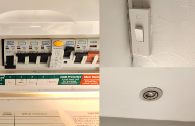

It can't be a 32amp supply. The light over the sink goes off when I turn off the 6amp RCB (see pics below). So it must be a 6amp junction box. Which means that there is something else causing the intermittent behaviour I experienced when trying the kitchen lights. This can only be wiring related, either at the junction box or the light switch.
Picture #1 = 6 amp fuse in OFF position
Picture #1 = Light switch in ON position
Picture #3 = Single spot not ON

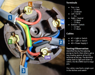

I'm going to test tomorrow at the junction box pictured below using my multireader, with the power on/off at this 6 amp fuse. I'll test against E/L N/L. I guess theres another test with the 32amp on/off too just to completely discount it.
If testing is positive for 6amp I'lll move on to the wiring at the junction box, then if still experiencing issues will rewire the 3 way lighting as to a different format AC Power showed me on DIY Forums.
If this doesn't solve it then either get the pro's in or go at the CU.
Seems like a logical approach... let me know if you think otherwise.
