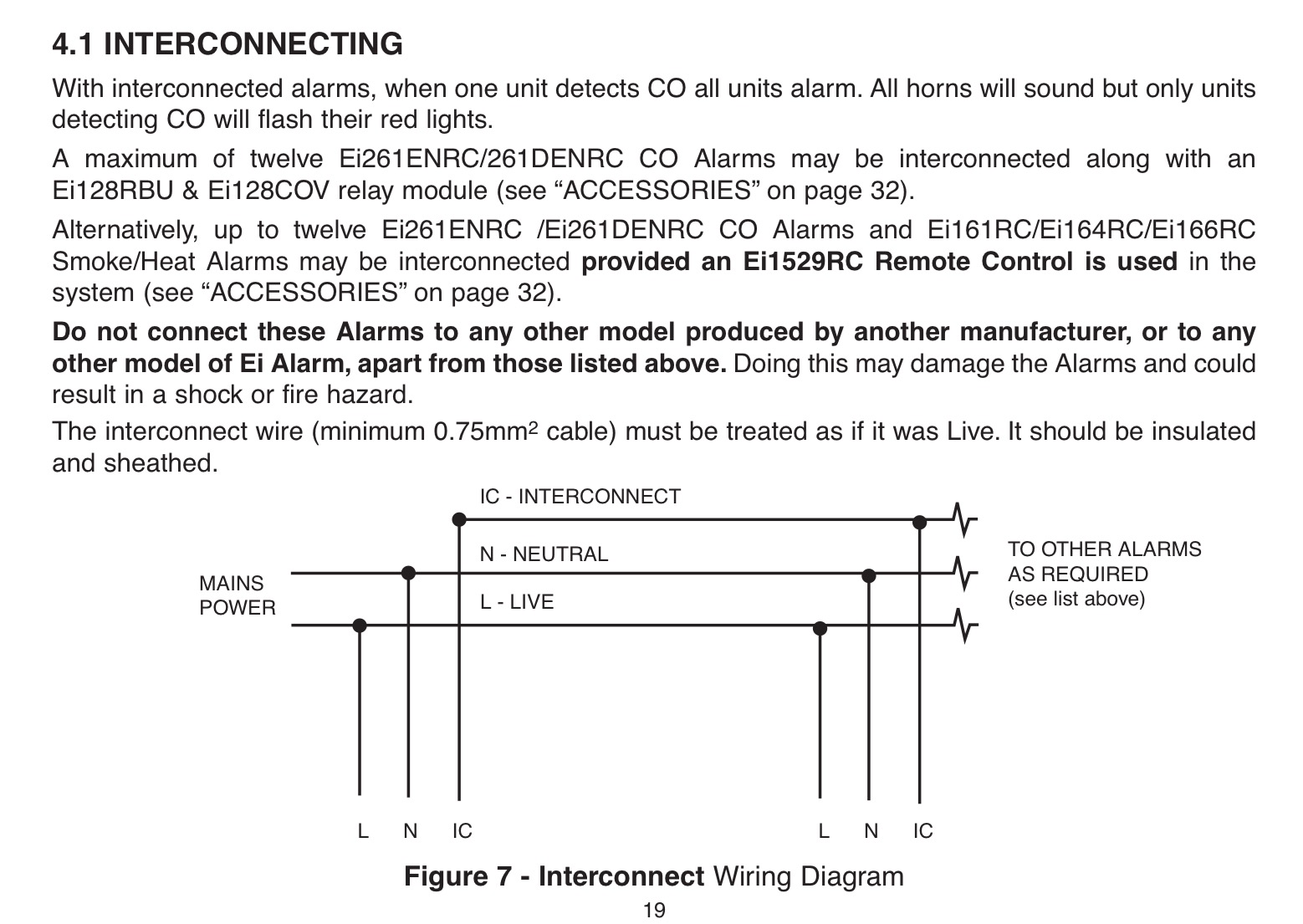

I have been reading up on the install instructions and it does say that they must not be interlinked with smoke detectors as you cannot tell what has activated them. Whether it's a co leak or a fire.
Only thought is that the co detector is in the kitchen where the boiler is but it's the furtherst away from the bedroom. I can see why the instructions state not to connect them but it would be good to connect them so they all sound in an emergency and can be heard in the bedroom.
Thoughts please not going to interconnect them but don't like the fact that the co alarm is the furthest away from the bedroom and you might not hear it if your asleep. Or am I over thinking things
I would consult the techies at Aico UK.......they are the best people to give you advice
I'd Recommend Aico's Radio Links. Then you don't need to wire around the whole flat, just take a feed to each device from a local circuit.
Not cheap (£60 ish) but slot into the acio alarms. the labour wise save so much time. 2 smokes and a heat can be installed in a hour
