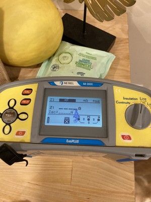

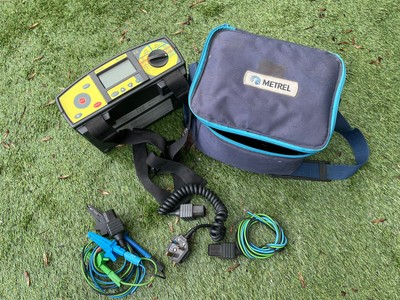

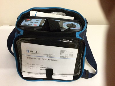

Hi,
I've decided a decent test meter would be useful for me but given that I wouldn't be using it more than a couple of times a year I don't really want to buy a new one for £400+, so had a look on ebay and there's quite a few for around £100 which seems much more sensible for the amount of use I'll need. I have a few in mind which I'll post in the links below, if anyone would be kind enough to have a look at them and give me some advice it would be greatly appreciated!
Those are all metrel ones, if they don't look decent I'm happy to wait until something better comes up.
Also none of them have an up to date calibration certificate so that would mean I'd need to get it calibrated, what sort of cost would I be looking at? I'm based in Newcastle-upon-Tyne so if anyone knows good calibration companies around here that would would be great!
I should point out I'm only planning on using it in my own home, and just want to be able to test any work I do (all fairly minor stuff that wouldn't require notification or anything). Also I'm just interested and want to learn about proper testing. (Can you tell I'm bored in lockdown lol).
Thanks for any replies!

You see calibration offered on eBay for £25-30 but the professional offers I have seen are in the £65 region.
That Metrel Mi3000 is great piece of equipment but yellow ones were the oldest, try look for blue ones they were much newer version and grey are the latest.
Calibration as above expect around £50-£60 incl postage.
Now in terms of paying by paypal or credit card its not as easy as Mike said. Most ebay sellers take paypal payments only and wont take direct payment from your credit card. You can use credit card through paypal but then path is broken and Section 75 wont apply as you used agent and did not pay directly to supplier so credit card company will reject your claim. Also worth to note that payment needs to be at least £100 to qualify.
Try to agree with the seller that tester will be subject to calibration and if it fail seller will give you full refund.

going back to the OP. the 3rd link looks a good buy from where i'm drinking sitting. be prepared to go up to £200.
Reactions: Steve T
