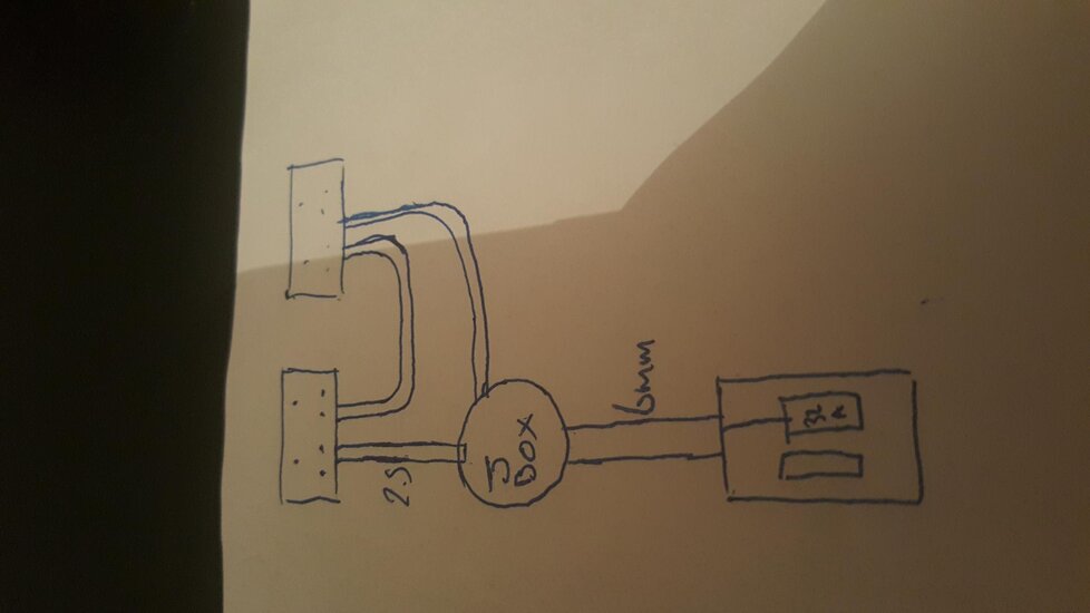

Hi everyone I've come across a weird situation where somebody has got new sockets added, but from the board it is a radial in 6mm as there is one set of cables into the breaker, then when you look at the sockets (2 double sockets) it's got 2, 2.5mm cables going into both like it's a ring
Does this seem acceptable
I have drawn what I think has happend and if anyone thinks it's acceptable
Commonly known as a lollipop circuit, its not a standard bs7671 paint by numbers circuut so you have to actually think about it a little when it comes to testing it
It's a lollypop circuit. Perfectly acceptable providing that all the usual requirements are met regarding overcurrent protection, RCD protection, Zs, ring continuity, etc, etc.

Ok thanks guys it's not acceptable with a 40 amp breaker tho isit because the ring should be be 32 amp max breaker shouldn't it
Lollipop circuit, don't like em, don't use em
it should be on a 32A MCB. soon chamge it. otherwise, as before. if readings are OK.....
But your drawing states 32 amperes.
