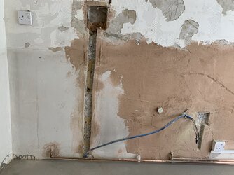

Kitchen design for this wall: partition 1 (60cms) free standing fridge, partition 2 (60cms) builtin oven under a normal worktop, partition 3 (60cms) hob, partition 4 (30cms) a unit, partition 5 (60cms) free standing washing machine.
Fridge socket over on left — no changes here.
Chasing in the wall leading to the box: this has been deepened and widened based on 2nd electrician’s instruction. Prior, it was half as wide and less deep. 2ndEl plans to house to cables in the widened channel.
The blue cable fed the power switch of the oven in the old kitchen.
Nigel had decided to have no use for this channel and box — wanted them filled in. Instead, he extended the blue cable to the right and hung it on a clip. Nigel repurposed it to feed the hob directly without switches intervening. The length of the cable is too short to reach the hob but Nigel thought it’ll make it just.
The chasing for a box and a channel is new and was carried out as per 2ndEl instruction. Ignore that for now.

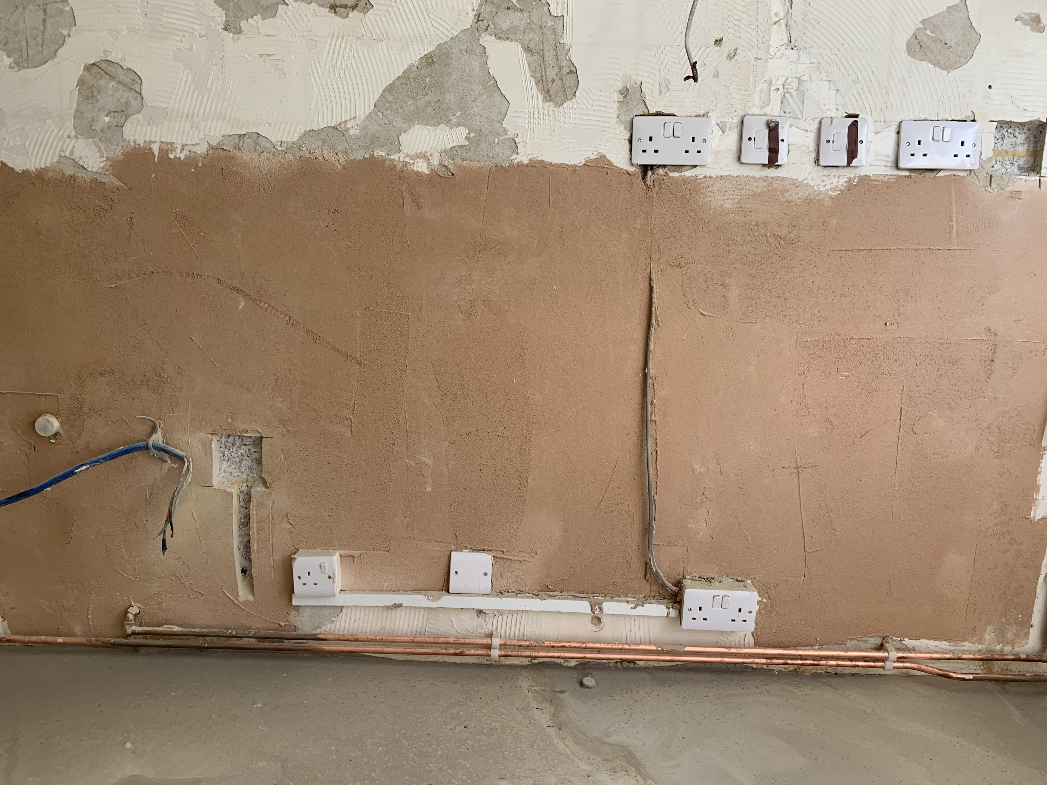

Nigel’s plan for the bottom row was:
Feed the oven from the first white socket. The double socket will feed the washing machine and have a spare socket. He blanked the middle socket.
At worktop level: Nigel installed a new socket through chasing a box in the wall and feeding it through the grey cable from the bottom row.
Along that same worktop row: he installed two spurs (one for the hood), and one for the under cabinet lights, followed by a spare double socket for general kitchen use.
Note everything at the worktop level is in this picture is new and is Nigel’s work.

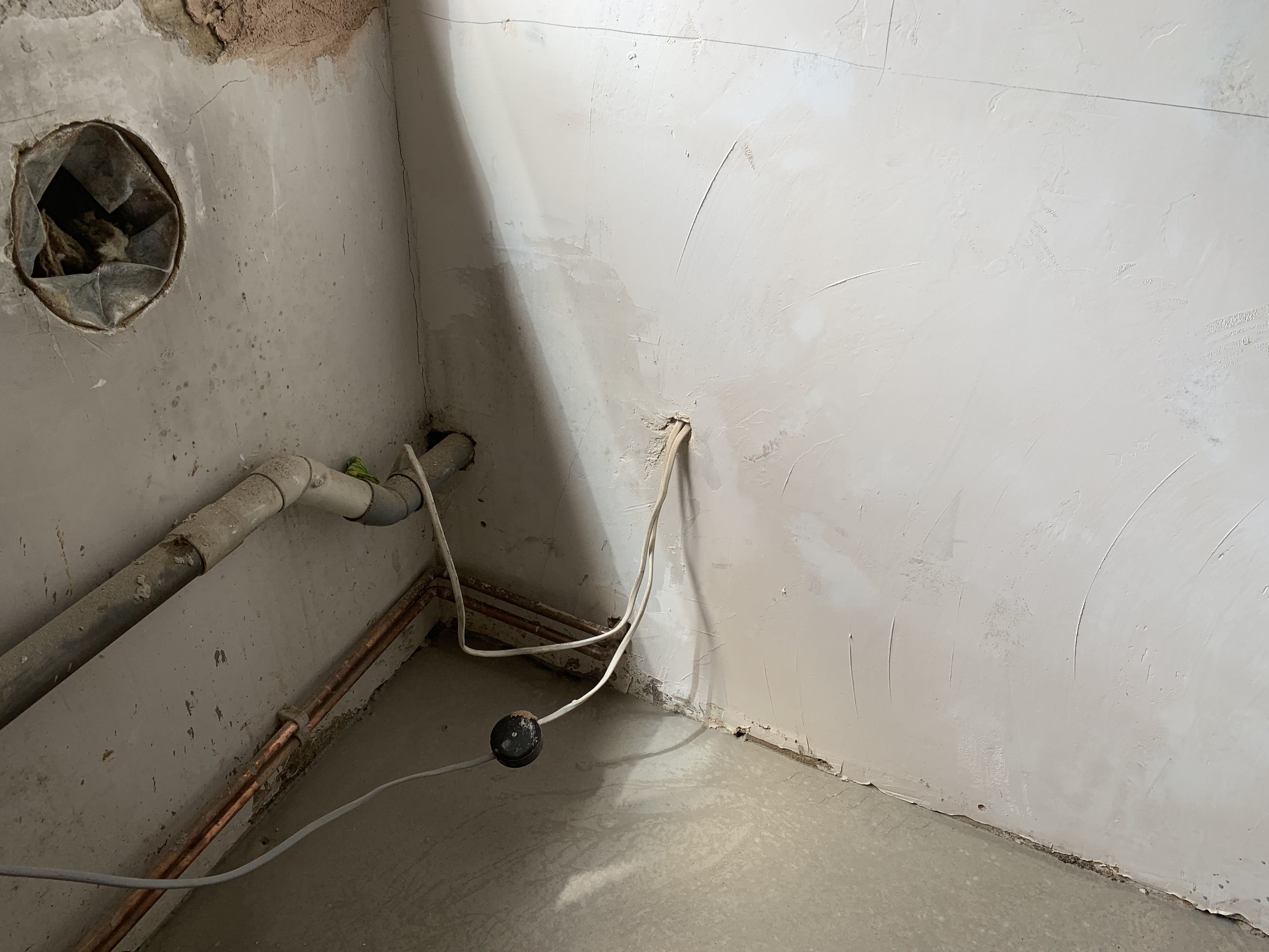

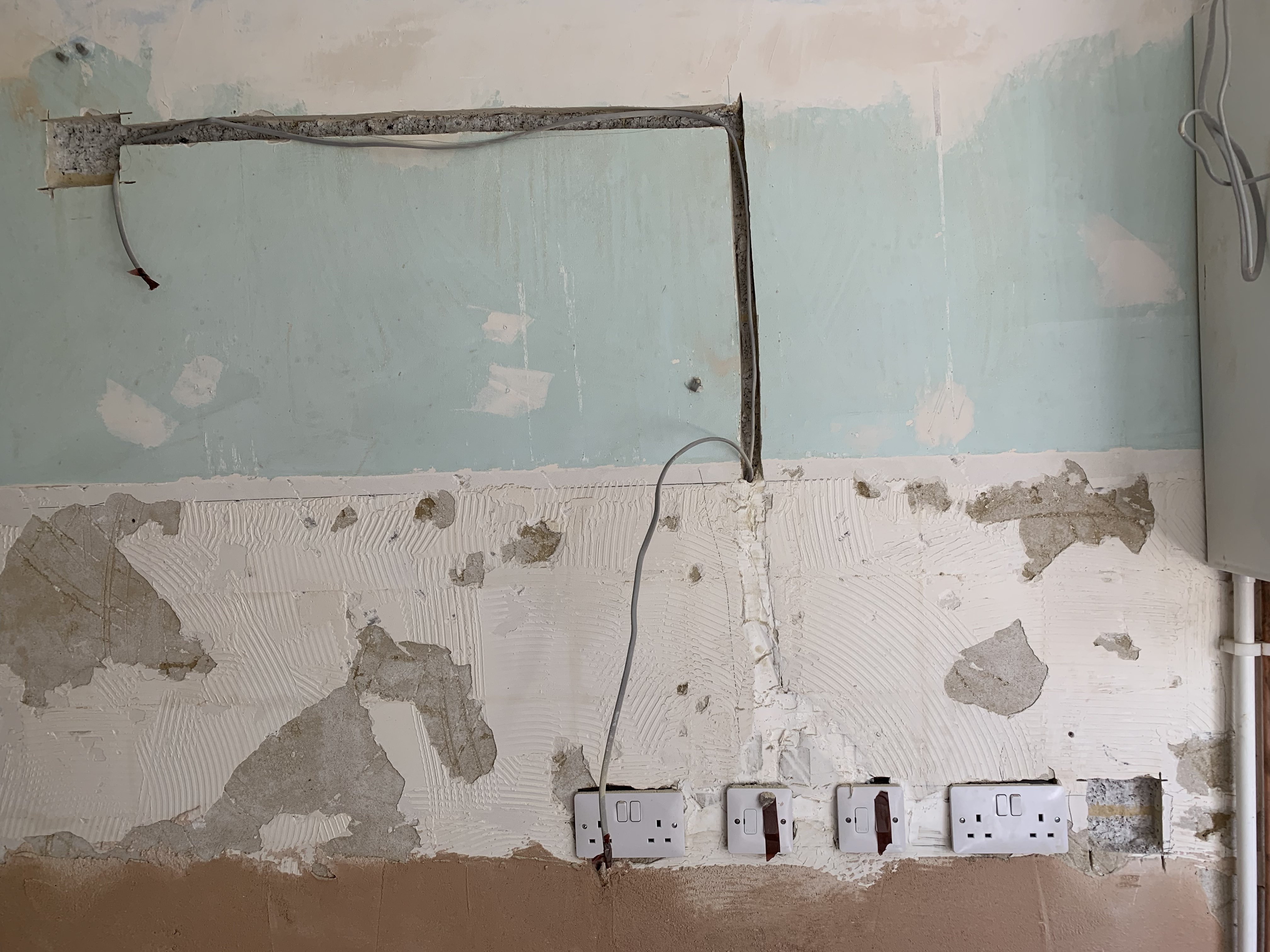

There was a fair amount of chasing here. Four boxes plus the white-covered vertical chasing.
The deep, rectangular chasing up top — that’s not Nigel’s work and is based on 2ndEl’s instruction.
The way Nigel left it was he left the two grey cables at the pencilled line. He hung one of them off a clip which is not far from the pencilled line, and the other he pulled diagonally and hung at the clips just above the newly-drilled box.

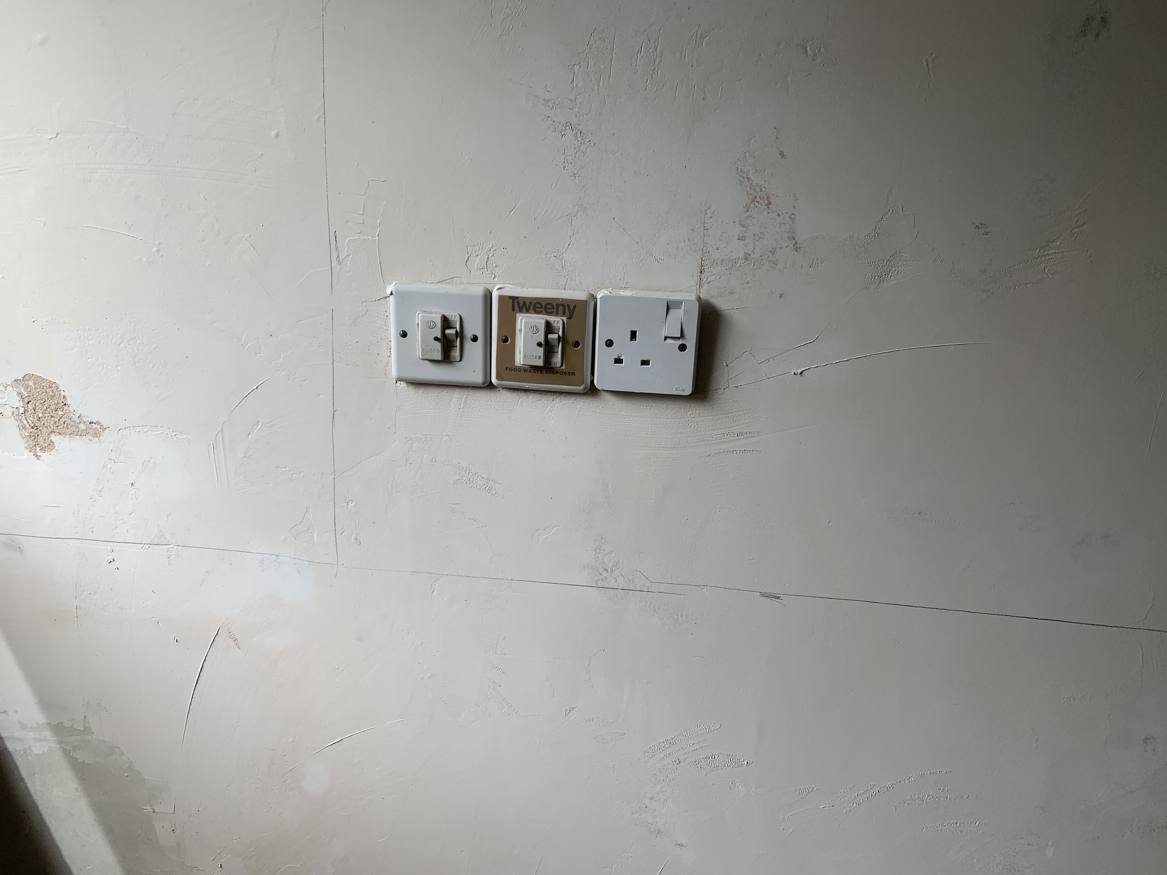

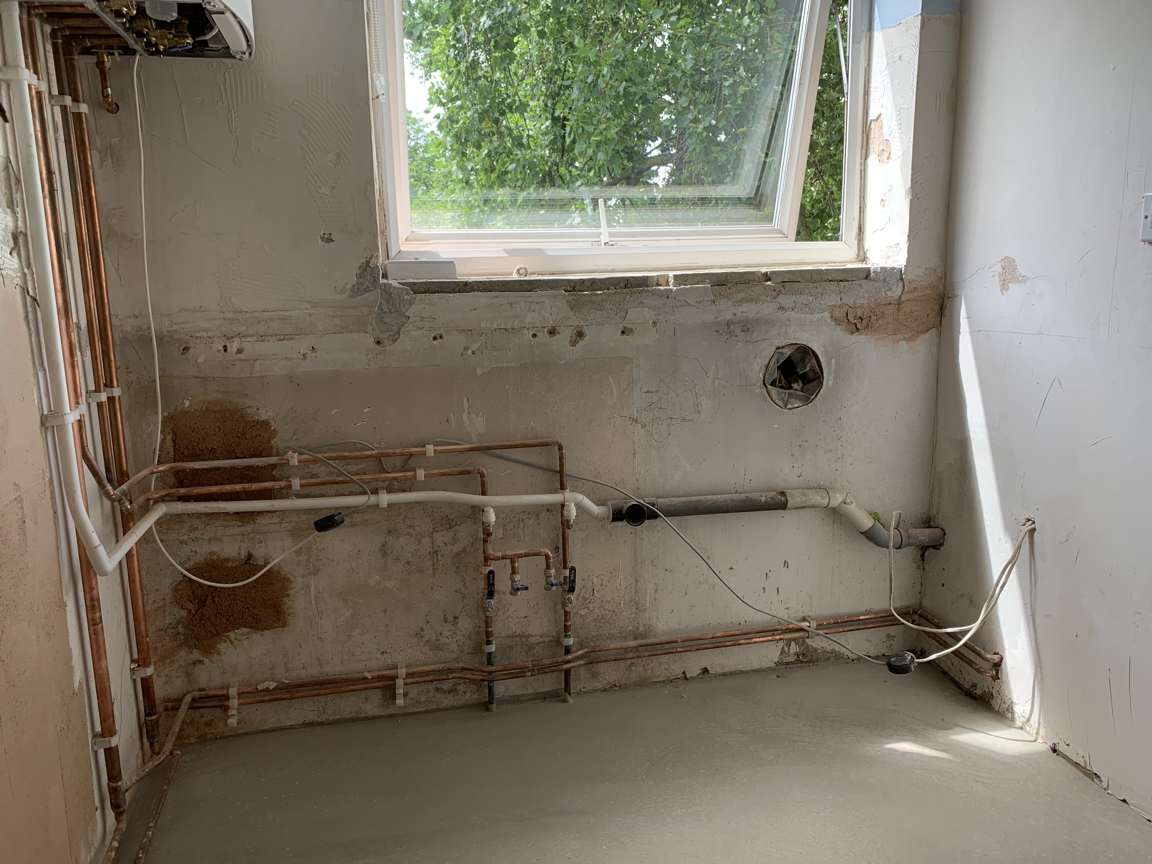

The boiler is fed via the cable on the opposite wall. You can see there are two joins there. This long cable was supposed to run under the kitchen sink unit.
The two cables coming out of the wall connect to the spurs shown in the second picture. One for the boiler, one for the dishwasher, which supposed to be in the corner.

Some of that looks very amateurish. To be fair though your opening post about the boiler cable said the problem was it being 1. 8m long. Then you said it had a joint in it. Now it's got 2 joints in it.
If it were me and this is just my personal view , I would re-wire the lot before even attempting to set the new kitchen units in.
For a good experienced sparks it a days work , day and half tops to fully re-wire that small kitchen space...
I’m not quite sure the blue cable is suitable to provide a supply for a cooker point.
The cable for the boiler supply needs replacing, to remove unnecessary joints, and fixed to the wall; the service void under the floor units could be used.
The cable from above the worktop to the sockets below, should either be flushed in or run on the surface; a combination of both is not very good workmanship.
I’ve used plastic trunking to run cables in the floor service void, but I would normally wait for the plaster finish to be completed.
All in all, it’s not a very professional finish, even at just the first fix stage. I wonder about the rest of the install, that this alteration is joining up to?
